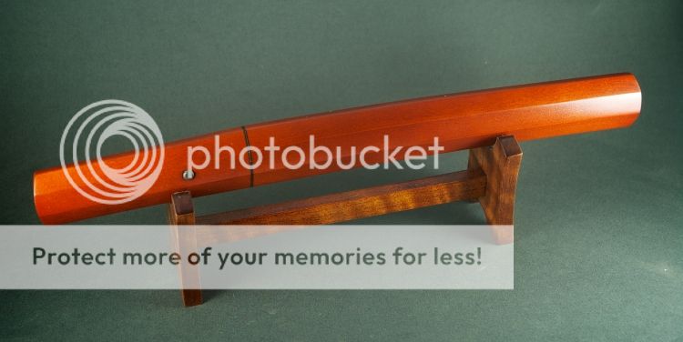

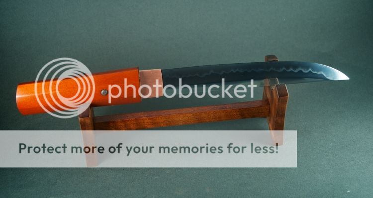

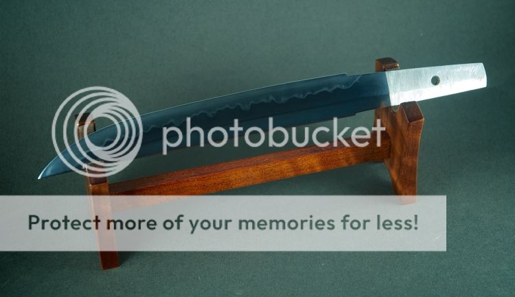

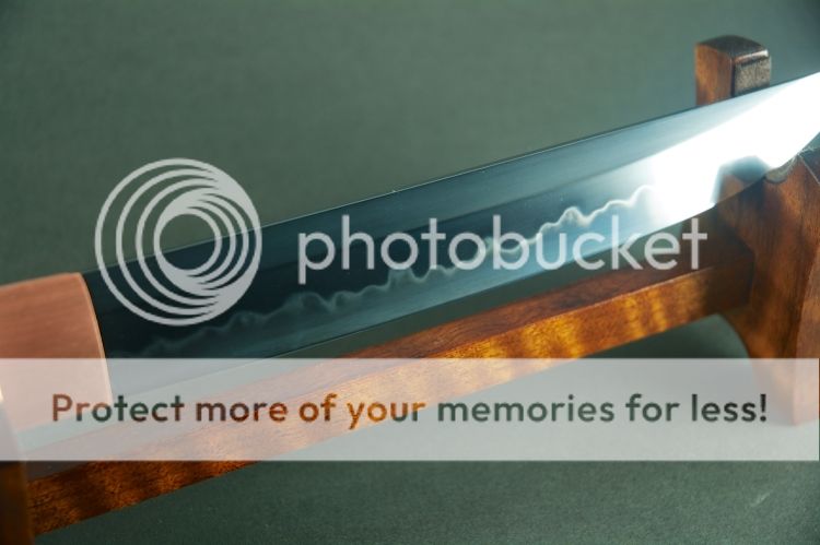

I recently finished this one. An unusual geometry for a tanto but I like how the shinogi and hamon divide the blade up into thirds.
The shinogi also gives the blade the appearance of being quite curved when in fact there is very little sori.

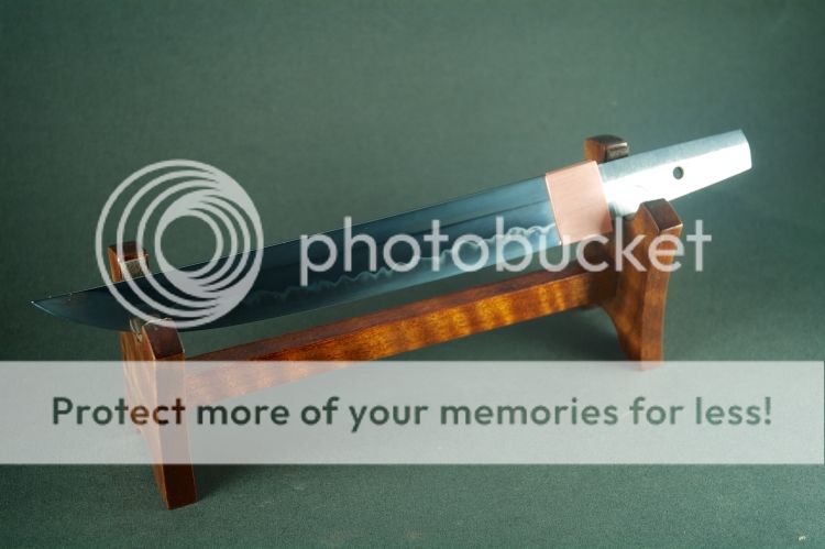

The blade is 7 3/8" long from the munemachi or 8 1/16" including the habaki.

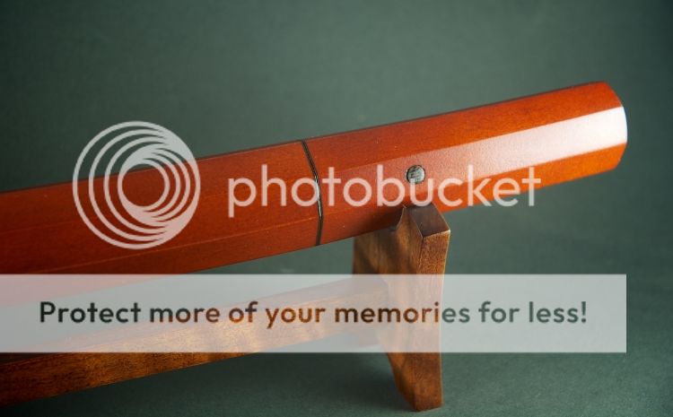

The saya is lacquer toned poplar done in the facetted style with wenge end pieces and a wenge mekugi pin.
I haven't tried the facetted style of saya and it was a challenge trying to keep all those lines flowing in the midst of tapers in width and thickness and the waisting of the handle.
The stand is walnut.
Thanks for looking!

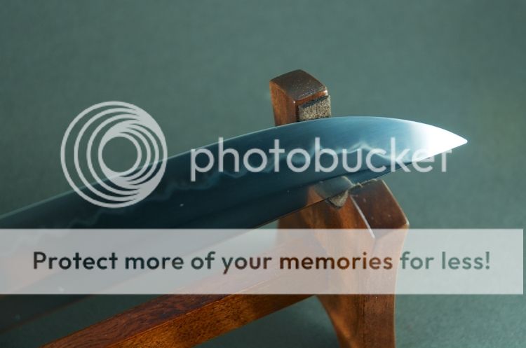

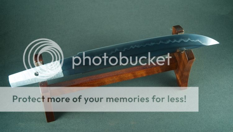

I love the fittings, and have to admit, the geometry on the blade is not "bad", but it is vastly different than what I am used to seeing, which as you know is, hira zukuri....and because of that, I salute the boldness of your choice.
Hamon is just about perfect, would have liked to have seen a bit more turn at the boshi.
Best Regards,
STeven Garsson
Thanks STeven. There is a turn at the boshi but it gets lost in the junction of the shinogi and the mune. I guess in some ways I erred on the side of caution as I have had too much of an uncontrolled turn back in the past and with this geometry, there is all the more possibility of "error". Hira zukuri is a little "easier" to get away with in this respect.
Yes the geometry is a departure from the norm but not unheard of. I wanted to explore the tapers of the ha/ji vs the shinogi ji on this one as there is so much subtlety to the sugata available when you add that ridge.

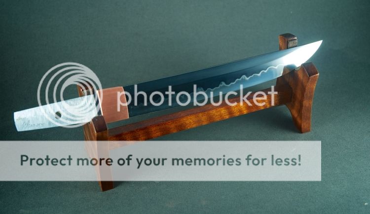

Very impressive Stuart! That is a KILLER hamon. Is that W2?
I couldn't tell you what's right, wrong or otherwise about the cultural aspects of it but your craftsmanship is superb.
Another beauty, Stuart. Wonderful hamon, I am assuming that is W2 (?). Oh, and I especially love the saya! You know I'm a big fan, and this only reinforces that.
Thanks so much for the comments. Yes it is W2, I forgot to mention that.
