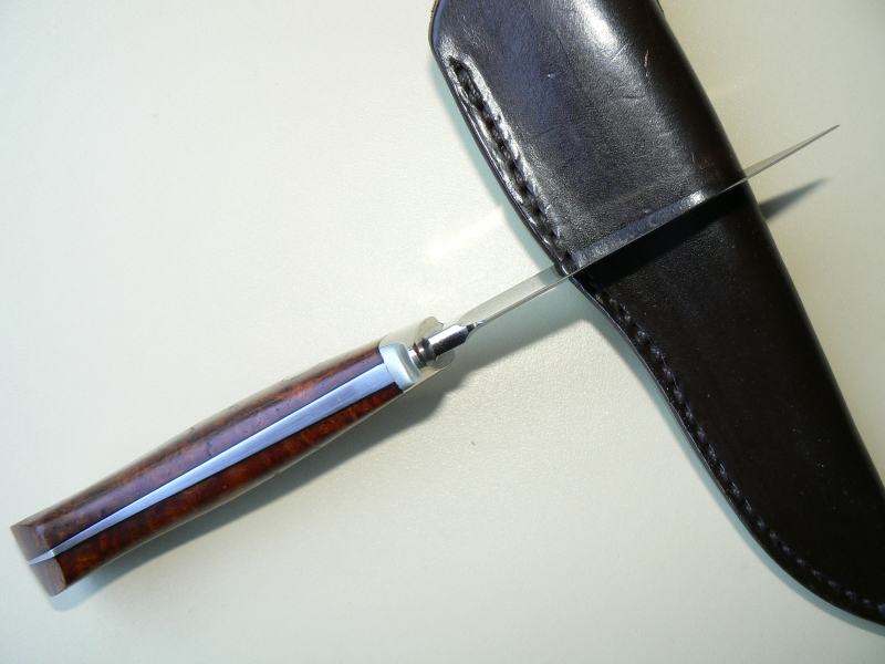

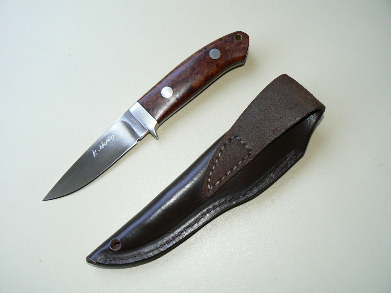

A bird & trout and a drop point hunter by Japanese knife-maker Koji Hara, and a Loveless by Dozier / Böker.
