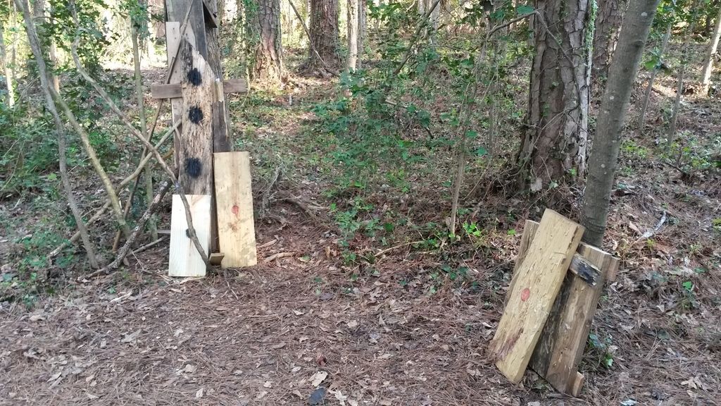

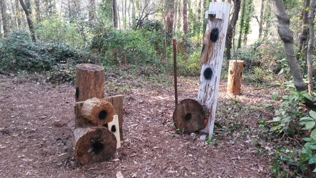

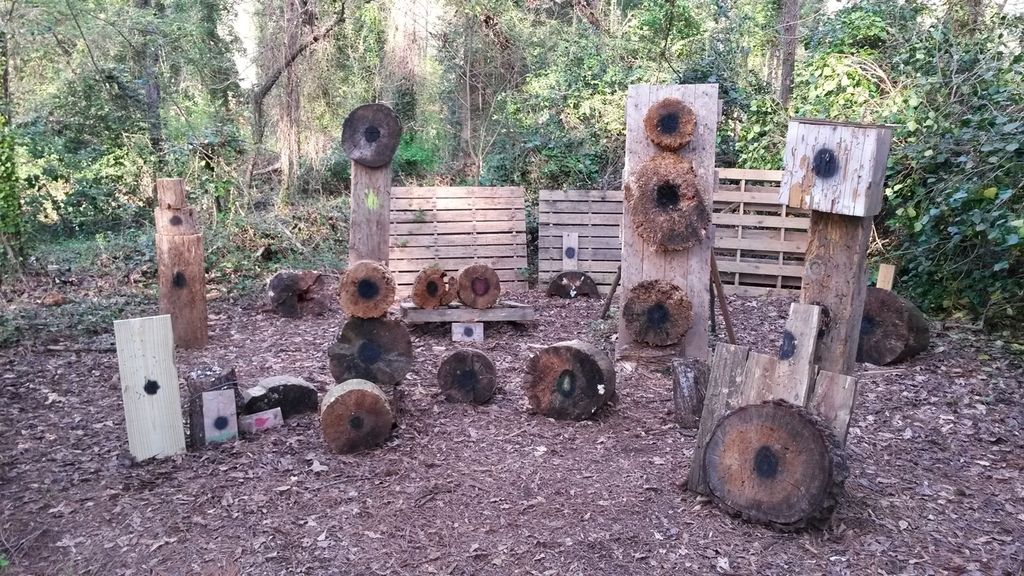

Here are a few shots of my throwing "gallery" it might help you get some ideas about how to use random pieces of wood for targeting. Hard stuff down low and soft stuff higher where bounces would be a bigger problem.
I was out renewing bulls-eyes today. I find I throw much more accurately when actually sighting on some definite small spot. On a tree stump I pick a knot and on a wall I'll use a scar or paint spot. But in my backyard area I just hit the targets with a bit of black spray paint about once every two months. Anyway, you will notice the various stuff. Of course this is hidden in the woods so it doesn't look bad in the yard and my wife enjoys throwing too so I don't catch heck from that angle. I make sure there are no nails and when they split I just stack them out of site in the woods with the rest of the composting timber.
