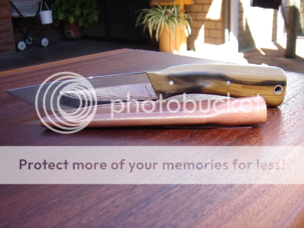

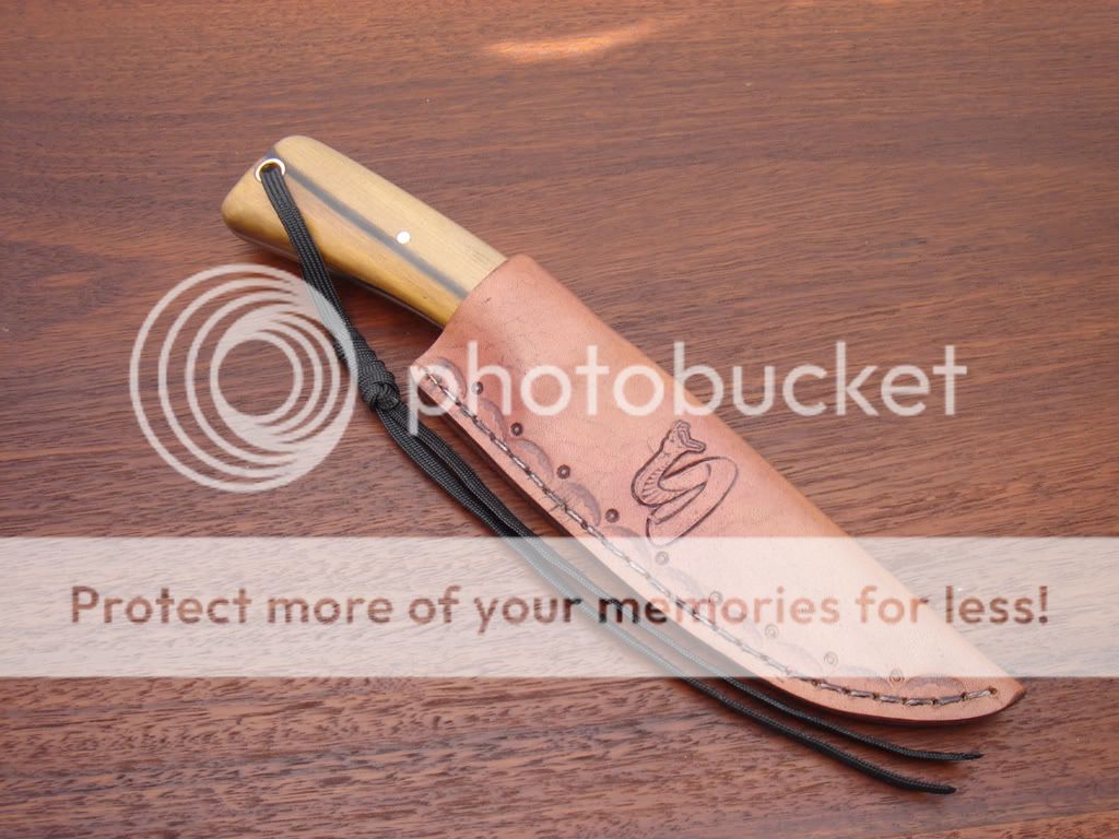

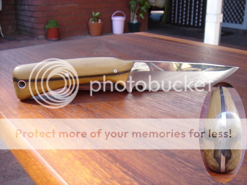

Well I made a knife with wood I bought in Tassie ,I also bought a basic leather stamp set and a piece of leather to make a sheath .
Blade 1/8" X 4.5"
Handle Blackheart Sassafras 4.5"
The camera picked up a few scratches I missed on the butt.
Had to have a cap lifter to keep up with Aussie tradition.
Let me know what you think + or -
Thanks for looking
Richard

It did smell quite nice when I was grinding it ,but didn`t know you could get the oil my family in Tassie may be able to locate some.
The colours in the wood are great ,I couldn`t book end the scales except right at the butt because it was already cut into planks when I got it.
I found that the lighter the colour the softer the wood so what I did was get the scales almost to size then put them in a plastic bag with diluted wood glue and put 5lb of negative pressure on them with a small vacuum pump for about 5 min,after it was dry I gave it the finger nail test and it seems to have penetrated quite a bit into the softer wood.
Richard

Hey tinbasher the blade looks great, (as is the sheath),that Sassafras came up a treat. What's the steel if I may ask. I'm about to start my first and I'm using a power hack saw blade, the blank cut out easy enough, I haven't started to grind yet, I have a feeling the blades might be too brittle, but we'll see.
Not quite sure on the steel ,its a circular saw blade ,in the raw its quite drillable and files well but after I heat treat it it quite tough.
A lot of power hack saw blades are made from two types of steel fuse welded together when you take the paint off you may see a line along the saw tooth side , if yours is like that then the main blade is not as tough as the saw side and should make a blade that won`t break to easy. If its all one piece then it may need to be tempered a little ,but then if you are only going to cut things and not pry open wooden boxes it should be ok.
