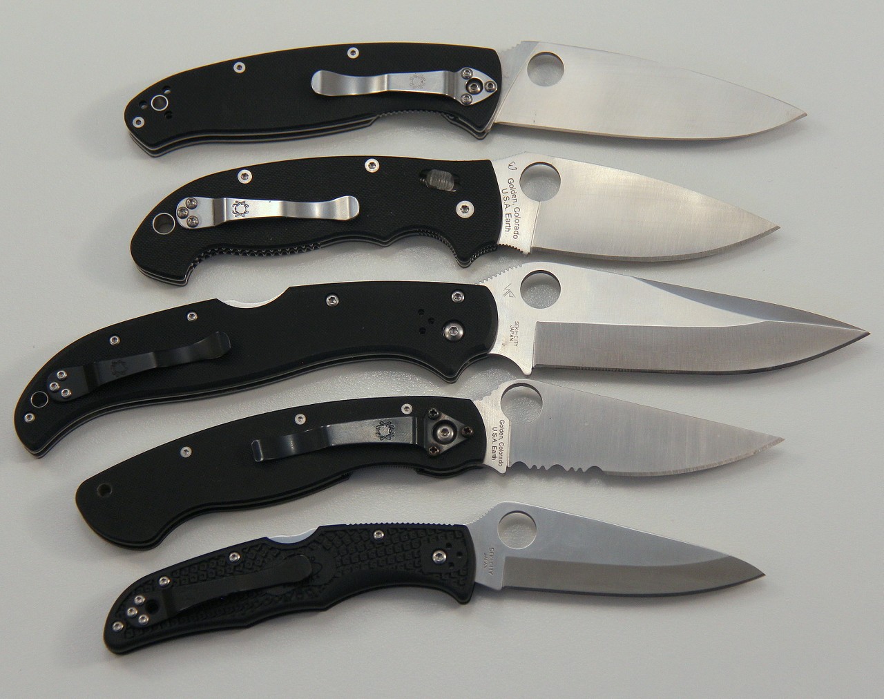

Top to bottom
C142 Resilience
C95 Manix XL
C180 Tantanka
C36 Military
C10 Endura
You know how they call some Spyderco knives “little big knives”. When you first get them they seem tiny, but the way they fit in the hand and how their performance exceeds their size. Your perception of their size changes.
Well it is bit like that with the Tatanka. First impression is that is a massive knife, almost to big for practical uses. The Resilience has all steel liners also, but it is a light weight in hand compared to the Tatanka and it feels as big as it looks.
This is one serious folder.
I have average size hands, when I take in a standard grip there is a lot of handle sticking out the back. It feels to be a very solid grip, well balanced, total control. Choking up on the blade, trigger finger in the choil, (Yep I’m a shooter) again total control. I feel confident I could do fine cutting like that.
Getting back on the handle gives you a lot of extra reach with the blade. Good to get a bit swing in those small machete like jobs. Warning! Don’t get tempted to rest your thump in the lock release when you have you hand back there. It may not end well and you may come away with fewer fingers than when you started.
Opening the Tatanka one handed is easy. Closing the Tatanka with one hand can be done but should be done with due care. Don’t have your mind somewhere else when you are doing it or you may be picking up fingers from the ground. Two handed closing is easy.
:D Don’t let all this potential lose of fingers put you off the Tatanka. As I said it is serious folder capable of doing serious things and should be treated with respect. If this knife is opened when there are people are around and they all take a step backwards.
If you want a folder to carry when you can’t take your heavy duty fixed blade; then this is the folder for you.

great photo
really useful review

The Military is a large knife. And yet, in that above picture, it looks puny! LOL
