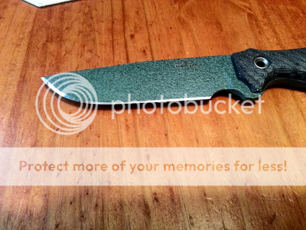

I use the edge pro for most knives, But still use the lansky kit for some. I have the full set of chosera stones and balsa, leather and nano cloth strops. I sharpen SR-101 to 20 degrees per side.
Thank you. I spent quite a bit of time on it. She's so sharp the branches fall just at the sight of it. LOL!
I've spent a little more time on the RMD since that photo. Now it's perfect too. Now I'm looking at the taliwhacker and debating on weather I should sharpen it or not.
