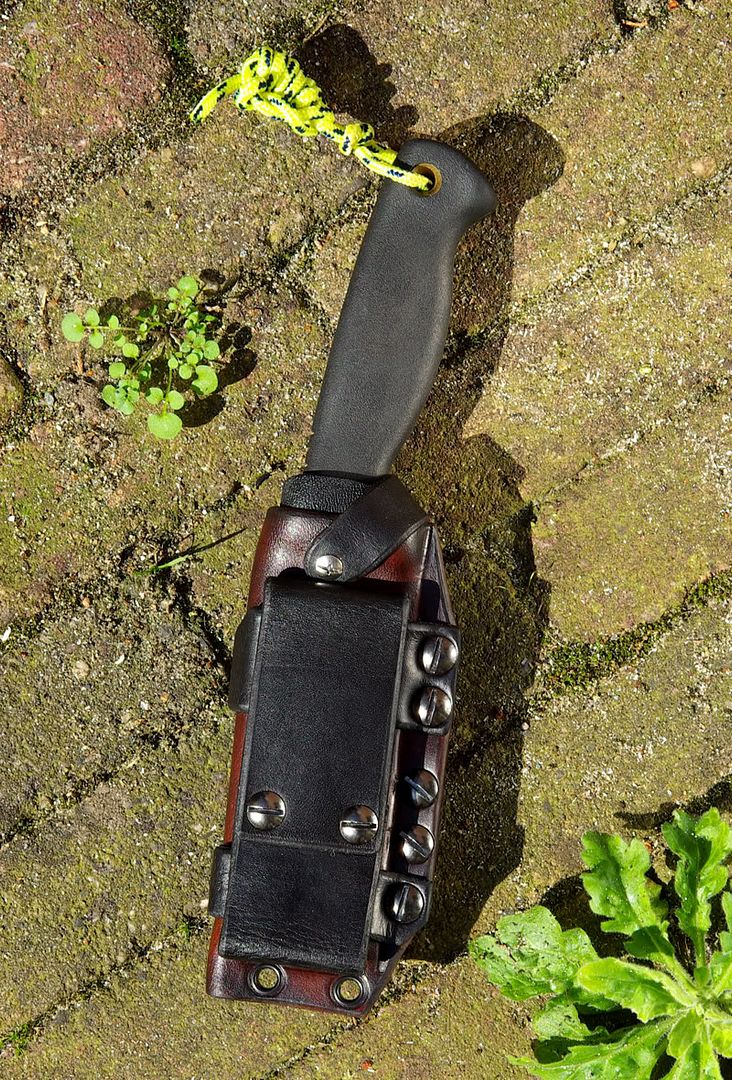

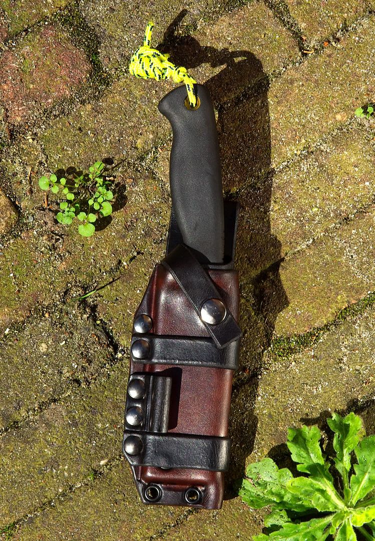

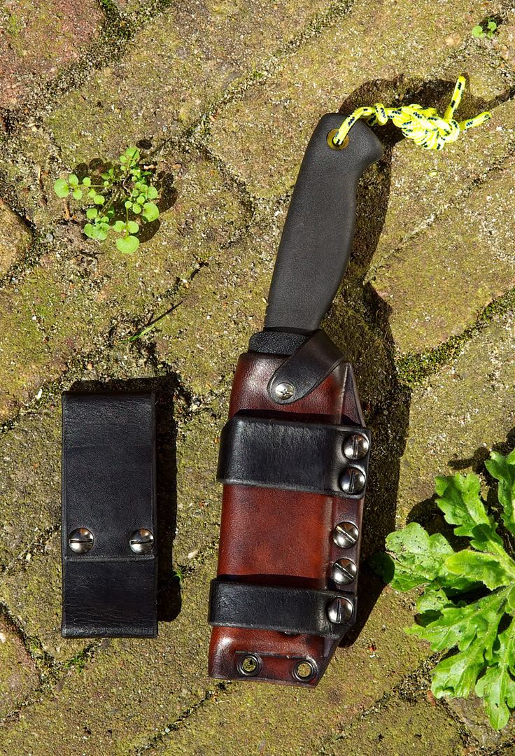

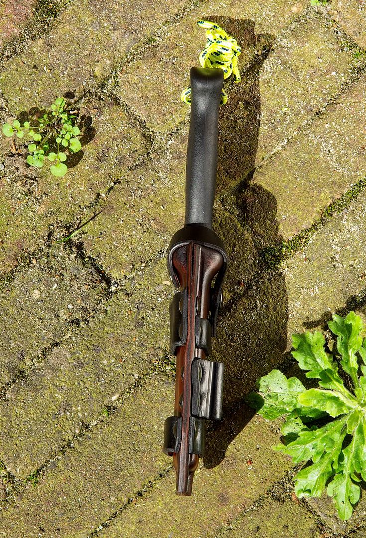

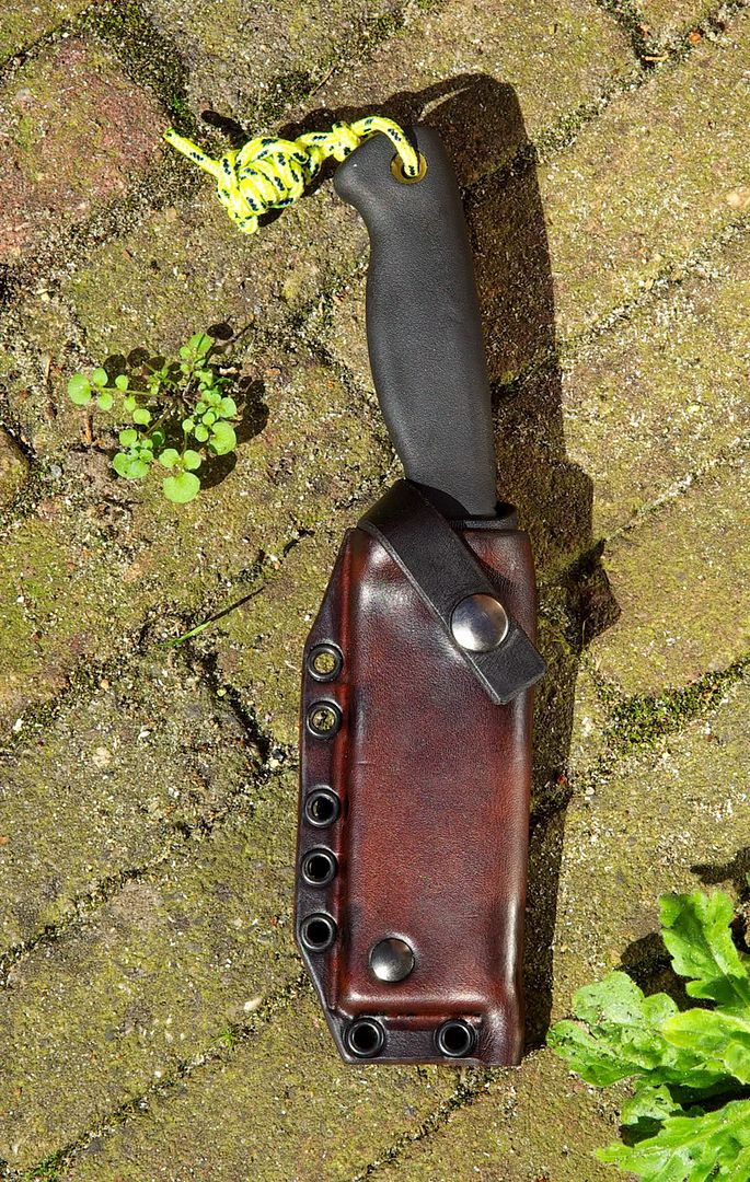

It's the first Swamprat I made this type of sheath for..
It has a 0.125" removable kydex liner.
The pouch is made of halftanned leather, wetformed around the liner.
The rivets are spaced to accomodate a tek-lok, molle-lok, or stuff like firesteelloop, horizontal carry loops, etc. It wil also fit a maxpedition type of pouch on the front.
The vertical beltloop can be setup for high carry and mid carry.
the retentionstrap pivots away after loosening. It can be fixed in a position where it doesn't interfere when drawing and sheathing very often without use of the strap.
I hope you like it.
