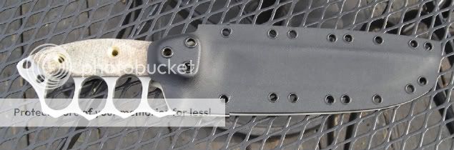

here is a dropleg:D

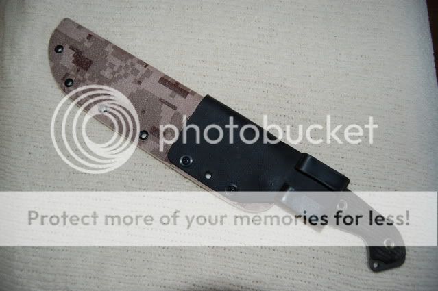

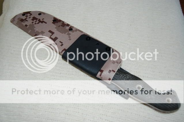

The kydex holding on the legstrap on my b11 sheath is what you need on the back of yours to mount the tek-lok on.
A kydex bridge would work you just have to make sure it conforms to the shape of the sheath or it will put pressure on it possibly causing problems with the fit of the knife.

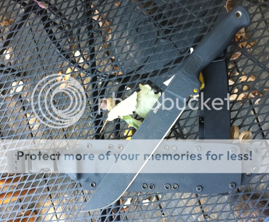

While this didn't use a tek-lock, here's one solution I followed to avoid having only two attachment points. Not the most beautiful thing but very strong.
BTW I'm not a fan of tek-locks although they do have their place.
