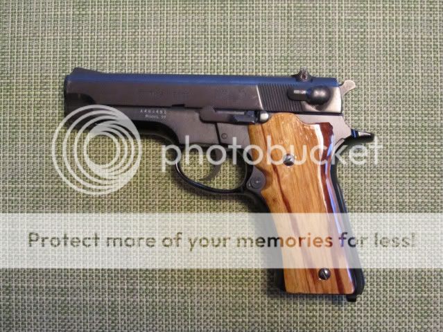

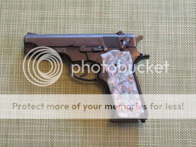

I'm not, by any measure, skilled at creating custom grips, but I have made some grips previously for my pistols and knives. I usually use exotic hardwood, "swirled" micarta, or G-10, like this:
or this:
but for this knife, I wanted to use scrap pine as a "quick & dirty". I might use some other material on this knife later, but I wanted to confirm that a fuller grip would be better.

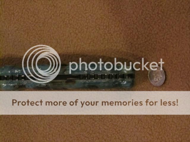

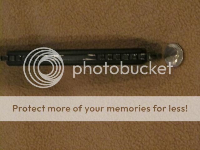

I was curious about the actual original thickness vs the pine scale thickness, so I did some photos & measurements:
original scales; total thickness: .485" (constant reading, since the scales are flat)
with new pine scales; max: .855", min: .76"
