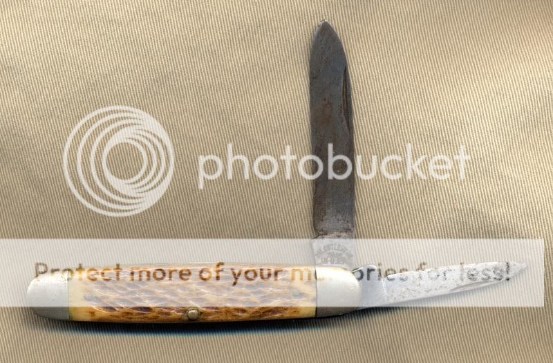

The Senator pattern, aka "equal end pen", pattern is my favorite. Unfortunately modern examples are scarce.
Here's the Case pen knife, which is not a senator since the ends are not symmetrical.

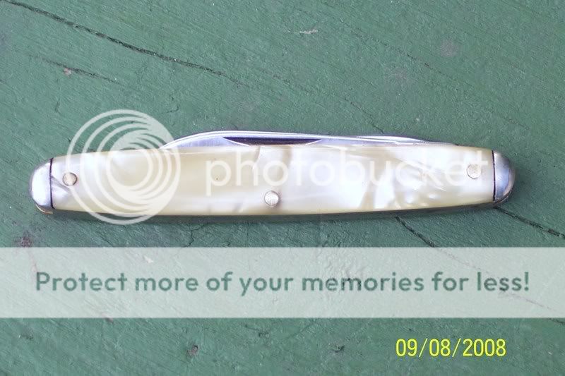

Here's one that is a senator, recent production but now discontinued:
