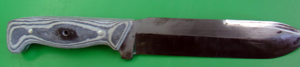

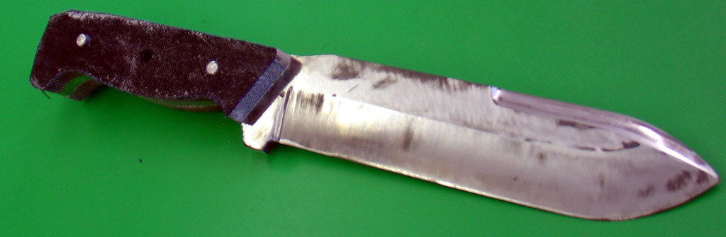

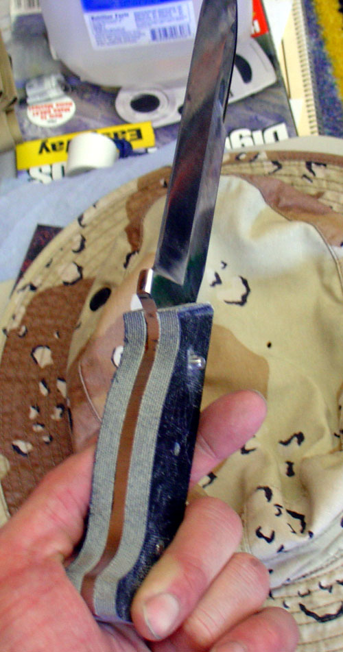

Here are two 3V blades I did not long ago:
Preheat: 1525 F / 7 min.
Austenitize: 1950 / 22 min.
Rapid air quench
Snap temper: 300 / 1 hr
Deep cryo: 13 hr
Temper: 1000 / 2 hr
Temper: 990 / 2 hr
Temper 990 / 2 hr
Tested hardnesses after final temper: 60 HRc and 59 - 59.5 HRc
RL
