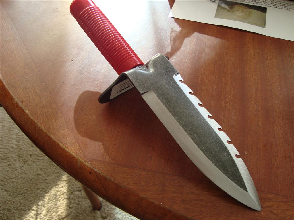

I've managed to bend, break and deform most trowels out there, hence the need for something a bit more stout. Its not going to be a true scandi grind, but just a short one.
This is one of the better digging tools on the market, I've used them and they are good, but I don't feel like paying $50 for one when I can make one for <$20 in materials... this will be the type of grind I will use, it is chisel ground.
(Not my pic, pulled from the web)
But, like you said, I will be testing it hard!
