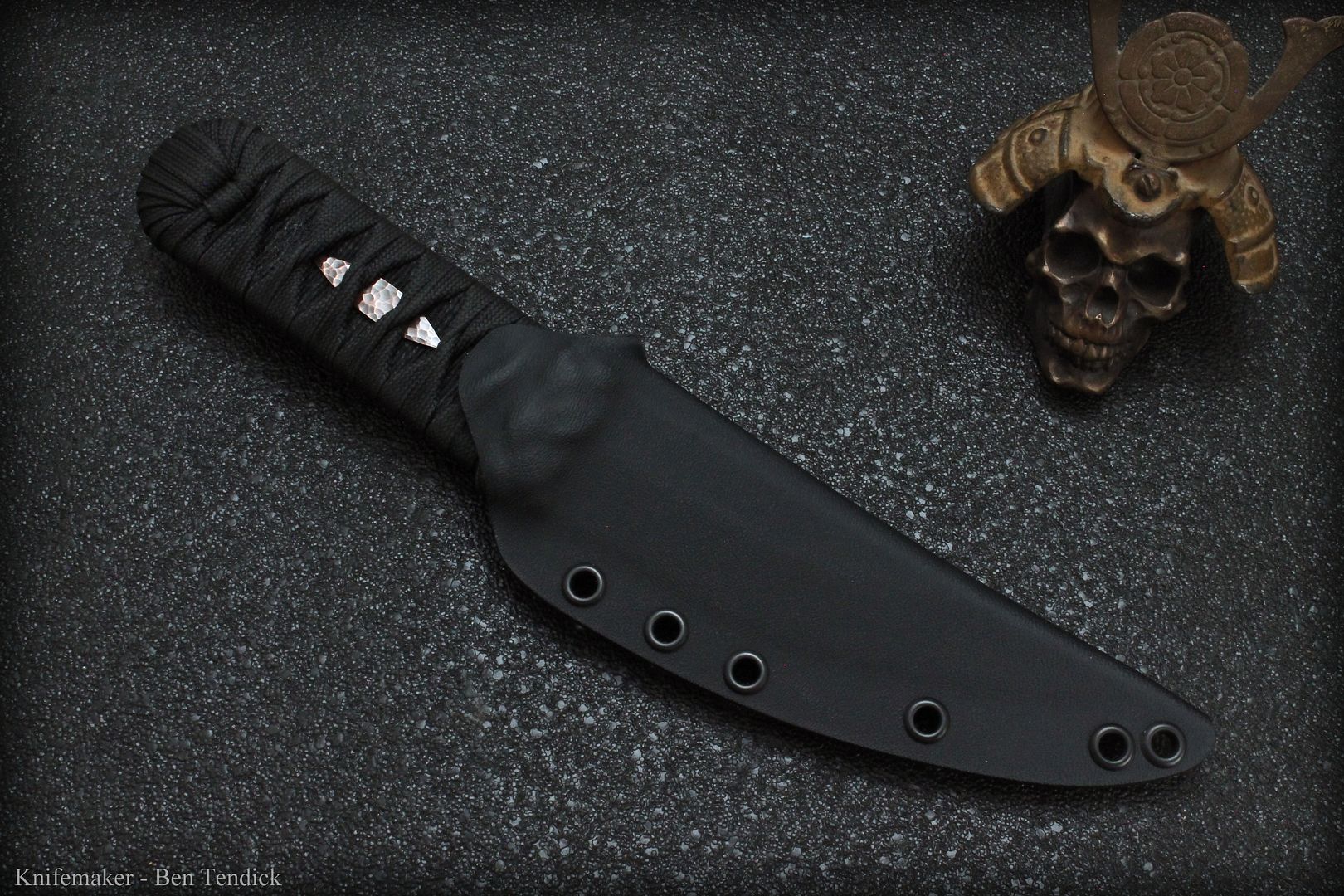

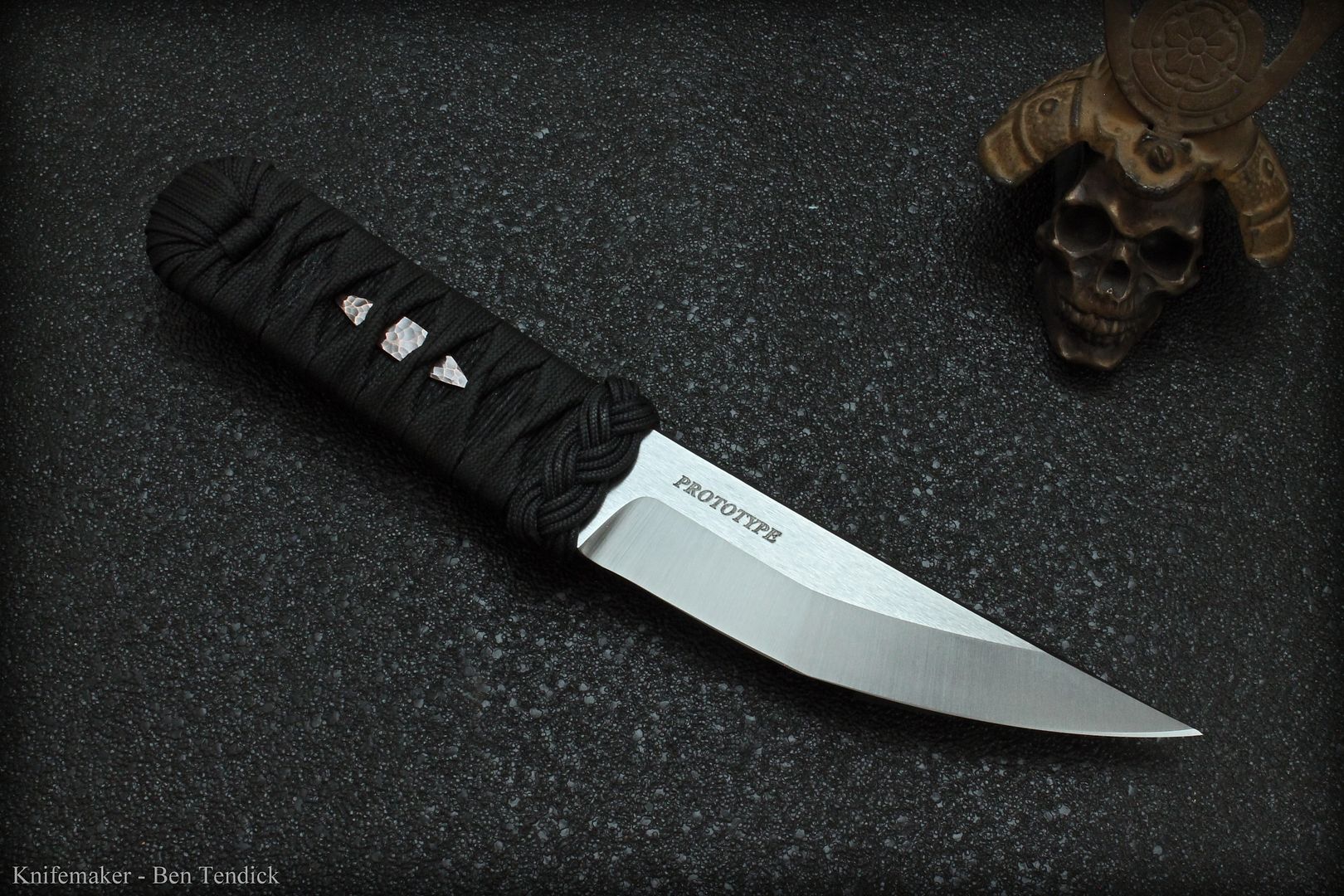

This one is an Osaraku Zukuri style blade like they are well known. It has just over a 5" blade. It is CPM 3V with my custom high performance heat treat and Cryo.
The spine is beveled in a mitsu mune style. The menuki are texured and antiqued copper.
This one is a prototype pc, and I will be doing at least 10 of them for them hopefully in time for the SICAC Paris knife show in September. Chris is working on the menuki for those right now, which will be custom and likely silver.
That looks great! I have a couple of the Hissatsu pieces and they are superb.
A natural collaboration, for sure. So awesome, buddy!!!!
That's an evil transition to grind. Yow. You KILLED it, man!
Thanks very much guys, it's honor to be doing these.
