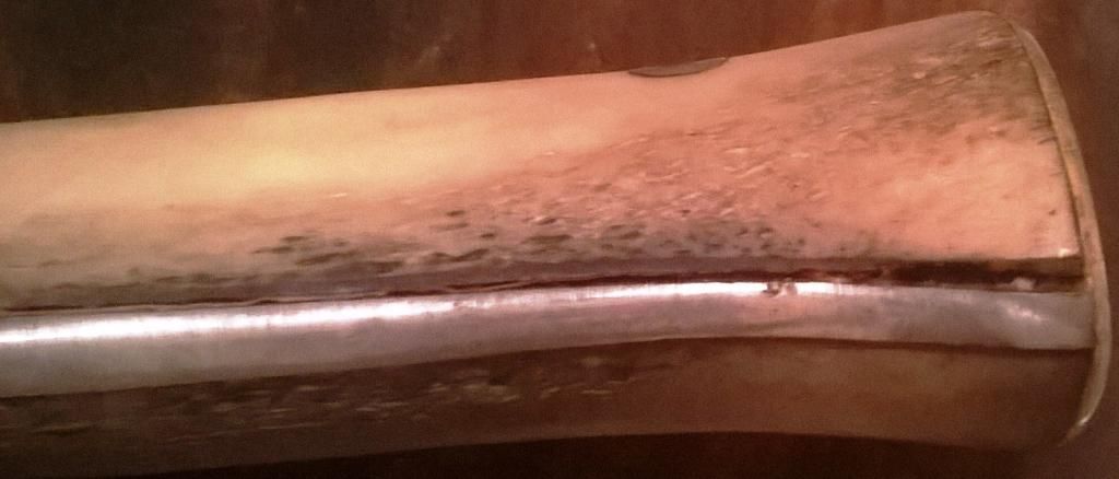

My little JKM-1 has been getting a lot of use in the kitchen since I bought it, it's really a handy little knife. I've kept the blade fairly nice but the bone hilt is starting to deteriorate. I was thinking to just pour some superglue in there to seal up the cracks. Any other advice?

Doesn't look like bone failure to me but the attaching laha breaking down. Hard to tell for sure from the picture but the bone looks good.
I'm on board with the soaking in mineral oil idea but I'm also semi reluctant. If that doesn't work then any chance of epoxy or my choice would be acraglas adhering would be out the window.
But that being said the bone panels are pinned on so the laha is just a secondary insurance.
If it was on my bench I think I'd take a razor knife, exacto, what ever tiny little sharp pointy thing you have and carefully clean out what ever adhesive you can. Then I'd confirm that there is no movement on the panels and no need to peen the pins a bit to tighten things up. After that I'd probably fill the gap with epoxy or acraglas and let it set for 24 hours.
Then I'd do the mineral oil soak and clean off any excess epoxy etc that needs to be removed.
I could be off on this but that would be my plan of attack. The mineral oil soak alone just might make everything okie dokey too.

It doesn't show well in the picture but a streak in the bone went really spongy, presumably from washing and whatnot. I think I'll rehydrate the bone with oil, seal the spongy bits with superglue, and then smear the rest with lanolin
And maybe pour some epoxy between the scales and tang
Id do the glue and epoxy first. Let it cure a day or so then oil it. You want the glues to adhere to the bone. Glue wont adhere to oily bone very well.
You'll need to seal it with superglue before you oil it, or the superglue will not adhere or penetrate into the porous areas! Same for filling the gap between the scale and the tang with epoxy. Do the repair and sealing first, then oil it if you want. But I don't think using oil on bone is a good idea. If you insist on sealing it with something, I'd use a wax, instead of an oil.
