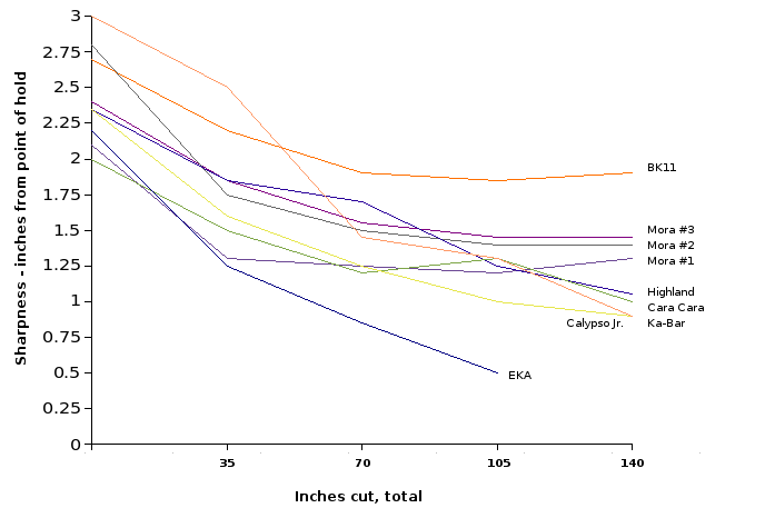

Like most of you I imagine, I've noticed that a fine edge quickly looses that high degree of sharpness pretty quickly. Cliff's recent thread comparing a Zubeng utility hunter and Caffrey MEUK got me thinking about this in earnest, so I decided to run tests on some knives of my own to hopefully study early stage edge retention.

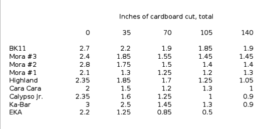

My test method was pretty simple: starting with a freshly sharpened blade I would measure loss of sharpness from cutting cardboard by testing sharpness on newsprint. "Sharpness" here means the maximum distance from point of hold where the blade is able to push cut the paper (the higher the better.) My hope was that using newsprint as a test medium would offer good "resolution" on sharpness loss in its earlier stages. I also relied greatly of the reliability of the newsprint test method which I've been using a lot lately and only repeated tests or rejected results if I felt technique was poor or it seemed too much of an outlier .... meaning this is informal testing mostly to satisfy my own curiosity. To improve control while cutting and better limit the section of edge used I cut with handle lower than tip, giving a combined push cut and slice action, and with the blade also held about 45 degrees (left-right) to the plane of the cardboard to reduce wedging.
I'll jump right away to a graph and table of results so nobody has to wade through a bunch of details if it doesn't look interesting:
Table of data plotted above:
Following are descriptions of the knives tested with manufacturers' specs, edge geometry and brief comments:
Frosts traditional Mora (Mora #1) - carbon steel laminate ~61 HRC, 10 deg./side, 15 deg. microbevel. This knife was one of the more awkward during use, probably due to handle ergonomics.
Frosts 906 (Mora #2)- carbon steel laminate ~61 HRC, 10 deg./side, 15 deg. microbevel. Same steel as Mora #1, added to testing queue to compare after somewhat erratic findings with Mora #1.
Eriksson 945 (Mora #3) - 12C27M ~58 HRC, 10 deg./side, 15 deg. microbevel. This knife is a sleeper IMO, not only in edge retention but excellent handle ergonomics. Edge condition after cutting looked exceptional under magnification, best of the knives tested. This blade gave quite a few sharpness readings significantly higher than those reported, so results shown for this knife may actually be conservative.
Cara Cara - 8Cr13MoV ~61 HRC, factory edge about 20 deg./side, 22 deg. microbevel. Basically the factory edge with microbevel added to improve consistency a bit. Sharpness testing a bit more challenging due to coarser edge finish, but all things considered it looks like this steel with its greater hardness may compare well with some premium blade steels.
Calypso Jr. - VG-10 ~59 HRC, 12 deg./side primary, 17 deg. microbevel. From a user standpoint this is the easiest knife to use for cutting cardboard .... control was so good it may be that results are skewed a bit low due to ease with which cutting could be isolated to small area of the edge. Of the three knives showing any micro-chipping this was the most extensive but still only very, very slight.
BRKT Highland - A2 ~59 HRC, convexed with apex 10 deg./side and 15 deg. microbevel added.
Ka-Bar Dozier - AUS-8A ~57 HRC, 10 deg./side, 17 deg. microbevel. Selected as kind of a minimum standard for blade steel favored by many who post to BFC. High starting sharpness is easily attained with fine ceramic, edge condition after cutting looked excellent with no micro-chipping indicating performance was due to lower hardness and faster wear than others.
Becker Necker (BK11) - 0170-6C ~58 HRC, 10 deg./side, 15 deg. microbevel. Even having used this knife quite a bit lately and liking it a great deal I was surprised by its performance. Like the Eriksson Mora I rejected quite a few higher sharpness readings during testing.
EKA compact - 12C27 ~59 HRC, 10 deg./side primary, 15 deg. microbevel. Surprisingly low performance, especially considering results from the 12C27M Eriksson.​
There's a lot I see in these results that would be interesting discuss, since this post is already kind of long I'll mostly let others take it wherever they'd like to go (if anywhere.)

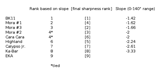

One thing important however, I think it's useful to judge the knives in the test by the average slope of the lines in the graph and not just end sharpness - slope reflecting the rate of loss of sharpness. This not only gives some correction for the different initial levels of sharpness, but just looking at the chart the slopes of the lines seems to invite extrapolation as to what would happen if additional cutting was done.
Ranking performace by the slope of the line doesn't change things a lot - sheds maybe a little light on relative performance between the three Moras, and suggests the Cara Cara may compare pretty favorably against both the VG-10 Caly Jr. and the A2 BRKT Highland:
Of course you could look at slope using just a portion of the data different section, say from the 35" to 140" mark, but absent more rounds of testing I think I'm already pushing limit a bit on what can be reasonably concluded from this.
One thing that does seem pretty clear, those of us who like a very fine polished edge for things like wood carving have to accept that more abrasive materials will quickly degrade that fine edge, so having knives dedicated to certain kinds of work may make a great deal of practical sense. IMO there doesn't seem to be much point in putting a really fine edge on a knife that's going to get used on cardboard or other abrasive materials. With a little practice using a Sharpmaker or similar it's not hard at all to get a decent blade to push cut newsprint at around 1.8 - 2" and that's probably more than adequate for an all-around utility blade .... in fact I believe with some blades raising a higher level of sharpness can lead to edge stability problems, resulting in an edge that in early stages becomes more dull than if it had been left not so finely sharpened.

First off all, an impressive amount of work and analysis, I would hope this is not a singular event. Secondly, the comments made about suggested changes to method are just that, suggestions, not mandates.
So there was no draw and the cutting was constrained to a section of edge basically the width of the cardboard? Are the results presented of one run or an average of several?

The colors are a great help, in general with experimental data you want to see the measured points in addition to any models or smoothing curves. For the points themselves it is of extreme benefit to have a measure of the confidence of the data, usually the standard deviation in the mean or a scaled IQR for median data. Without this measure of uncertainty it is very difficult to tell if results are significantly different.
What exactly do you mean here, how were the measured values determined - a selective mean? A median is ideally suited for samples that are prone to outliers (low frequency but highly deviating) as it isn't sensitive to thier magnitude. You can use the standard deviation as a high end estimate of its uncertainty but it is better to use a scaled IQR. The formula's are easily used in any spreadsheet or decent calculator, freeware versions of each exist.
You can model the data by a simple power law which is easy to fit on freeware programs. It has been several years since I used spreadsheets but I recall that they could do it as well. This will give you both the estimates for the initial sharpness and the type and rate of degredation which use the entire data set to provide estimates for each attribute, this makes the predictions far more robust.
... absent more rounds of testing I think I'm already pushing limit a bit on what can be reasonably concluded from this.
Yeah, based on what I have seen I would want about 15 points to get a decent estimate of the relative behavior and that takes a fair amount of time especially with the volume of knives you are using. However as long as you keep the cardboard pool consistent and do them within a sensible time frame you don't need to do them all at once anyway.
If you are going to hone an edge so the bevels meet, then making it as free of defects and debris (make it sharper) would only make it stronger. However some cutting tools like cold chisels have radiused edges because if they were fully sharpened they would indeed be too weak. The sharpness for such tools is essentially zero compared to a knife edge. In general it is also the case that the optimal edge angle for edge retention isn't simply the most acute one possible because at some point it will just fold and thus a micro-bevel of the right angle will give optimal cutting lifetimes. However I would not call adjusting the angle effecting the sharpness, confusing the two is one of the main sources of misinformation and confusion about knives.

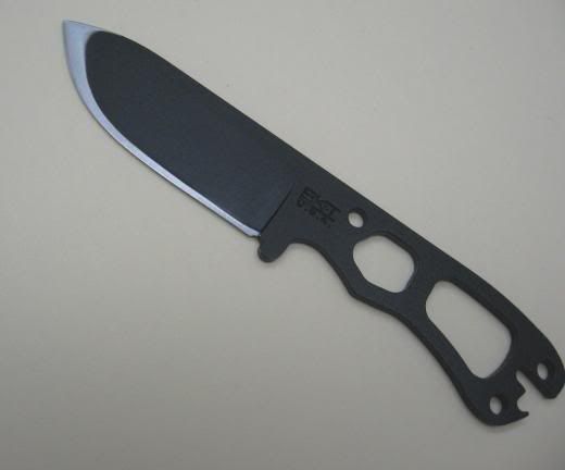

How high is the bevel on the BK11? I've got mine at 15 per side, and it's about 1/4 to 3/8 inch wide. You're running it pretty thin, have you cut anything besides cardboard with it?
This is where my method I think could be seriously criticized. Push cutting newsprint I believe is a pretty sound method of testing sharpness, it's even surprising how often you get the same result repeatedly, +/-.05". But there are exceptions, sometimes the newsprint will be less stiff from handling, and I've noticed that heavy inking on both sides affects results.
Since I always start the sharpness measurement trying to cut the newsprint further out on the paper, sometimes you get a higher cut that's probably due to a weak spot in the paper or an irregularity in the blade that's extremely sharp. So if I couldn't also get the blade to push cut ~.10 and ~.20" closer to point of hold I rejected it outright. I would then either trim a clean edge on the newsprint or take another piece from the same page and repeat the test until results were consistent. Instead of averaging, I used the most conservative data reflecting the edge's repeatable push cutting ability.
Pic of the BK11:
I've had it at this geometry, 10 deg./side and 15 deg. microbevel for maybe a month. From the tip back about 1.25" has been lightly convexed, mostly because I found the 10 deg. edge practically matched the blade grind near the tip and did this just to clean it up.
It's seen EDC use and cutting of some pretty tough wood, ash and branches from an ornamental plum/cherry, and it's been fine. Before that I had it at 12 degs. plus 17 deg microbevel and I know that is very durable. There was just the tiniest bit of micro-chipping seen after the cardboard tests so I'm going back to the 17 deg. microbevel for general purpose use since a big reason why I carry the Becker is it's robustness for a knife this size.
