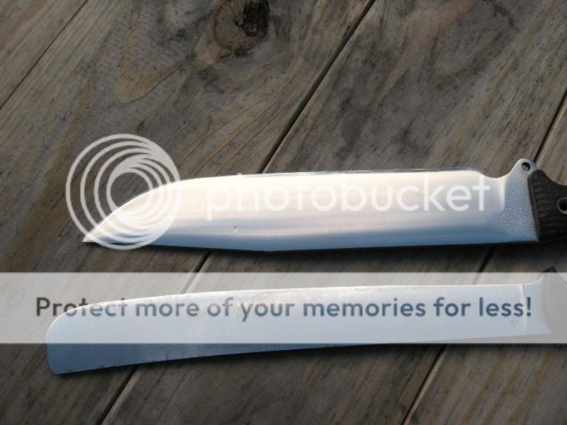

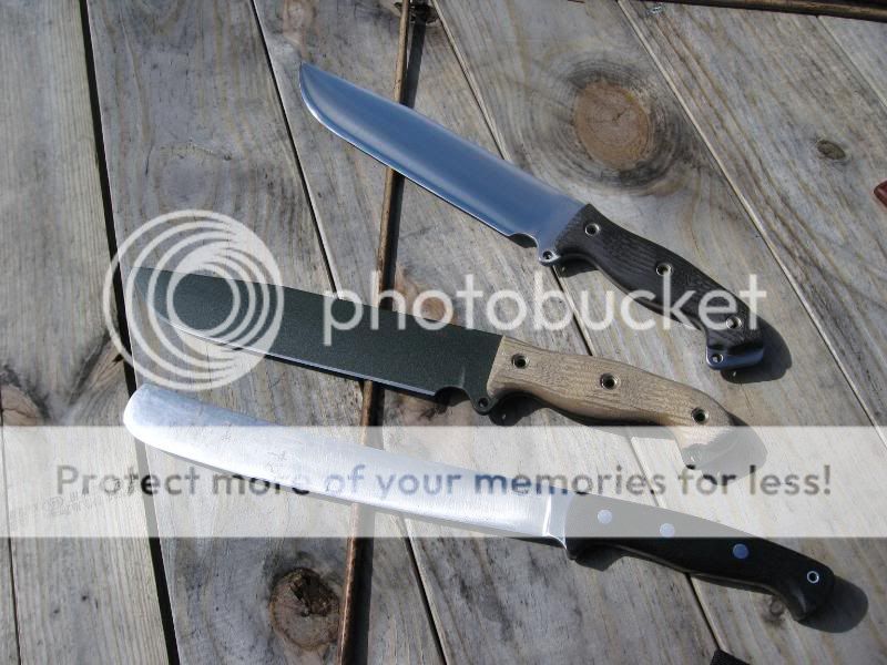

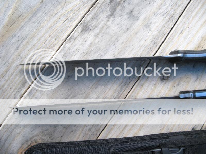

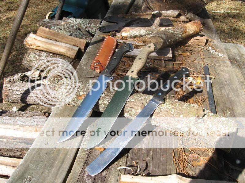

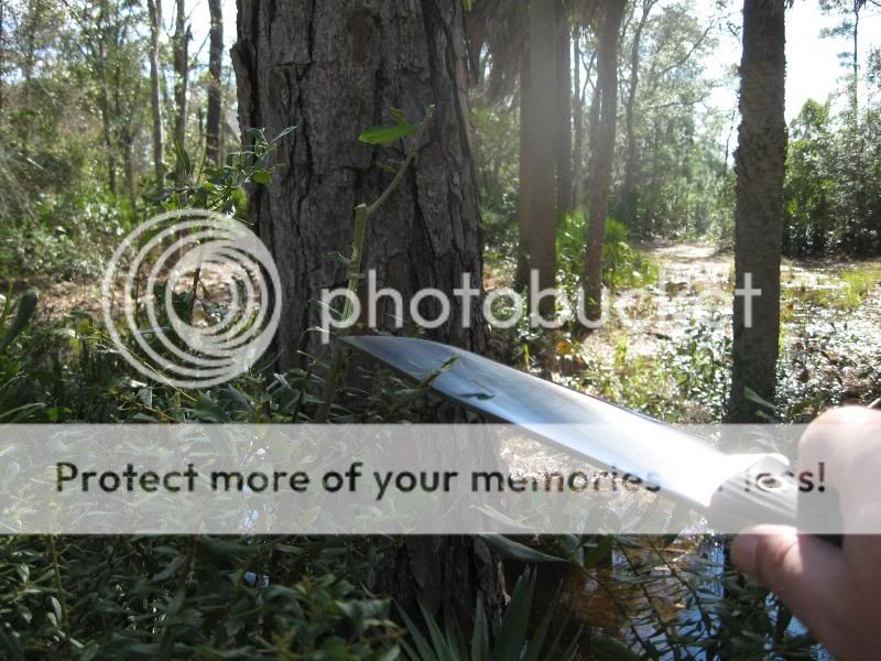

This is all Ankerson's fault! Now my shiny BWM is all dirty. When his thinned out BWM edge rolled and chipped a bit on some pine, I wondered if I had gone too far as well. So I gathered my convexed BWM, a factory edged new BWM, and one of the thinnest edged choppers I own, my Bark River Golok. I decided to compare them chopping wood and slashing brush. Then I would check the edges for damage.
All my beautiful Red Bay trees are dying from a blight, so I have plenty of that wood to chop up.
No damage so far. To be continued.
I can't wait.:eek:
Will the Golok finally find true love?:confused:
Will the hand-sharpened BWM ever kick that pine habit?:confused:
And how about the factory BWM?? Will it ever realize what the Golok is doing ... behind its back???:confused:
These are the Days of Our Choppers.:);)

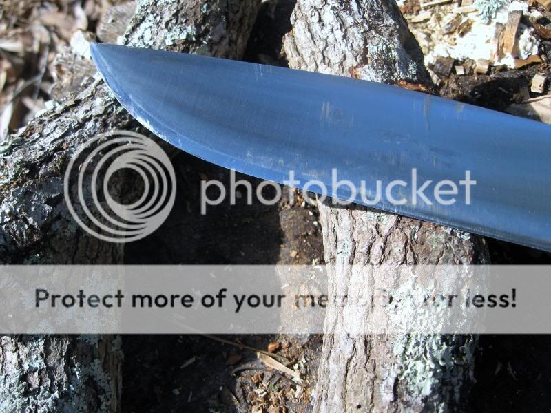

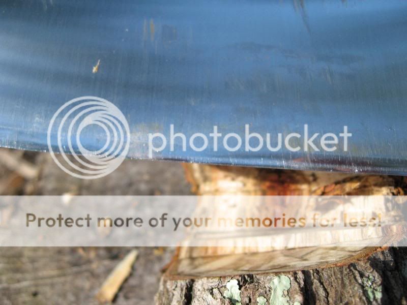

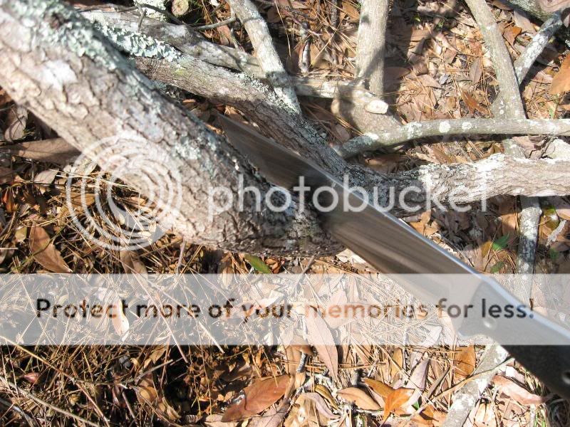

After chopping several limbs, large and small, the edge of the convexed BWM is intact.

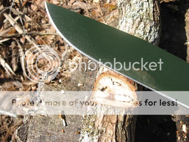

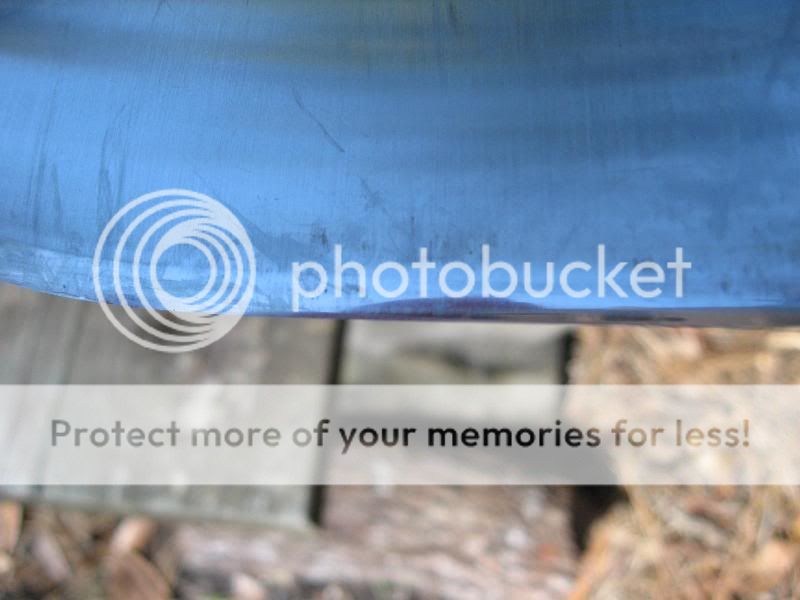

Just for fun, I did some chopping with the factory edged BWM. While it chopped well enough with the factory edge, the convexed one bit deeper and chopped better. Of course, the factory edge was undamaged as well.

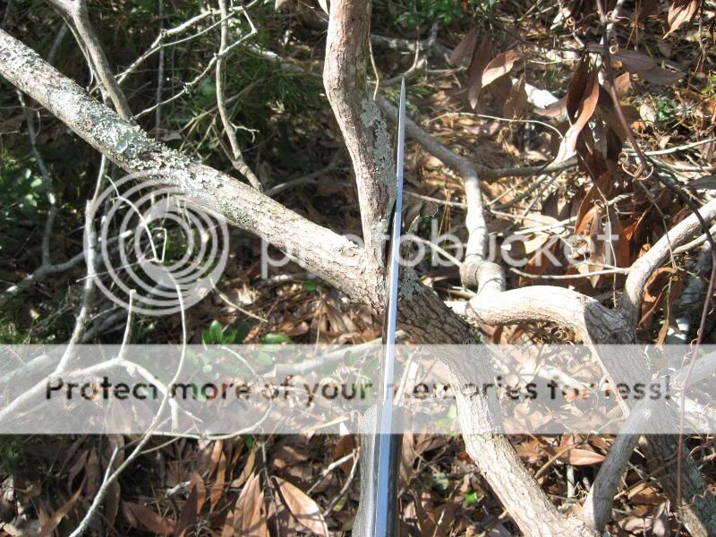

But the convexed BWM really out did it. It even out chopped my golok, which is a great light chopper.
Where the golok really shines is, excuse the expression, bushwacking. You can trim a hedge like a pro with the light, fast knife.
To be continued.

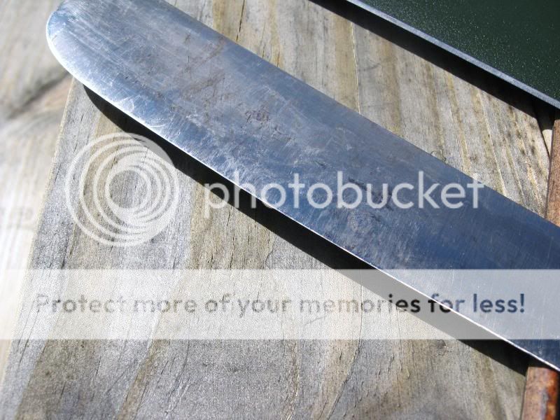

The BWM did very well slashing the Wax Myrtle bushes, but not quite as easliy and cleanly as the lighter, faster Bark River golok does it.
It can cut a standing Palmetto leaf much better than the factory edged BWM can. Of course, the golok does this with ease.
It's been a fun afternoon comparing these fine knives. And the Bushwacker's edge is still just fine.

I can't explain it, Ankerson, but the convex edges just seem to hold up well for me. I have chipped my Bark River Golok in 1095, but that was on an oyster shell. And that Barkie is ground even thinner than my BWM. So I figured since INFI is tougher than 1095, why not thin it? Of course, the thinned edge would be damaged on concrete blocks or possibly even on a very hard knot, but I could likely steel that right out. INFI is strong.
