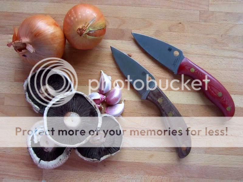

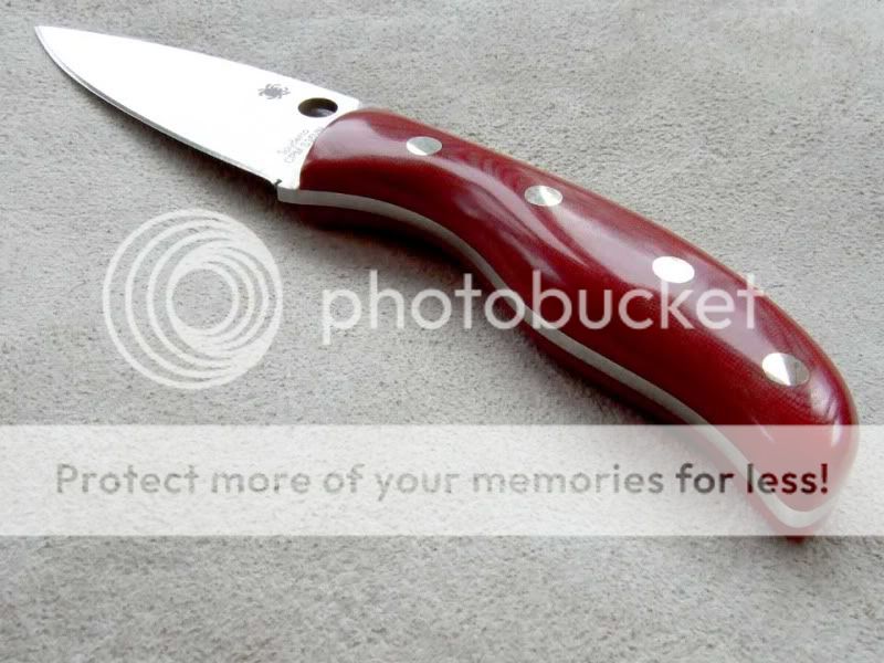

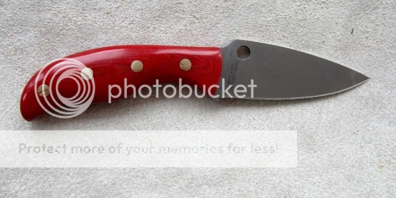

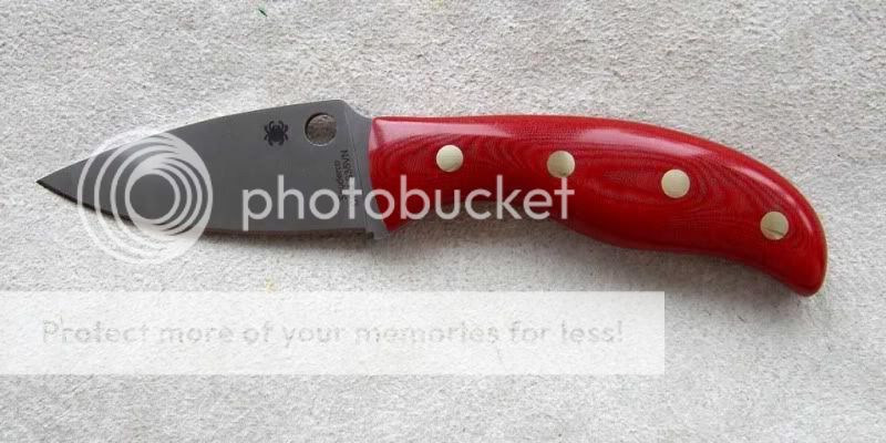

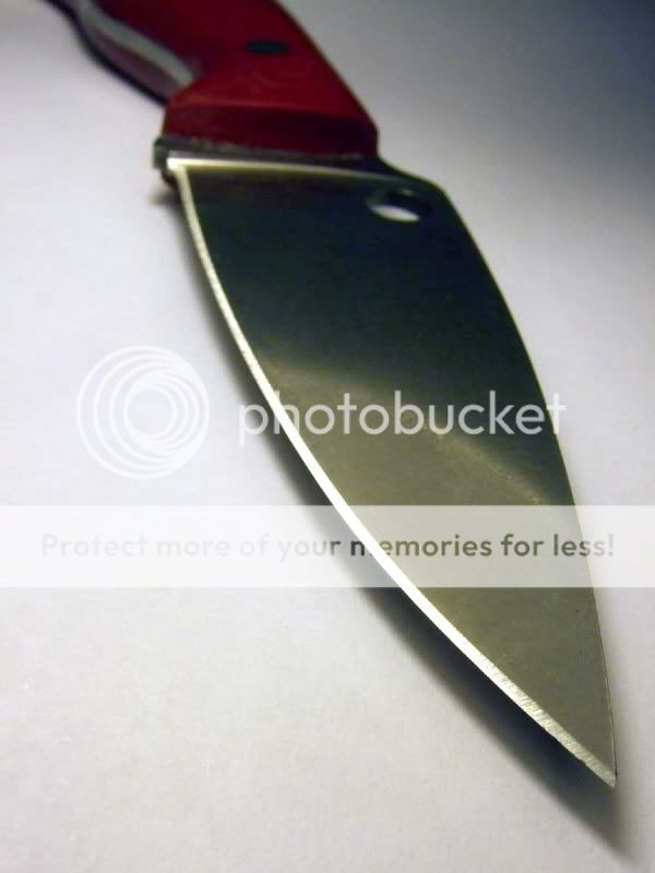

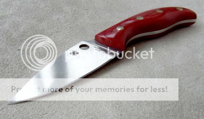

These were to be hard working knives, so I fitted linen micarta to my two mules. I also reshaped the guard as it is rather long. Both blades arrived very sharp.

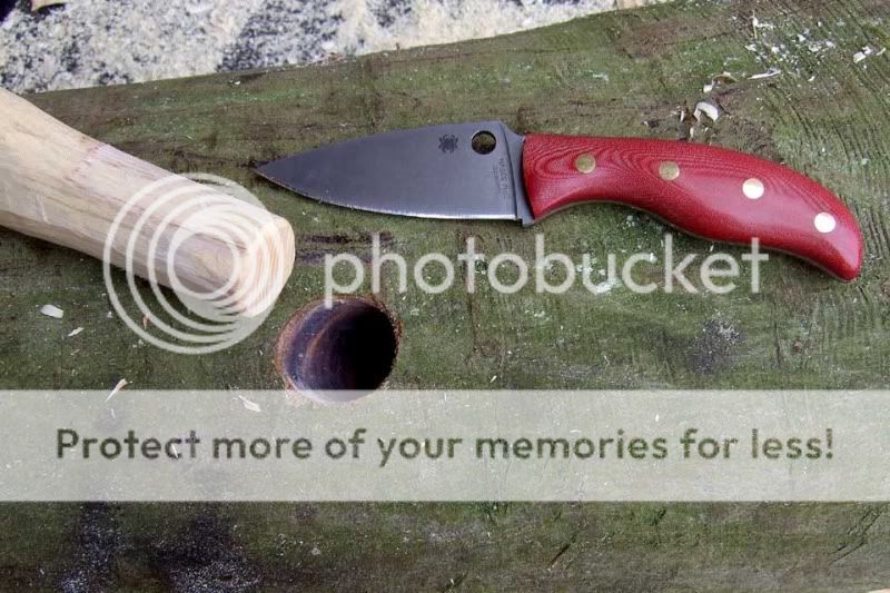

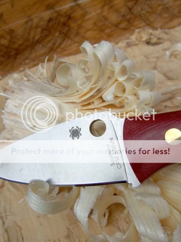

CPM-S35v with red linen micarta.

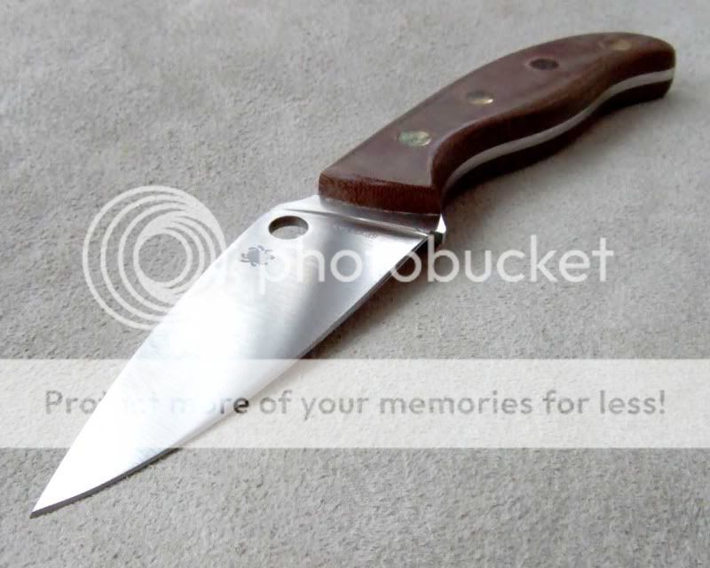

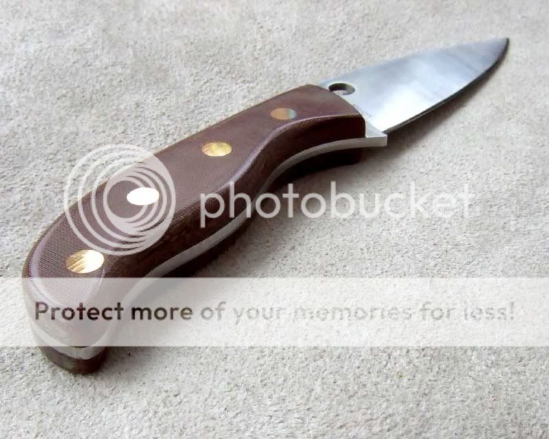

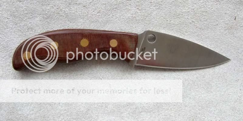

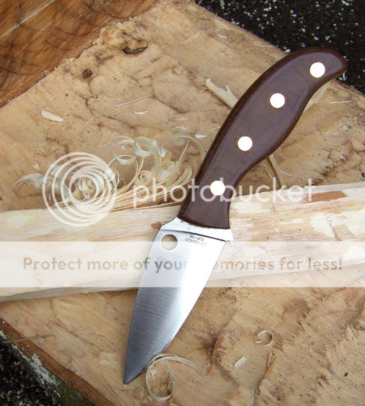

The other is a ZDP189 blade. Following reports of the exceptionally hard blade cracking/breaking, Spyderco announced an optional recall. Their initial plan was that the returned blades (unhandled) would be re-heat treated to a lower Rc (a mere 60-61!?) but subsequent analysis suggested the structure of the steel was at fault not the HT.
In view of the early reports of failures, I chucked on some ugly brown, linen micarta which was hanging around. I went a bit overboard on the rivets, in number and vigorousness of peening (you can see the damage to the micarta!) But this was a rush job for testing only. The blade didn't seem to mind me pounding away at those rivets. Not my best work!

Whittling an ash stave for a carving horse:
Feather (fuzz) sticks:
I found the CPM-S35v better for feather sticks. I suspect this is simply because I felt enough confidence in the steel to apply a lot of lateral force, allowing tighter, thinner curls. I was probably subconsciously aware that the allegedly very brittle ZDP189 might not like this treatment.
