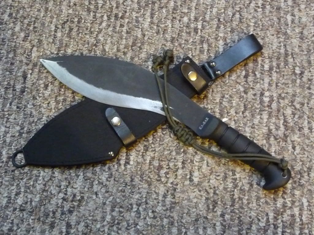

I went camping in the weekend and tested 4 choppers:
HI Ganga Ram Khukuri
KA-BAR Kukri Machete
BK-9
BK-7
Details and a bunch of pics in this thread in W&S:
http://www.bladeforums.com/forums/showthread.php?t=718438
Anyway the important details as far as the Becker knives are concerned:
I really didn't find the BK-7 that good at chopping - it can do it but it is hard work. I didn't even bother finishing the test with it to find out how long it takes. I did test out the BK-7 for batoning though and it handled that task very easily, it is a great knife for batoning!
I found that the BK-9 did bind in the wood a few times, but overall it was a great chopper - not really that far behind the bigger & heavier Kukri & Khukuri knives. The BK-9 bit deep into the wood and chopped through it in a respectfully short time.
Being smaller & lighter than the Kukri & Khukuri made the BK-9 less of a chore to use and if the wood isn't too thick (and there isn't too much of it) then it really isn't hard to process some wood to get a fire going.
The edges took no damage (no chips, no rolled edges) from chopping and batoning - I really like the 1095 CroVan, it is a great steel! After the chopping the knife was a bit blunter, but you have to expect that - a few minutes of sharpening and all was good again.
If anyone thinks their BK-7 is a decent chopper then I would have to presume you haven't tried a BK-9 - if that's the case then I would suggest getting a BK-9, you'll be impressed!
I have been impressed by how good the Becker knives are - the steel is great and the knives are a good solid design! There is nothing gimmicky about them then are an all business sort of knife that can get the job done. When you look at other knives that work as good you can't help but be amazed at how well priced the Beckers are! I am also impressed that the coating hasn't worn off yet - chopping & batoning have to be a fairly severe test for that.
Now that I am back and have gotten the edges back to the great 'shaving sharp' that I like I am again losing arm and leg hair. The trouble is that I like to get the knives to easily shave . . . on both sides . . . along the entire length! It means I lose a lot of hair to be sure that the knives are really sharp along the entire length - especially with the BK-9, but the BK-7 also has a decent length of cutting edge too.

Looks like you had a fun time testing. I have a cutlass machete from Ka-bar and love it.
The KA-BAR Kukri Machete is pretty similar and makes a respectable chopper - I paid $46 for mine and it certainly is not bad value for money at that price.
Looks like you had a fun time testing. I have a cutlass machete from Ka-bar and love it. The only thing I think needs to happen is tooge needs to get rid of that horrible hollow grind on it. It makes the blade bind, and chip easily. I ground the holllow grind down and convexed the edge. Now it rocks!
Agreed - I had a kabar kukri machete just prior to purchasing an HI khuk (followed by another two). The thing was great for machete usage... but the second you took it against anything that it couldn't hack through in one swing, it would bind hopelessly in the wood... and if you weren't careful in pulling it out without exerting lateral stress, I'm sure it would have easily chipped or dented. I also ended up putting a convex edge on mine... but with a file and sandpaper as I don't have a belt sander. Process took a good 2 or 3 hours, but the difference was night and day. That all said, I still prefer my HI m43 to it now that I know what authentic khuks feel like ;)
I haven't found mine to be that bad, maybe it varies with the type of wood being cut? I have been thinking about picking up a cheap belt sander for reprofiling my bigger knives - it would be so much hard work by hand. My HI Khuk was the quickest at chopping through the wood in my test, but it was the heaviest - I am wondering about thinning it a bit to reduce weight and help it to cut deeper. The HI was definitely hard to baton through the wood - being a thick wedge of the blade made it much worse than my BK-7 for that task.
what did you hit that caused that chip?
I was harvesting some fatwood and hit a knot at an angle. I heard the chip fly away like a bullet ricochet. Got pissed and threw the cutlass into a stump and broke the tip. The hollow grind is too dramatic, as it's a very deep grind. Either a much shallower hollow, to keep manufacturing cost down, or a flat grind would be best. I know asking for a convex grind is not possible. :D
