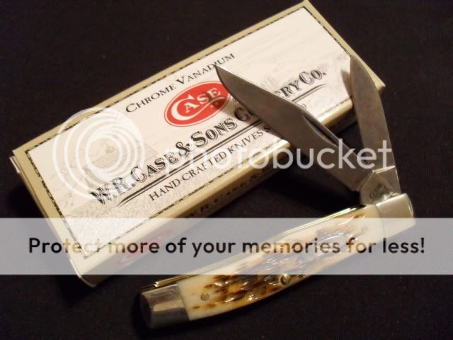

Hi all!
I love my Texas Jack in CV. I tried to make some natural patina on it but I had surface rust formed so I had to clean knife and start all over. Sorry for poor light its middle of night in here and I will take better pictures during daylight.
I did expected grey patina, not multicolored patina... But I got patina that has bluish green, reddish-purple and yellowish shades depending how light reflects.
I used combination of warm vinegar and citrus juice. Its hard to believe this is same knife i got around 14 days ago.

Now here is how my blades look after few hours of coating and drying. the forced base patina. It looks now so much more than when it was mirror shine blades two weeks ago. This is good start:
