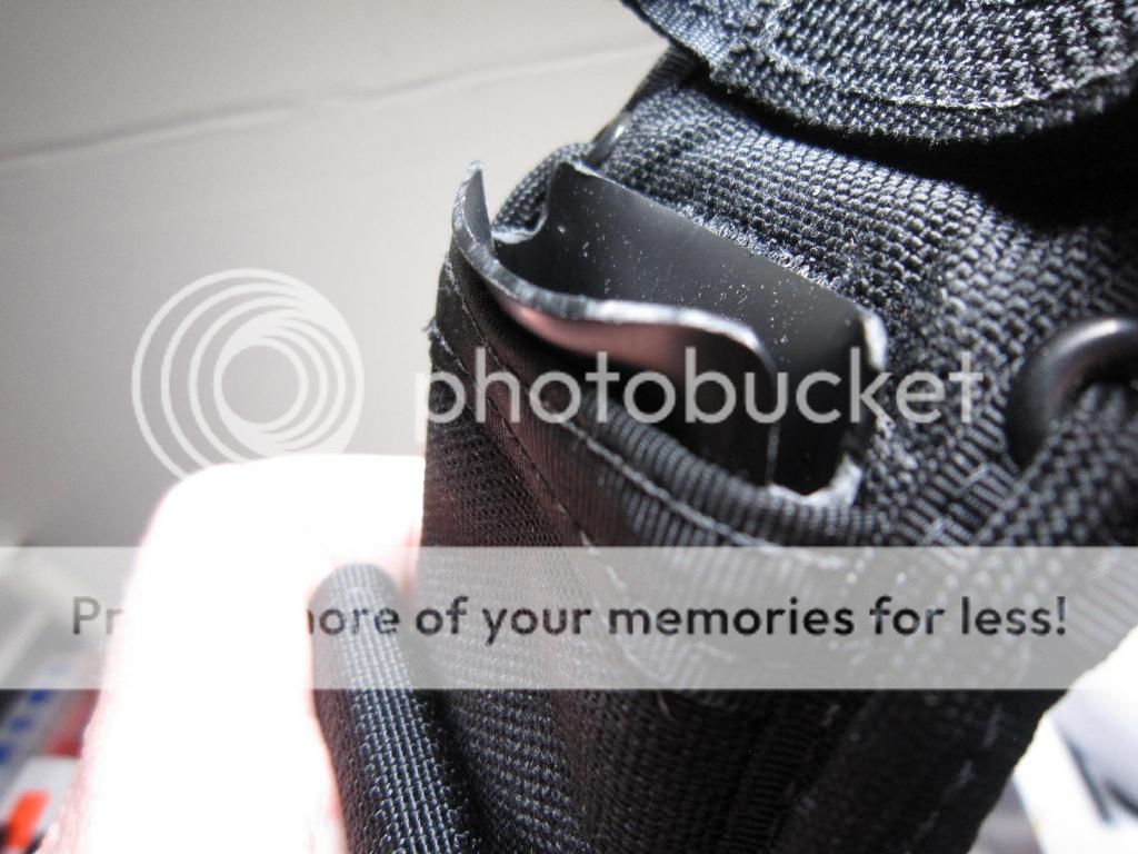

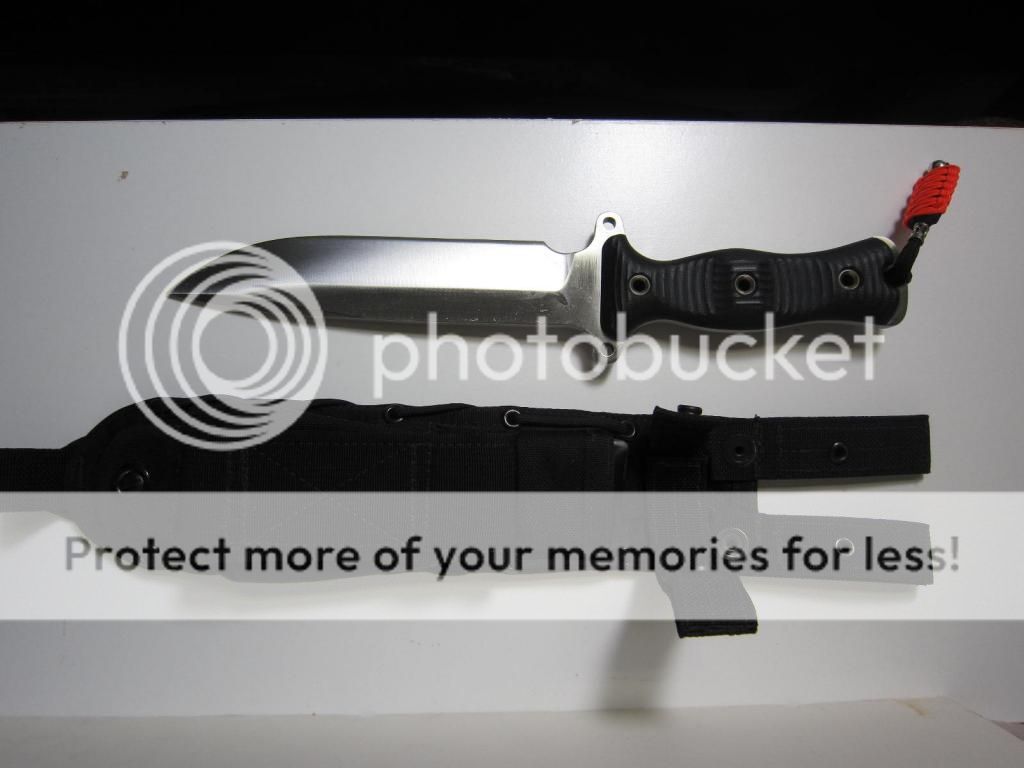

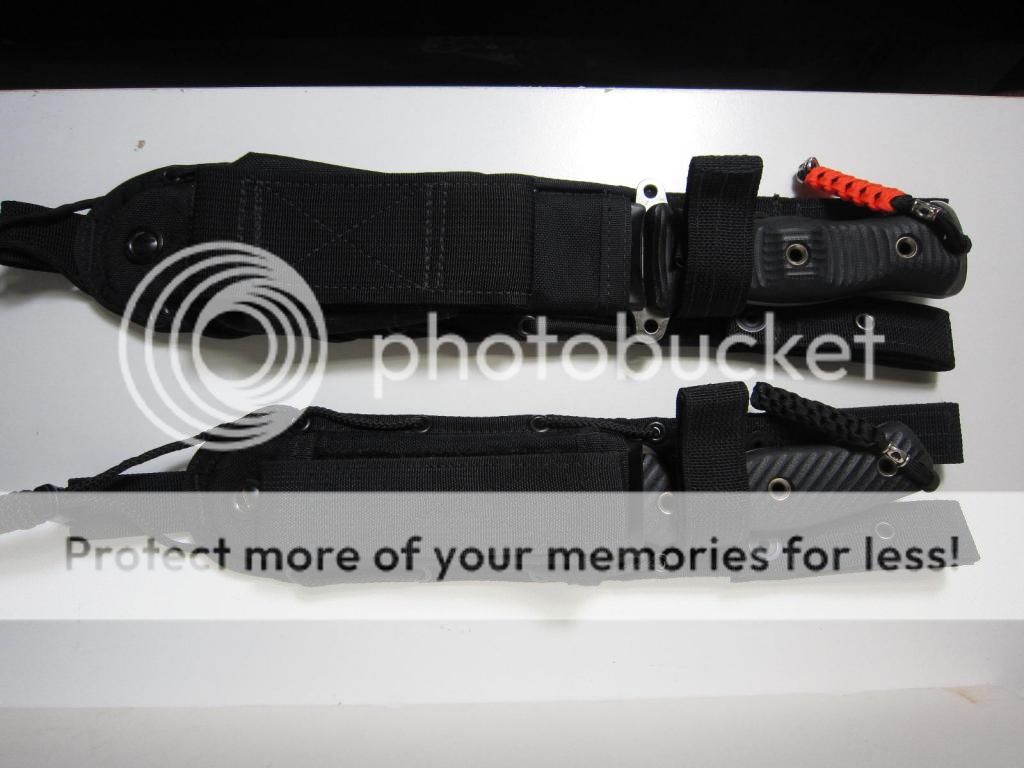

Here is a few:
TG in Long and RMD in Short
Dremel out the ends of the liner so the TG sits down in the liner better instead of sitting on top of.

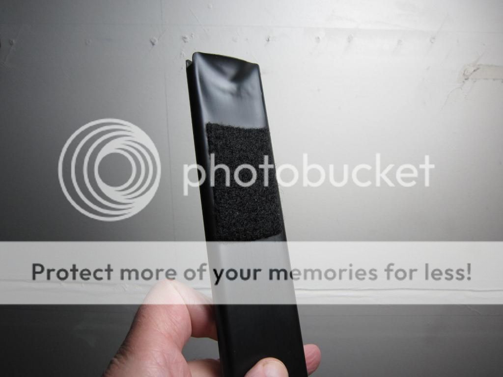

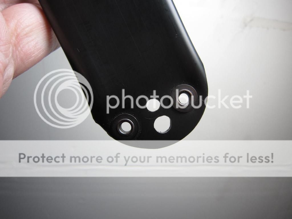

Now for those who don't know, SPEC-OPS has changed there sheaths in that they are not using a screw to secure the liner in the nylon anymore. They have gone to a patch of Velcro on the liner and down in the sheath. I not to much of a fan of that but I'll still buy and use them. the 2nd pic after this note shows how they are using 2 each rivets in the liner. The other 2 holes I put in so I could adjust the liner up of down as I see fit. Once I cut the cross guard shoulders out I wasn't sure the top hole would work so I put another one in and really didn't need it. The Liner was plenty long to accommodate the Team Gemini and the top hole was perfect.

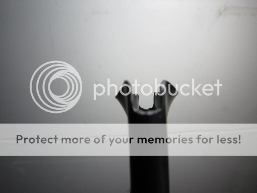

Here is the cut out in the shoulders that I was talking about

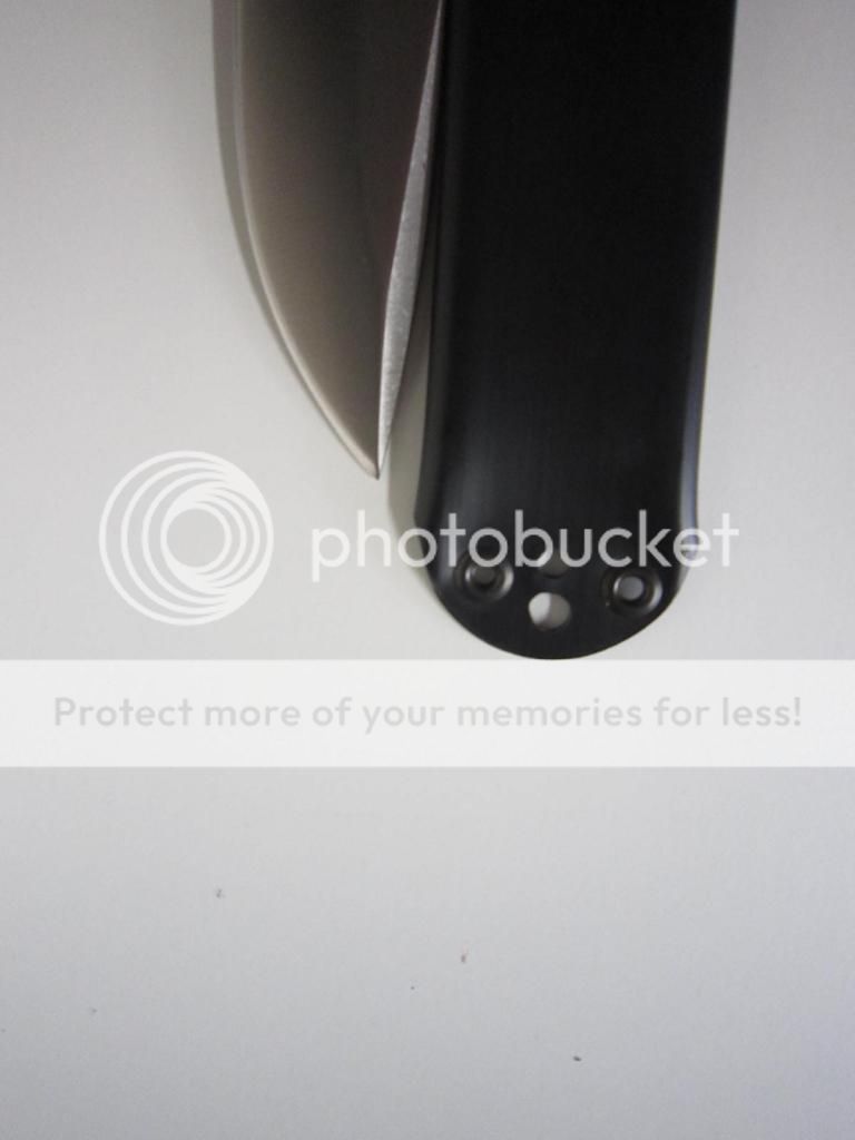

You can see the blade tip is no where near the top hole I drilled in.
