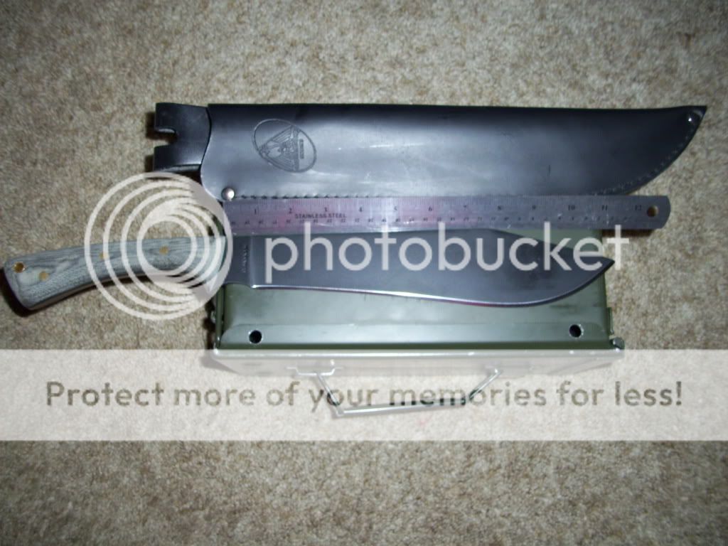

Here is a pic of my recently customized Condor Boomslang.
What it looks like now.
What it looked like before.
http://i753.photobucket.com/albums/xx176/fortytwoblades2/Misc Machete Stuff/CIMG8990.jpg
I need to polish it more, but its been re-profiled spine and edge both.
when I was sanding it down I noticed that since I was carefully paying attention to the edge as well it was getting sharper and sharper.
Sorry about the crappy Pic we still don't have a proper camera since my wife's camera died.
I didn't have stripper in the house when I decided to take the coating off, I sanded it off.
I did a wet high grit sanding but I cant seem to get it mirror finished, anyone have any good ideas/pointers ?
I was thinking about using a weak acid to clean the steel then re sanding with 2000 grit, any input ?

2000 should get it pretty shiny. I'd say look into a buffing drill bit before you remove too much steel. Very cool mod though. I didn't like those Condors but I really like what you created out of one.:thumbup:

I polished one once and It was tedious. I achieved pretty good results using sil carbide sandpaper. It was a 10 pack from harbor freight starting at 220 and getting finer. I heard the more grits you use the better the result.
Nice work. I've been fighting the urge to buy a Boomslang. Hows she working out for ya?
it takes time! 800+ grit at this point a movie and beer. finish with 1000 - 1500 and some polish - But kiss it good bye when you first use it.
Uploaded with ImageShack.us
Yeh polishing looks so awesome, until its used then it looks terrible. I have done two mirror patinas with blue and mustard. Semi mirror then coated with gun blue gives a shiny gun metal type color. And putting mustard in a pattern on a semi mirror blade then washing with water and rubbing with 0000 steel wool and very lightly with 3000 give like a "ghost patina" where it shines up the patina marks and blend in with the polished blade but can be seen as the light moves

I cleaned it up some more and I think I am going to Mango patina it, Mirror finish will just get destroyed using it anyway ..lol
I like it too Twinsticks, thanks for posting the pic, now people have a much better pic to see what I did to mine.
Tomchung, Nice slide on your Tippmann TPX (I'm a TippmannHead as well as a beckerhead lol). I think I'll have to pickup a boomslang sometime, It looks like a great blade, reminds me of the Fiddleback Forge machete.
Yeah I know she's gonna lose all that nice, mirror-like shine the first time I use her, but I figured she should atleast get the chance to be pretty once. It's just steel after all, and I can patina, polish, or paint it back to whatever i feel like. I've got one side shined up progressively to 2000, I think my next step is polishing compound to get it literally mirror-finish. It looks pretty gorgeous right now, polished blade and swedge, and a mango/mustard patina along the upper portion. I'll try to get pics up soon.
