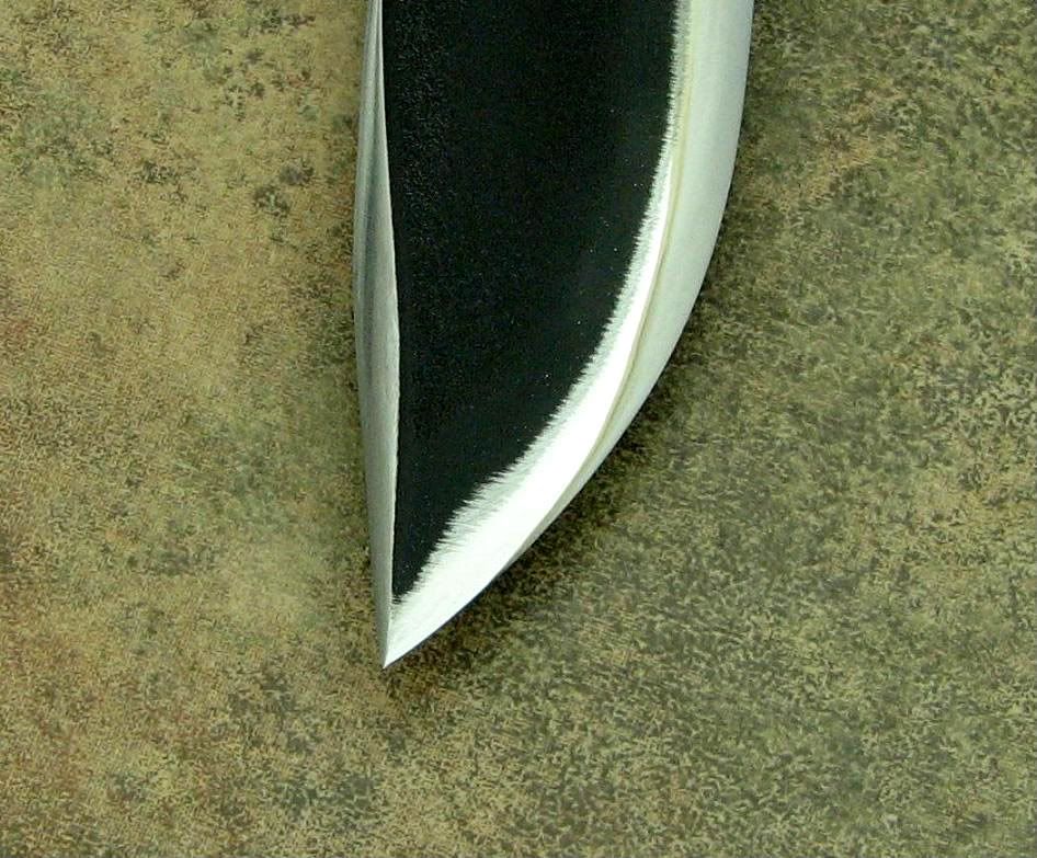

Mods: Drastically thin edge profile. establish zero edge convex. Sharpen swedge. Smooth handles and polish exposed spine and handle.
Very useful knife. Currently my favorite Busse.

That looks great. Did you just use stones, sand paper and stropping?...or were power tools also involved?
The primary edge looks nice & sharp...but will the sharpened swedge actually cut?
Well the first 3/4 of a inch or so is razor sharp. It will cut but the primary purpose is to aid in penetration of soft material. I can stab this a lot deeper into a phone book than I could when it was stock. Is it a big deal? Nope. But I did want a more effective tip.
I started with a 120 grit DMT Extra Extra Course diamond stone for the stock removal. There was a lot of metal to remove to make it into the knife I wanted. I should have measured it, but this knife came really thick right behind the edge bevel. I gound it way back until I had a nice flat V-grind edge all the way to the edge with no micro bevel. It would shave hair at 120 grit.
Then I move to 320 grit diamond then 600 grit diamond. By now the natural slop in my sharpening stroke was begining to introduce some convex. Keep in mind that I intentionally re-cut the edge bevel thinner than I wanted to end up with, to allow for just this effect.
Next I went to 600 grit sand paper backed with leather. Here I spent a good bit of time forming the final edge profile and getting rid of scratches. Also the convex profile now fully forms from the natural give of the leather backing. I jumped to 2000 grit paper to bring out the polish.
The last step was 9000 grit paper to refine the very edge.

And what about the sharpened swedge?

Thanks...Just wondering if you had used the stones on the swedge as well. Nice work.
ok
I got you....Internet communication is tough sometimes. :D
Yes I used the 120 grit stone to rough out the swedge until it formed a edge.
