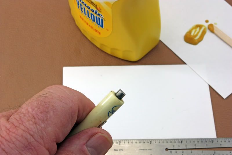

I found an old give-away screwdriver with a small 1/8 inch magnet on top end. It was not a strong magnet. I cut off screwdriver. (It was bent)

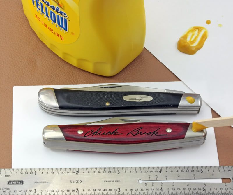

I wondered if there was some household chemical that might indicate the difference in metals but not damage knife. I tried to see if mustard, which is used to patina carbon steel blades, would even color either NS or SS. After waiting 10 minutes wiping off no chemical change occurred to surface. Maybe both got a better shine. I put if on the pivots also but no effect. Maybe someone out there knows a test without getting nitric acid involved.
I then tried the magnet on every 303 in collection, it stuck on some early Camillus made. I tried it on old 311 trappers and it stuck on the early ones with tang stamps Made In U.S.A. I had the 307 Stockmen out so tried them all and yep, stuck only on Made In U.S.A. early cami models. I had very little luck in seeing if magnet would stick to pivot pins, I would say forget that as a deal that would mess up test. (So what the heck are pivots made of ?) After finding a correct size magnet and checking some knives, when you find the SS bolster you will know the difference instantly. All springs were attractive to magnet. But do not interfer with testing on the ends.
So what does this tell us, its likely the early camillus contract 300s with Made In U.S.A. tang stamps were stainless steel bolstered. Maybe 72 and 73 as catalogs suggest. It tells me and I think you will eventually agree when you fool with it that TAHs magnet test is true. This also tells me I can cut a mustard chili dog without coloring my bolsters,pivots or blades...... This wasn't rocket science but there it is..........300Bucks
