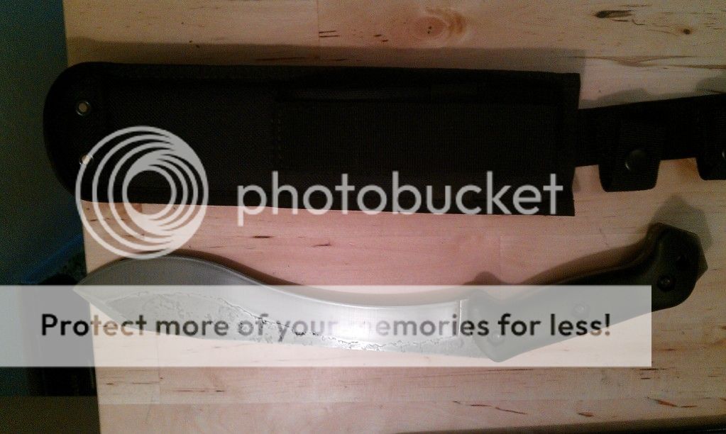

Went outside to put away some of my fishin stuff from the day before and guess what was perched against my door.......

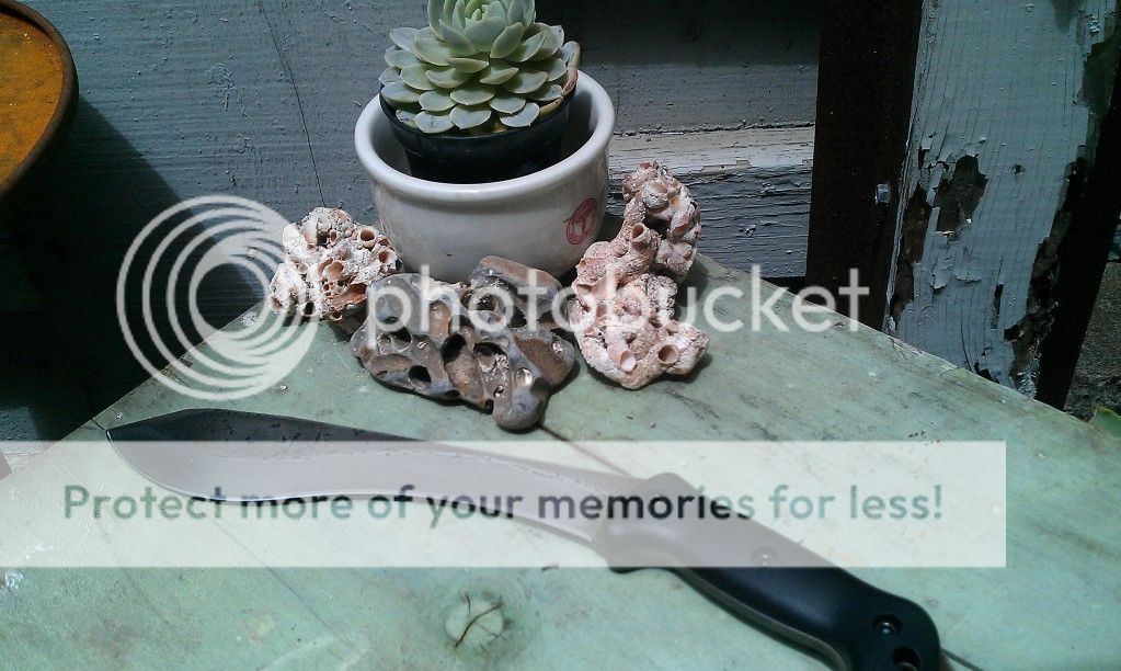

I ordered my 4 about a week ago and sent it directly over to the almighty Clich to see what magic he could work. And here are the results.....

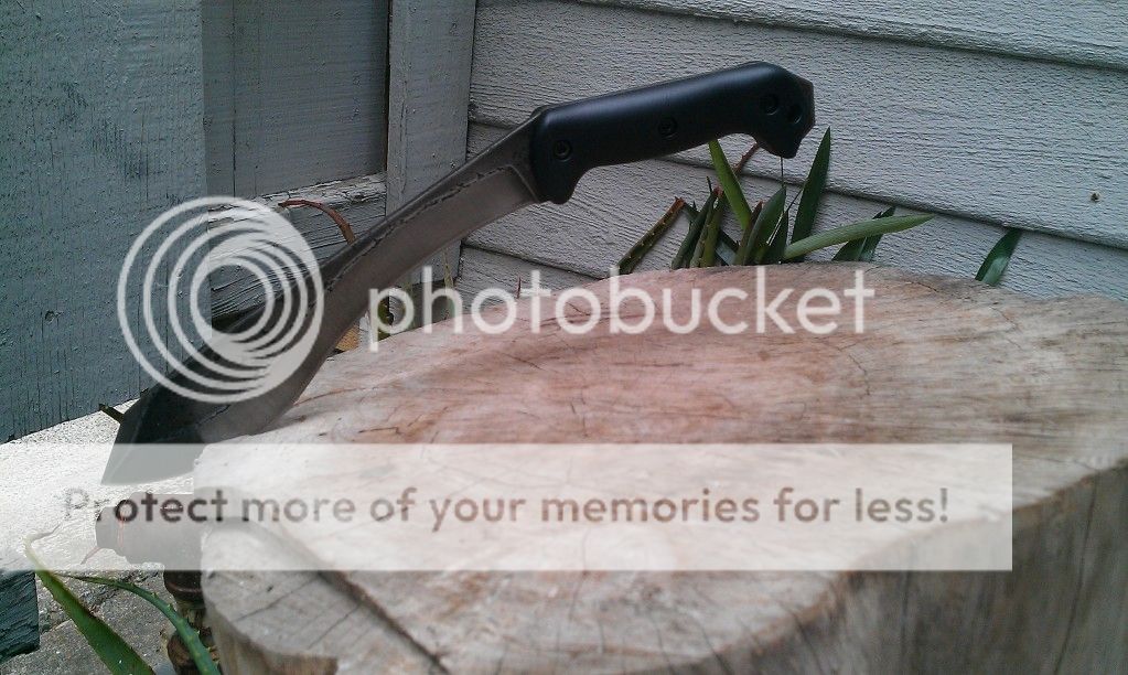

And here she is sunk in a log outside...

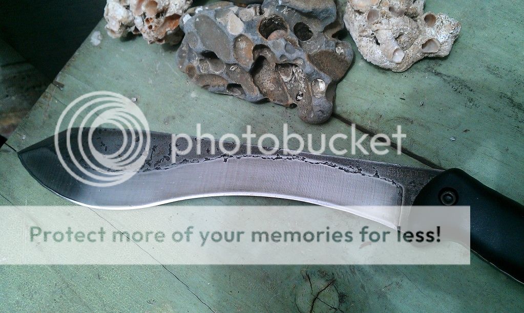

Man this thing is sharp!!!
Clich did a kick ass job on the fisk btw. He said he hit some issues and noticed an inch and a half section of the manufactures grind that had some serious issues,where the edge was rolled over, but he cleared that up apparently because this thing is probably one of the sharpest blades Ive ever owned. Im so stoked to finally have a Machax in my hands and cant wait to really get this out and about and really let the wood fly !! I plan on getting some kydex for her too in the near future as well as some handles too. Im thinkin maybe some wood scales with a real dark stain. Anyways enjoy, and a huge thanks to Clich. Your the man !!!
That is the bees knees, looks like a barb-wire border between the flat and the bevel! Nice work on the clichasaurus' part!
Glad to hear you got it and like it. Yeh it had a pretty nasty section of ripples at the recurve. Small but there and were nasty enough to not take an edge easily. I push cut serpentines through newspaper with the blade. She is SCARY sharp. Enjoy it!

I really dig that deep forged look. If I encounter any surface rust later down the road, what's the beat way to remove it.... I'm curious to see how it holds up being so close to the beach. I've applied a liberal amount of oil for the time being til it gets used
Normal rust can be removed with either a Scotch Britt pad or sandpaper. However both will remove some blue. I'd say grab a bottle of permablue and keep it om hand for the off chance you need to touch it up. And in that case blue the whole knife and sand it lightly with 220.
