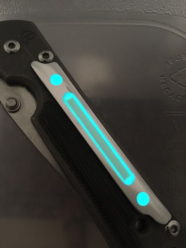

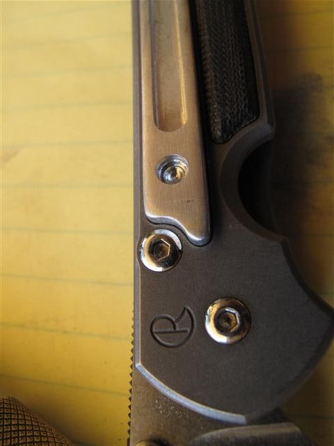

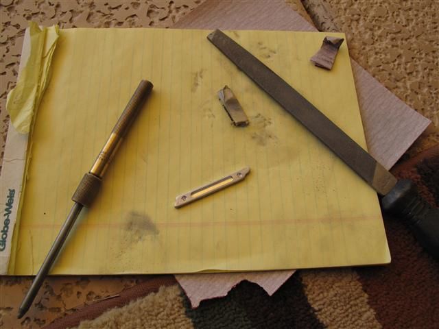

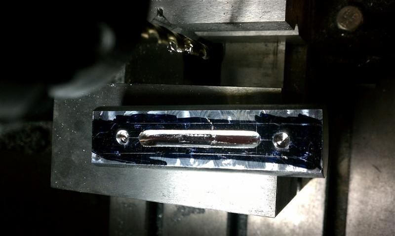

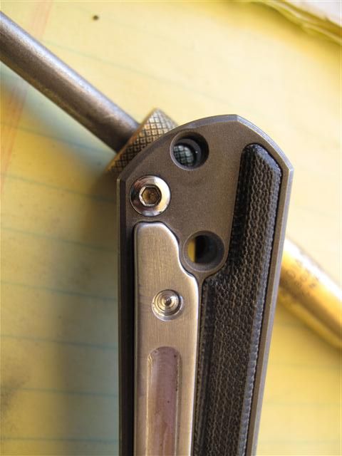

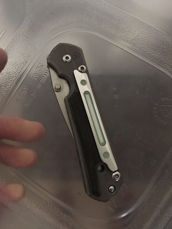

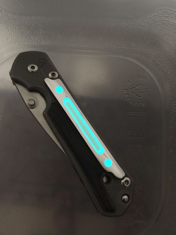

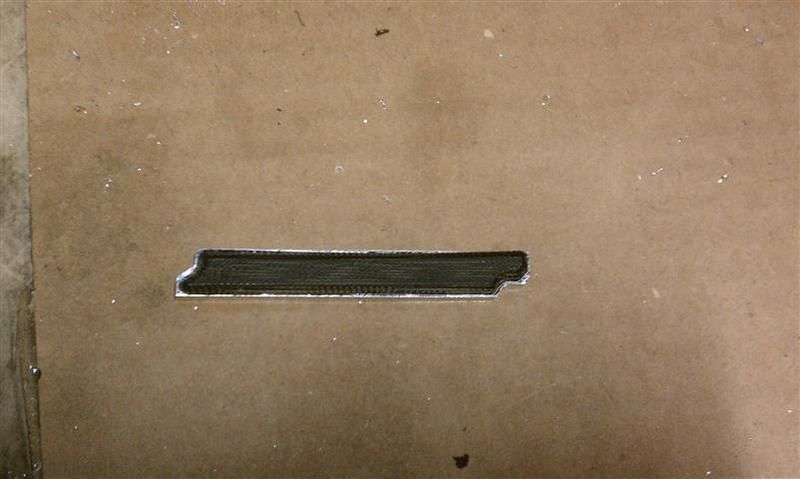

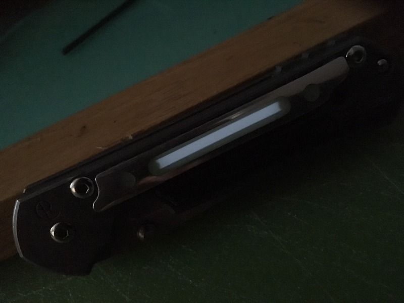

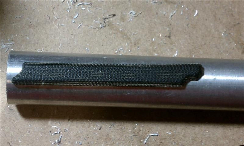

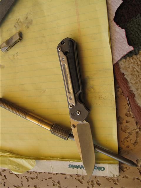

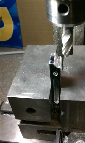

I made it about 5 years ago when I was younger, kid free, and inclined to do strange things with perfectly good knives from a micarta small sebenza and a hunk of 6061 aluminum rod stock. When I first made it I blackened the aluminum but recently I dug it out and polished it and I think it's much nicer now. There is a white tritium bar in the center and around the bar is super blue glow powder that responds brightly to sunlight (to be fair, this is technically fusion powered and not plutonium). When the blue glow dies out you're left with the white bar. The thumbstud is flattened because I find it more comfortable that way, it's still very grippy but doesn't hurt my thumb if I've been working (or playing) in water all day.
