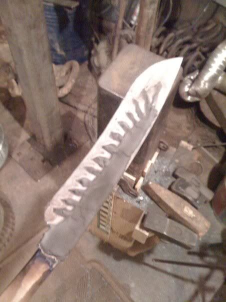

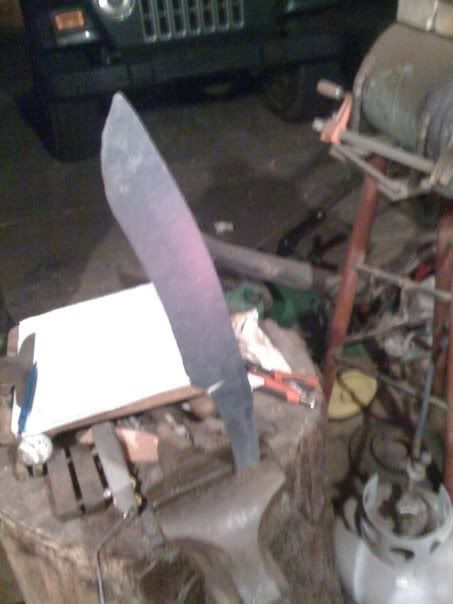

Stephan Fowler is making a large Subhilt for me which I will hopefully pick up at blade. Stephan has been kind enough to photograph the birth of this beauty so I thought I would share the pics with you.
all knives start with an Idea...( Stephans drawing..I cannot draw a circle..)( Is Ren a knife maker? no he is a knife watcher LOL...)
starting to look like a knife..

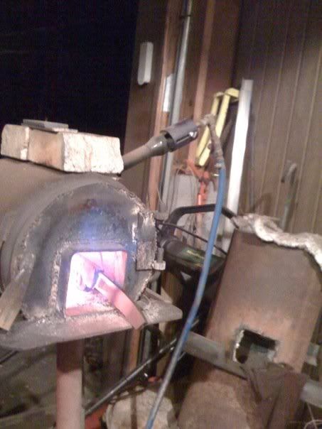

Its in the forge on low heat....
Looks like an awesome Hamon coming up..

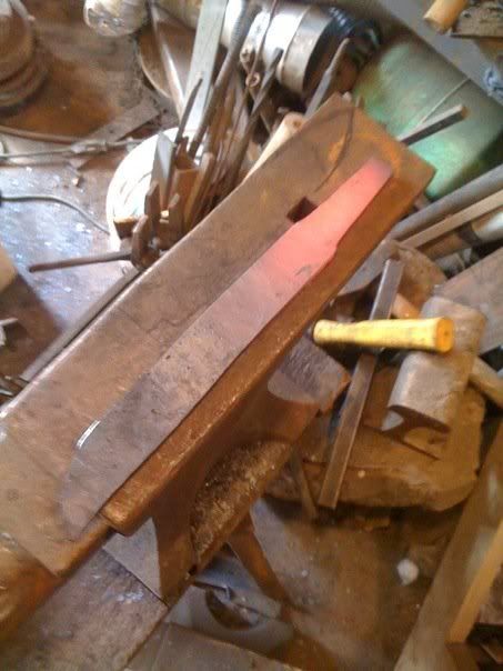

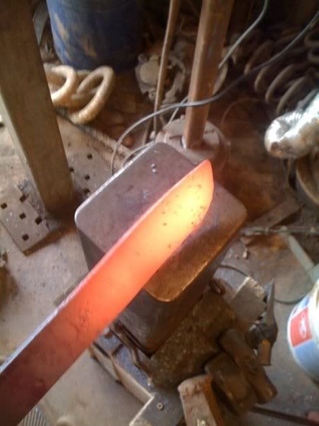

I like seeing maker's raw forgings as it's interesting to see how close they forge their raw blades to final profile and how much they leave to the stockremoval process.
Stephan's got a good looking forging to start with here.
