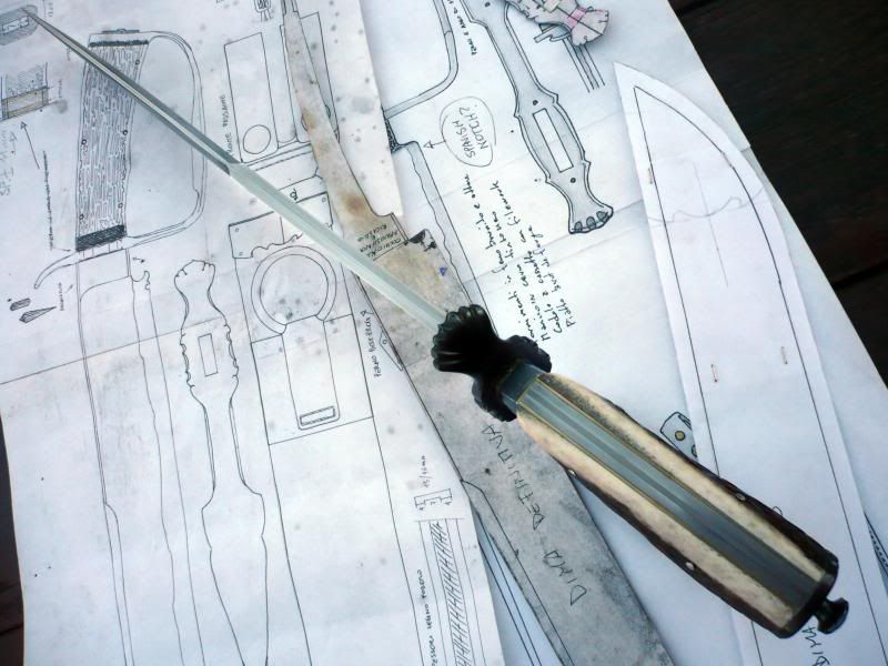

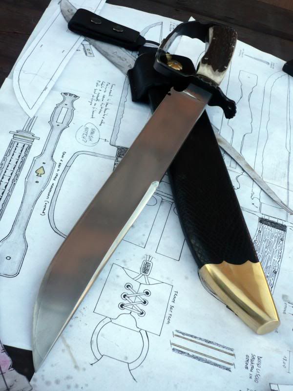

I make this bowie a year ago, when i didn't had a properly belt grinder but just a DiY store grinder and a disc grinder.
I called "The Brotherhood" intending to be a tankfullness to other knifemaker and friends that help me and support from my beginning.
Before this i've never done something similar and was a real challenge to me, i hope you like it.

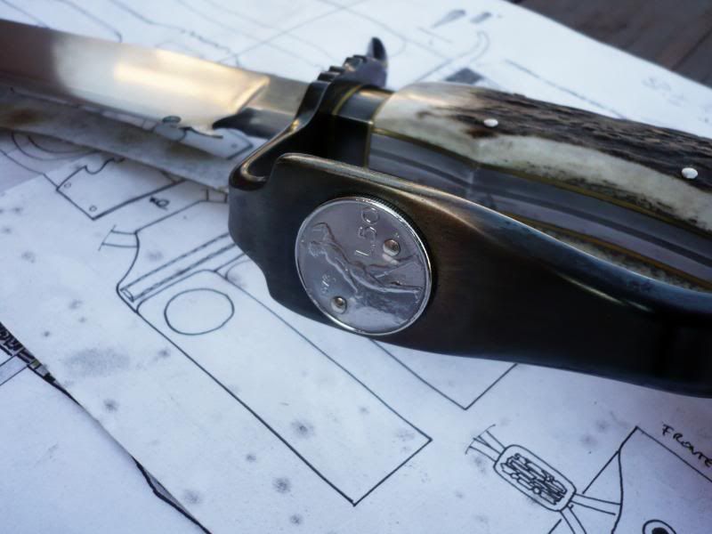

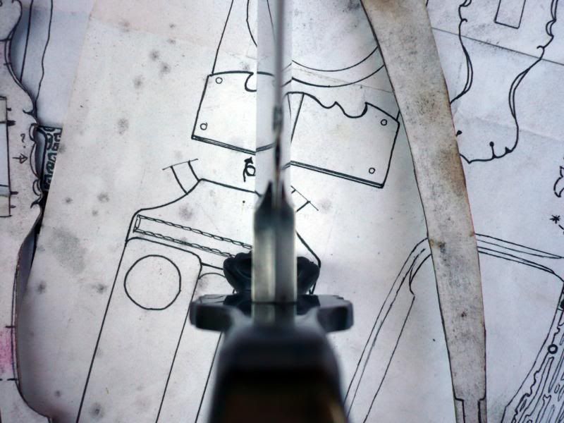

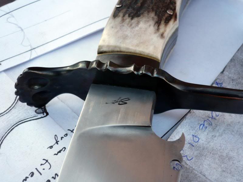

The blade is a SanMai made with k600 for sides and o1 for the edge, forged by some friends

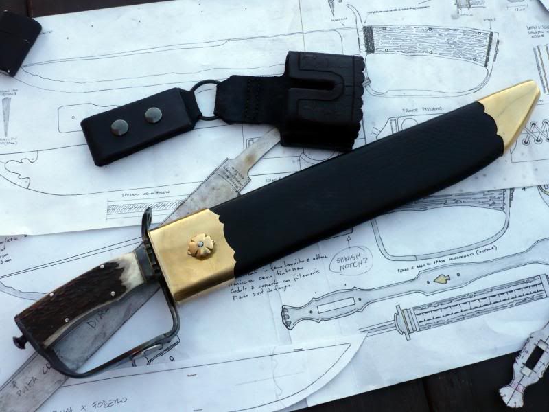

Guard ad ferrule are oil burnished mild steel and brass

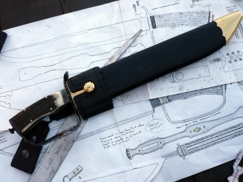

The frame handle is made with the same steel of the blade with european deer scales
The wood sheat are covered with cow leather
Tot lenght about 18"
Blade Lenght about 12"
