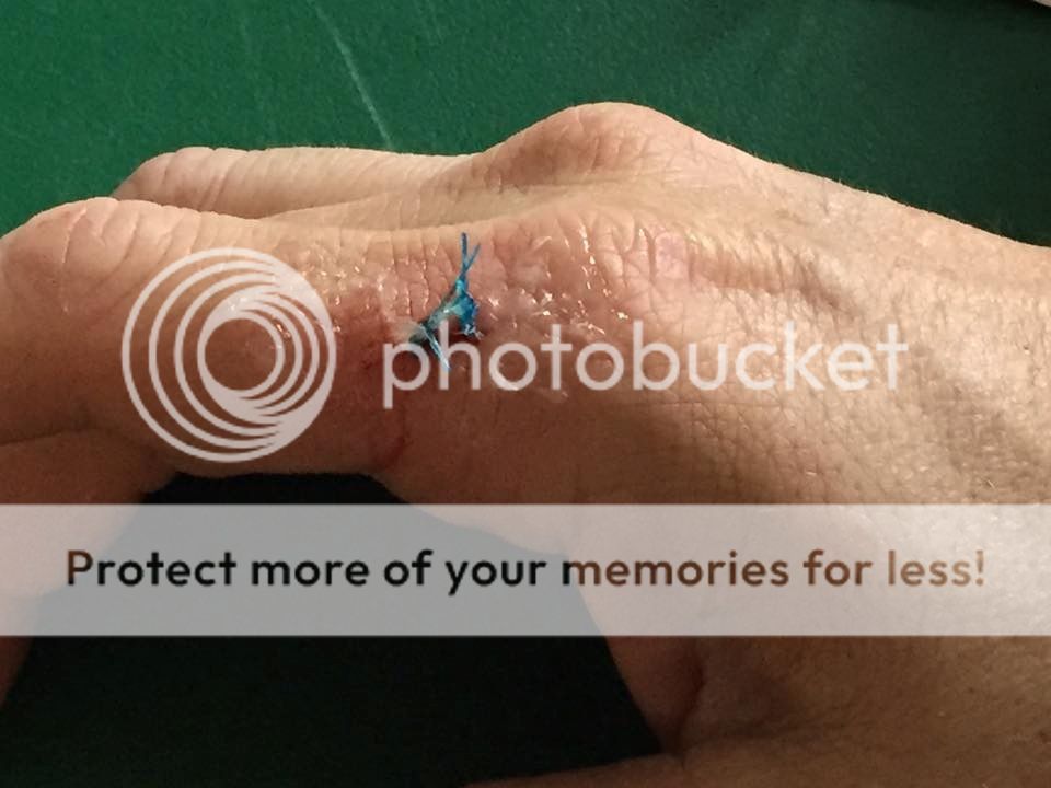

The buffing wheel grabbed the knife and threw it..
Jan 18, 2015
9
I was working with the bottom of the wheel. The dang thing was done I just wanted to polish the blade after I took off the tape. The wheel grabbed it and threw it. It flew back at the work bench and hit then bounced back at me. Somehow it hit my hand instead of my chest. I called my son who is an EMT. He came over and put in a couple stitches no pain killer.
and they say there is no use for chain mail in modern times.
Take 'er easy.

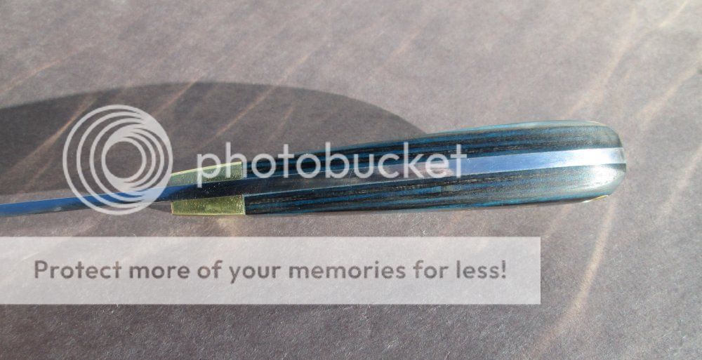

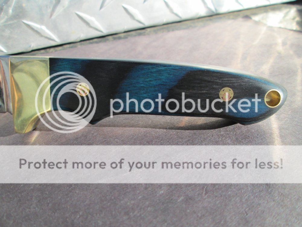

Nice knife! Good to see it survived, as did you.
