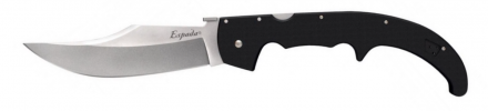

As some know, I have bought a G10 XL Espada. I think I may like to keep it as a convenient to carry large knife for use in the yard, brush, and trails. I expect the thumb disk for pocket opening will function almost correctly, as the one on the Large Espada I owned did, but that the corners will get caught on the pocket seem causing partial openings that don't leave the pocket fully. I also expect the angle of spine before the clip point will dictate an awkward deployment path. If these issues do present themselves, my intended mods should rectify both.
First I'll change the spine profile so that there is no longer a wedge of steel obstructing perhaps more comfortable pocket deployment angles. Second, I'll round the corners of the thumb plate so that it is more of a thumb disk. This thumb plate mod has improved deployment on two large Talwars for me, and one Large Espada.
Other mods I intend to make include personalizing the handle, which will involve turning the front of the scales into a choil, as I have done on some Recon 1s of various sizes, as well as a bit of going by feel.
There is a possibility that I mod the blade to bring the point lower, as I never find myself wishing for a higher point. I don't do any skinning or game processing so far, and a lower point better serves the type of brush clearing I can see a knife like this being useful for. Along with, probably, thinner geometry.
If I bring the point lower, I'll want to reshape the handle accordingly for the closest possible blade to handle length ratio, which is already grossly skewed in the wrong direction, both aesthetically, and functionally, in my opinion. Since less handle sticking out of pocket is less to grab, the trick will be doing it without compromising speed, security, and confidence of deployment. A fob could work. Anyway, I am not yet sure I'll lower the point, but if I do, I will want to preserve some of the vaunted Espada blade length. So maybe a large Spyderco Militaryish style of pseudo clip point, like the Large Espada I did a while back.
More to come, once the package arrives.

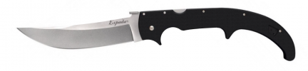

Those following my shop thread have seen the beginnings of the work on this knife. And now here's a look at the first iteration of the mods. Maybe the last? We'll see. But I will make more time at some point to put this to work and report back.
I can say that I was right about the expected difficulties doing a rapid deployment. My very first attempt was a fail due to partial deployment that wanted to remain stuck to the pocket. After my mods, I can deploy with consistency, and had to actually distract myself during deployment before it failed again. And the knife closes one handed now, as a good modern folder should.

I've discovered that if I decide to do a straight spine after all, it'll only lose about 1/4" of blade length, if that. That means I wouldn't really need to shorten the handle.
Also, it bears mentioning that I didn't consider how huge the tang on this knife would be, which is why I didn't open up the index finger groove like in my concept images. I would have just ended up exposing the tang, and thus not really adding any grip real estate.

I was wondering about the above actually - the tang of the Talwar (medium and XL) is the same as the Espada. To increase the protection/curve of the finger guard you’d need to cut away part of the tang…
Yes, and that's not something I'm prepared to do.
It would adversely affect the closing action as well.

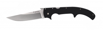

I changed my mind and withdrew my Espada sales post, and modded it further today. Full regrind to actual knife geometry, and a proper Navaja handle. I didn't realize it until I removed the subhilt, but the tacticool Espada handle was just getting in the way.
