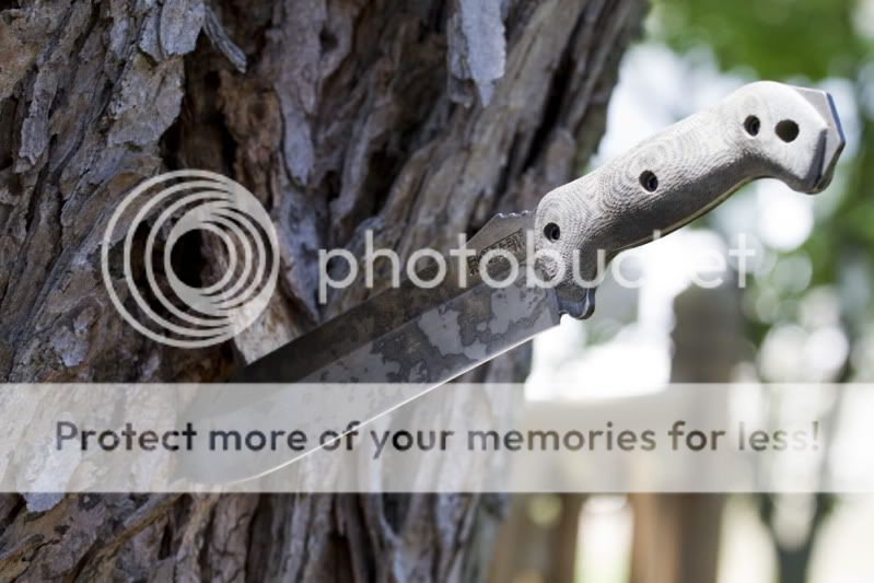

The king has arrived! Stripped, patina'd, ready for action.

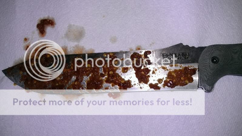

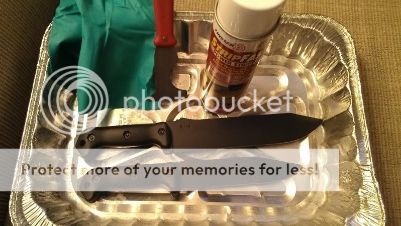

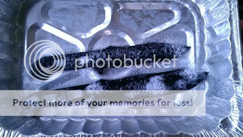

I finally picked one of these up and immediately went to work on it. I found this spray stripper at Menards. It worked, but no nearly as good as Jasco, IMO. I'll go back to Jasco gel or spray in the future. So, the 9 and the 7 went in the bath, came out mostly stripped, were sanded down, and then I put the patina on the 9. I used a Vietnamese chili garlic sauce, purely for the fact that it had a couple of tablespoons remaining in jar, which was well over a year old. It turned out nicely, I'd say!

Damn n8, that looks nice...how long did you keep the chili sauce on there?
It was on there for about an hour. After that, I wiped it down, rinsed it off, and oiled it with some canola oil.
Sweetness. Whats the 7 look like? I have a new fondness for that ''lil brother''.
I really like the micarta! Nice work.
