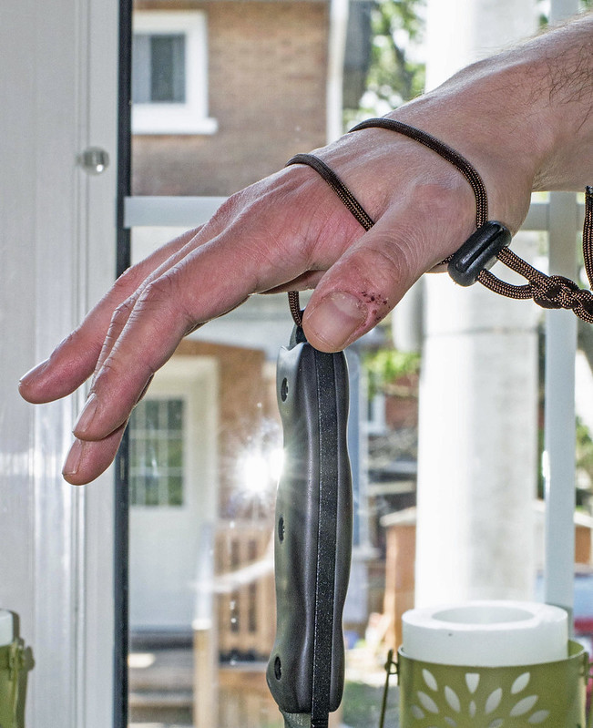

I am going to post this for a second time (somewhere else in this forum but I don't remember where) because I think I can do a better job this time and also because it is a very misunderstood subject and because it is misunderstood, there is the possibility of serious injury if used incorrectly.
Somebody previously said he didn't care for the thumb thingy...well here is the thumb thiny and I urge you to try it.
The major problem is that people think the lanyard should go around the wrist, so that if you are chopping or batoning and the knife slips from your grip, it can be easily recovered and controlled. Nothing could be further from the truth. If you doubt this try an experiment, but do it carefully and do it with not much vigor. Go through the action of chopping with the lanyard around your wrist and then let go...not on the back swing please...shudder!! If you are careful you will note that the knife swings dangerously with its sharpened edge going places you don't want. As another person posted earlier, your muscles will get tired chopping sooner or later and you probably will let go of the knife!
Now try the following way.
Loop the lanyard over your thumb as you see in the first shot. Make sure the back of the handle is facing in as seen here.

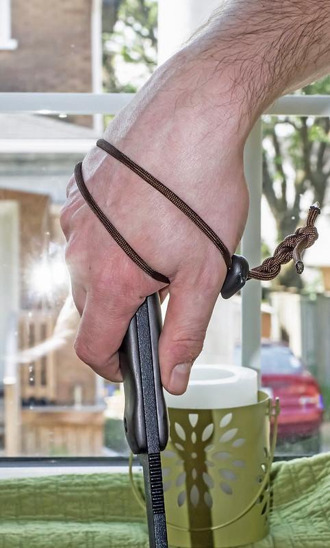

then rotate your hand down to wrap around the handle of the knife keeping the lanyard looped over your thumb.
Now snug down the lanyard slide button until you have the lanyard firmly wrapped around your hand.
If you do the exercise again with this grip, you will find when you let go of the knife, that your control is greatly enhanced and once you get it just right, you can make the knife swing back right into the palm of your hand. Done this way, you will never lose your knife flying off into the brush or worse, the snow and the chances of you injuring yourself is almost nil.
So if you have not used a lanyard because you don't trust them, now you are free to put one on your knife. I have a friend who does a lot of wilderness winter camping and he has a lanyard on each of his knives when out there and he uses this method, which I am happy to say I taught him. For my part I must credit Mike Stewart of Bark River fame for revealing this method to me.

If you are chopping and the knife slips your hand, won't the thumb method suffer from the same problem as putting it around your wrist?
If you use the method I describe above, there is almost no chance you will lose control of your knife. If it is done correctly, the lanyard is too short for an uncontrolled swing and it is anchored by being hooked over your thumb. If you follow the directions, the knife will swing back into your hand in the correct hold position.
Try it yourself and practice a bit, you will see what I mean. :)
