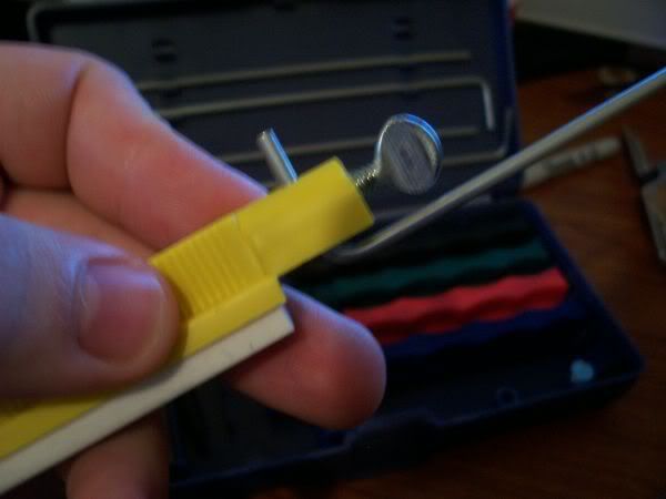

Maybe I have the rods in upside down?? If the grit side is facing down does the rod leg face down as well or come up from below? I just realized that may be my problem so I'll try that tonight but any tips and techniques are welcome here.
When I use a Lansky (generally only to remove a lot of material on a new blade to create the bevel I want) I put the rod so that it comes up from below and I insert it as far as it will go until the 90 degree angle of the rod stops its insertion. I do this simply because it always maintains the same angle of the stone in relation to the guide holes (I don't have to guess how far the rod needs to be inserted).

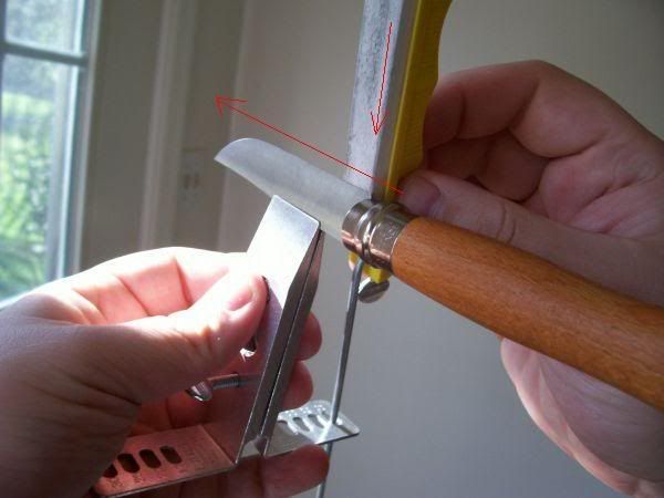

I have a lansky and I've been using it for years. Lets see if I can help.
The rod comes up from the bottom. Thats probably why youre not getting the results you want. I have put every knife imaginable into my Lansky, including the widest of kitchen knives, and have always been able to find a suitable slot.
I dont think that the push, lift, pull is a very good technique actually. I saw that in the instructions and was like :jerkit:
Instead, I take the stone and make long strokes along the edge, starting at the bottom of the stone and pulling down as I run the stone toward the edge in one full stroke.
Here are some pics to help.
This is the way I use my Lansky. I just hold the thing in my hand.
Go across the whole edge and pull the stone down at the same time. I do about 5 strokes.
Looks dangerous, but it isnt. Just flip the thing over in your hands and put the rod in the slot for the other side, and drag it across again for 5 or 6 strokes.
Hope this helped. I love my Lansky. The Opinel that I'm demonstrating is sharp enough to shave your face with thanks to this system.

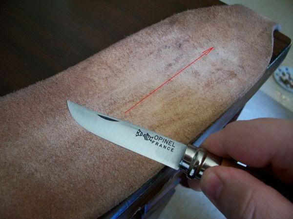

Oh and here's another tip. After youre done with the lansky, Get yourself an old leather belt, or scrap piece of leather and strop your edge. This will polish the edge and get rid of any burrs.

Yeah, I have been wanting to get a strop and def want a cheap version like a belt. I only used the coarse one last night to try and remove a nick in the blade. The oil cuts down on abrasion which in its essence is what sharpening is so its definitely counter productive. Cleaning them tonight. I appreciate the help!
