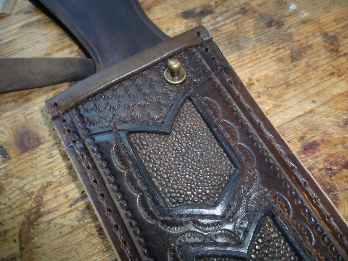

The making of a leather sheath with inlay by my wife kiara ( graphic sequence)
Apr 26, 2007
314

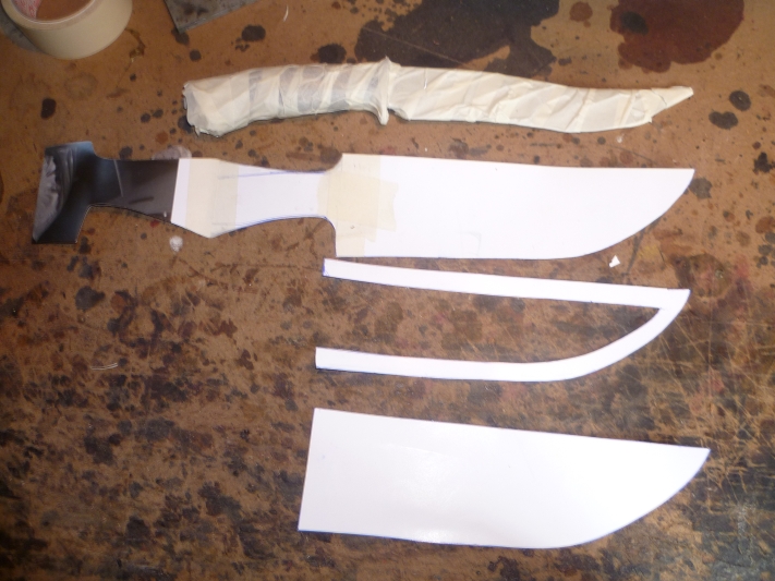

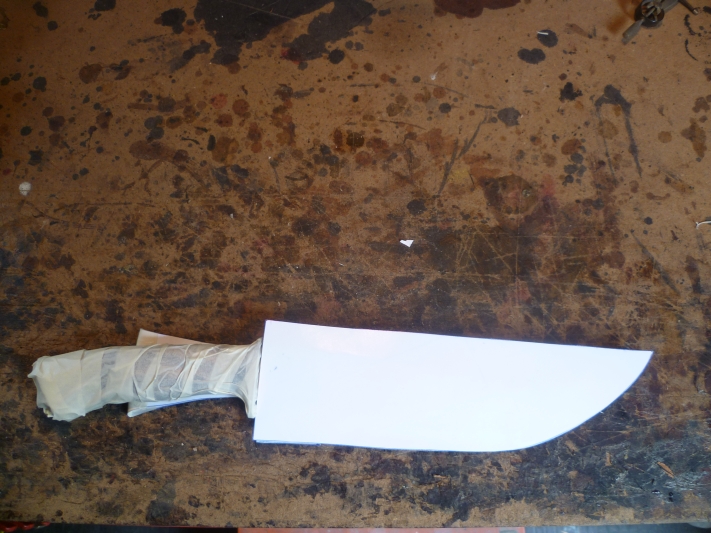

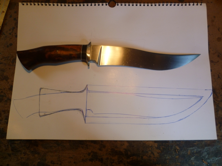

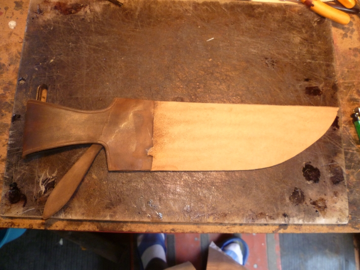

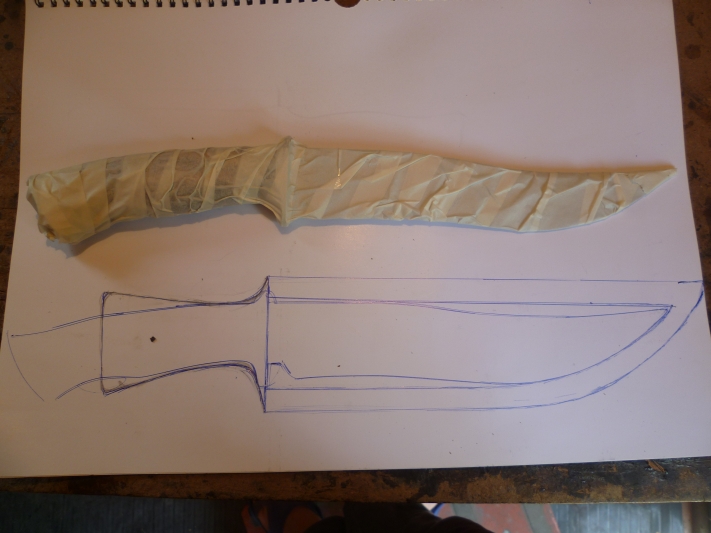

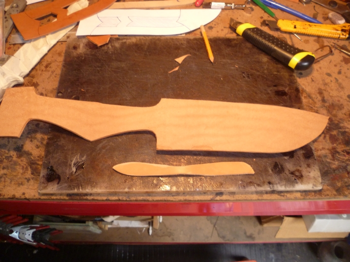

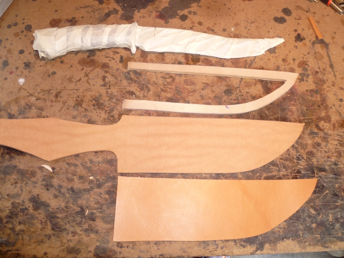

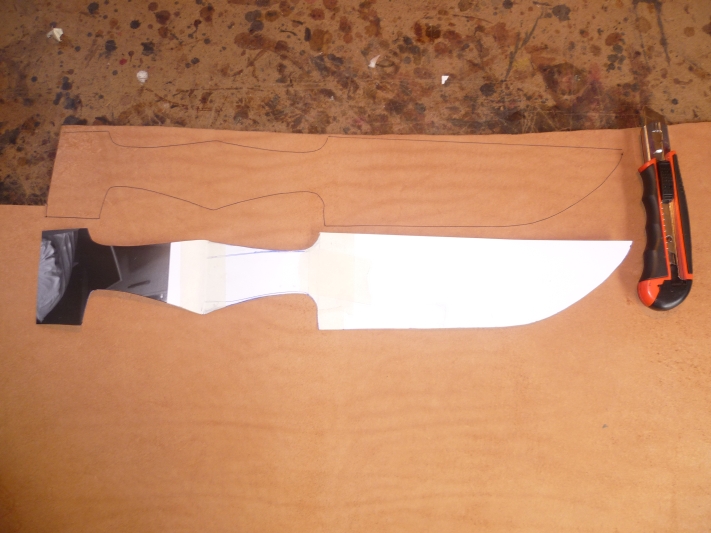

a model o the sheath made of hard paper is shaped

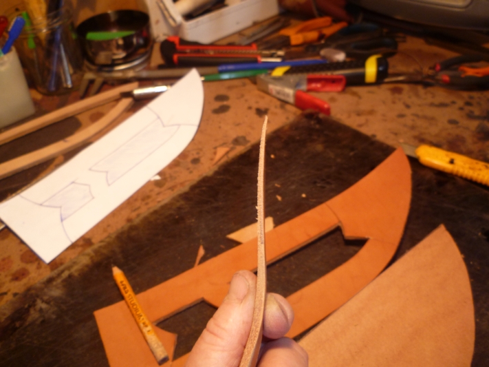

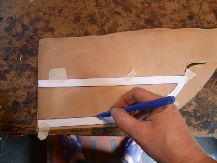

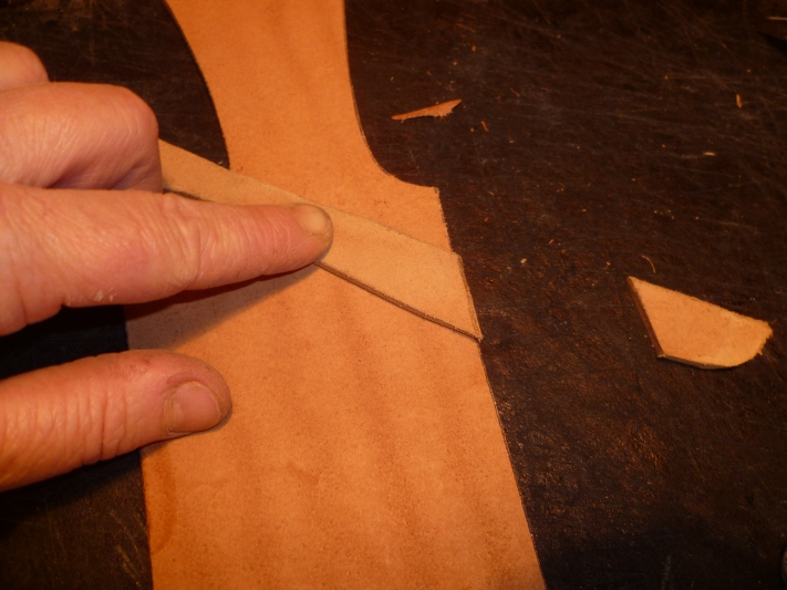

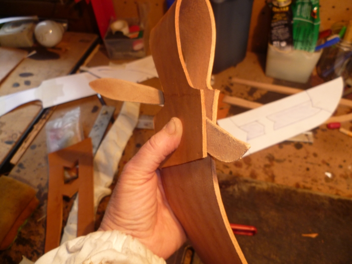

the welt

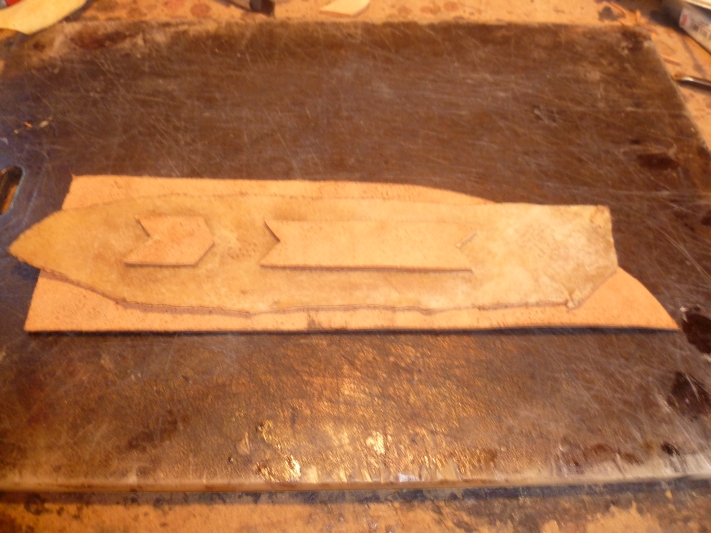

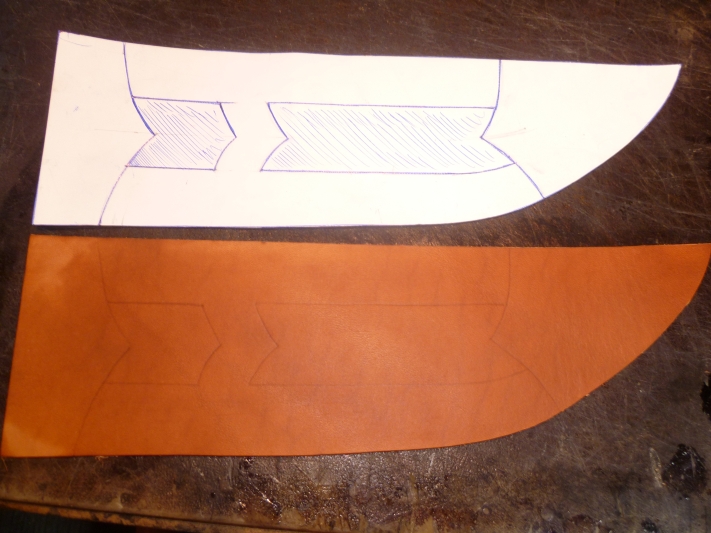

from paper to leather

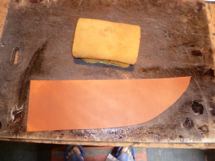

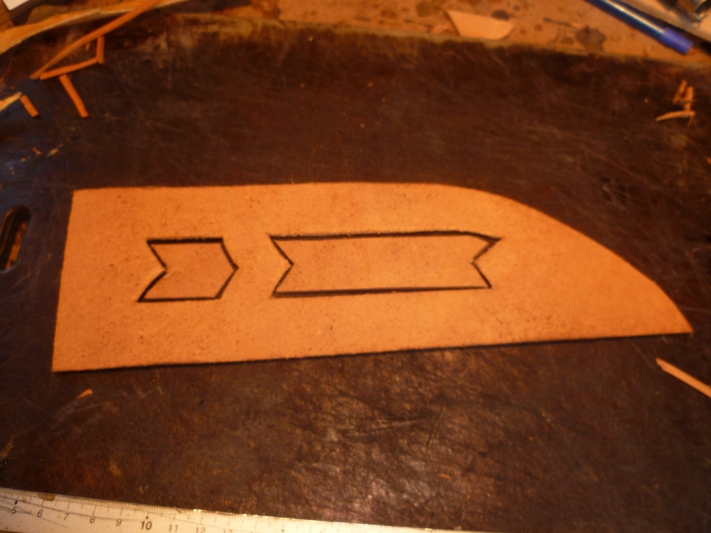

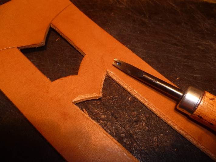

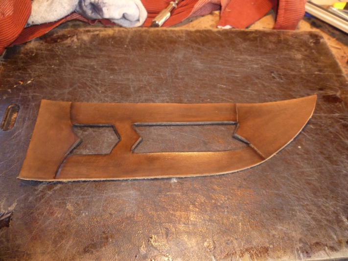

dampen the leather with water in order to transfer the motif on the leather

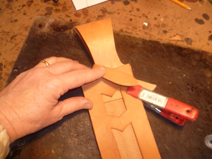

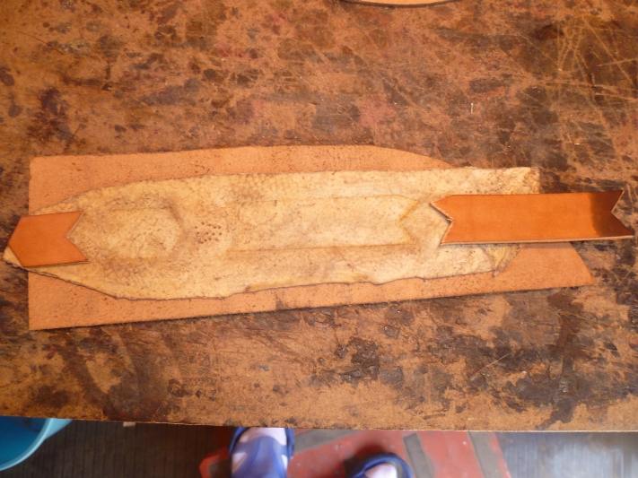

preparing the strap

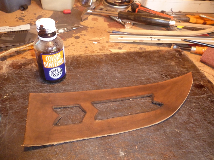

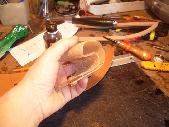

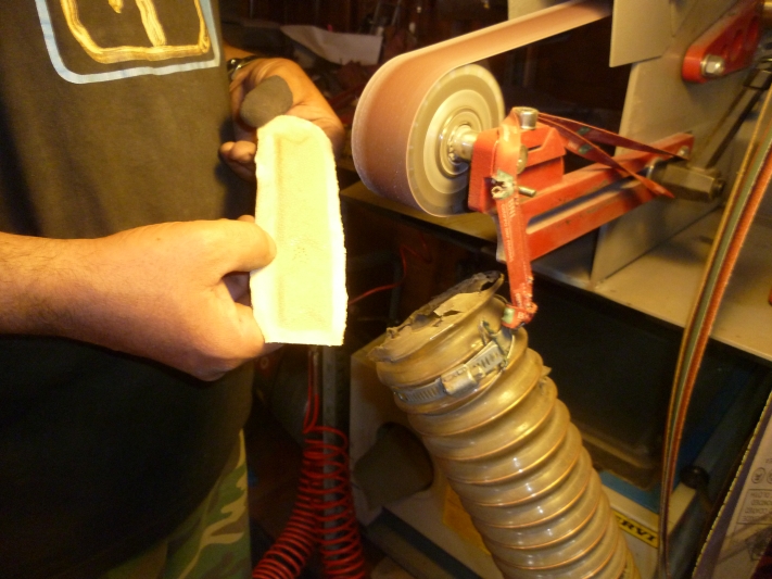

in order to soften stingray leather sheath and make workable sink it in water nightime

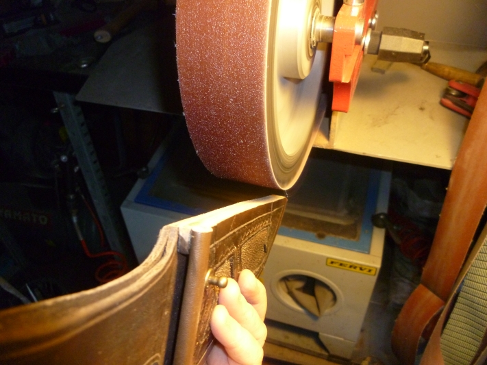

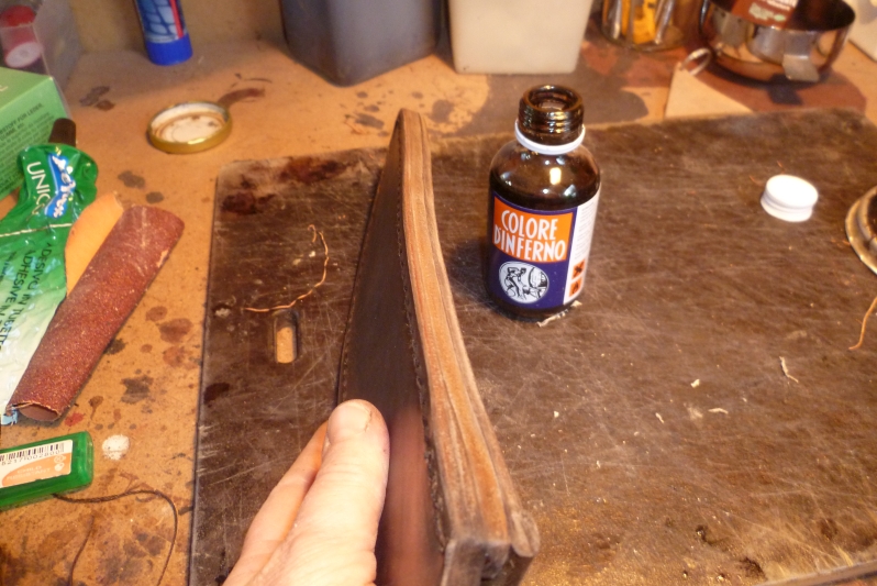

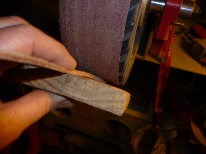

polishing the profile
url]

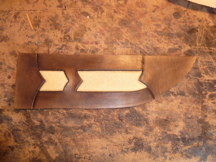

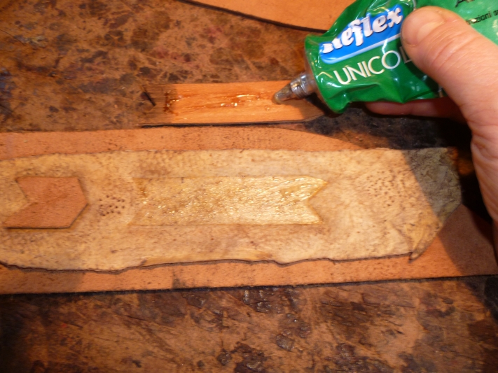

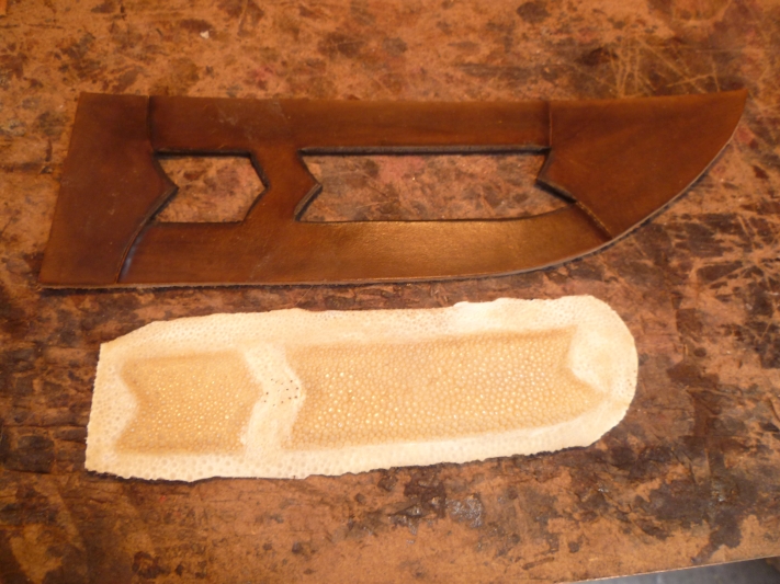

Styngray leather is very hard to be worked , so you must sand it to remove the keratin layer

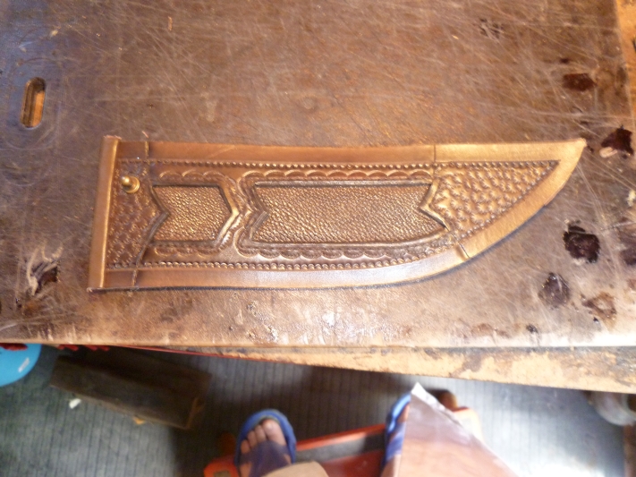

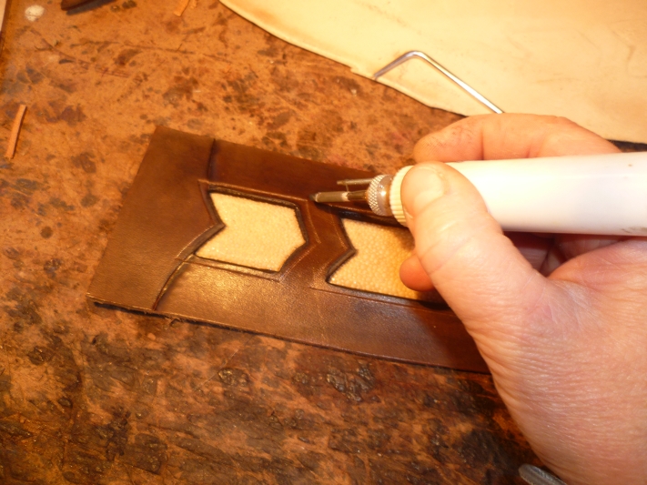

Enlarge holes for sewing

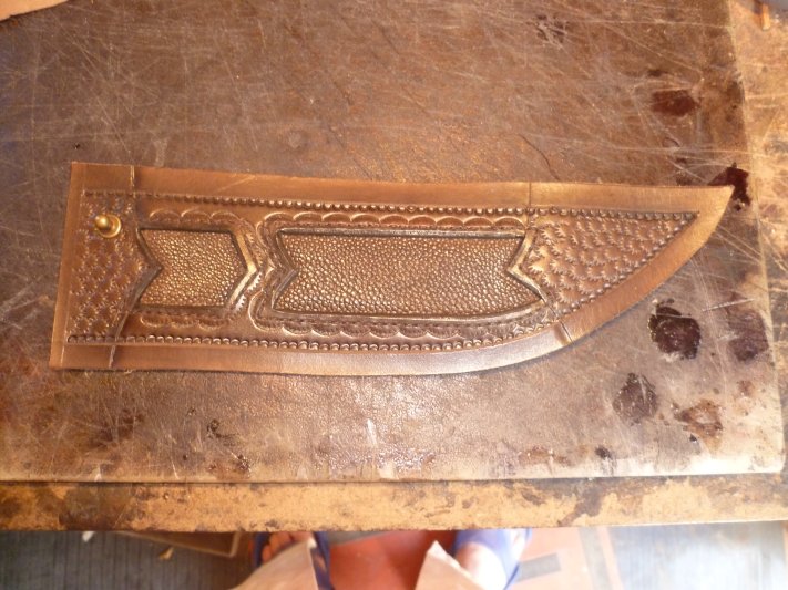

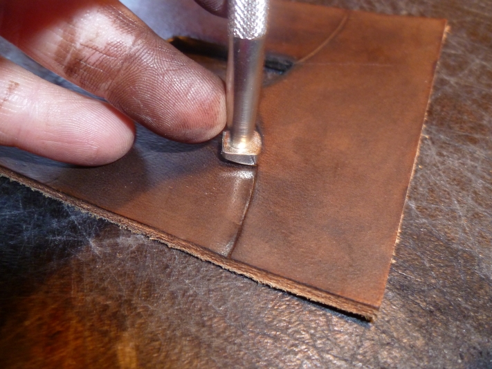

decorate with punch

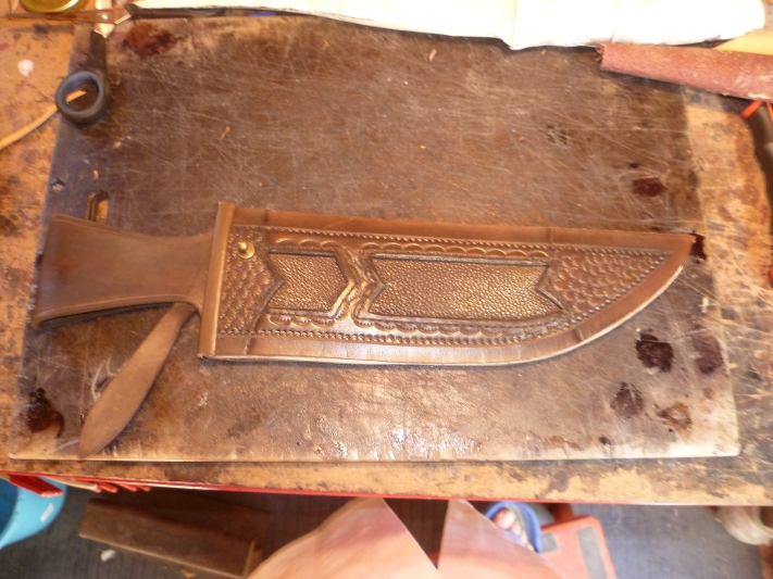

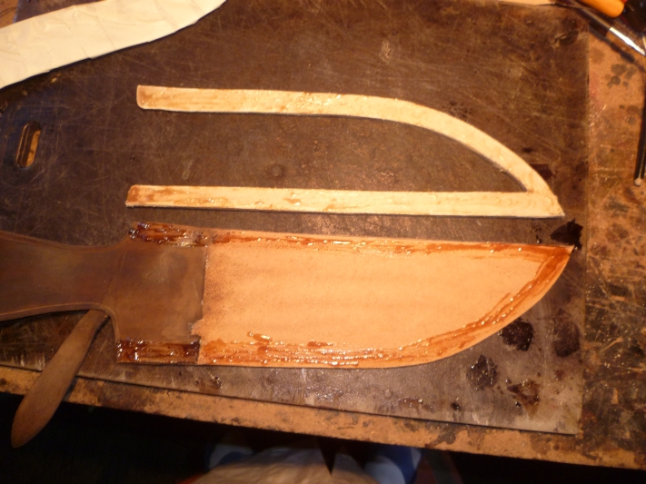

making of upperboard and internal cover
http://www.mimportaunasegapuntozeb.com/wp-content/uploads/2012/06/P1020999.jpg

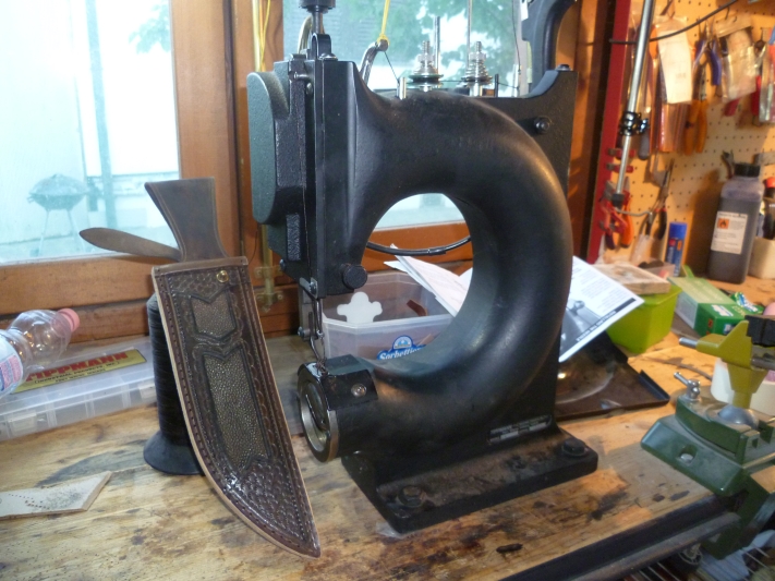

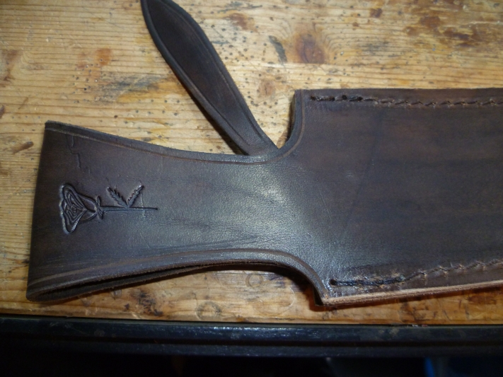

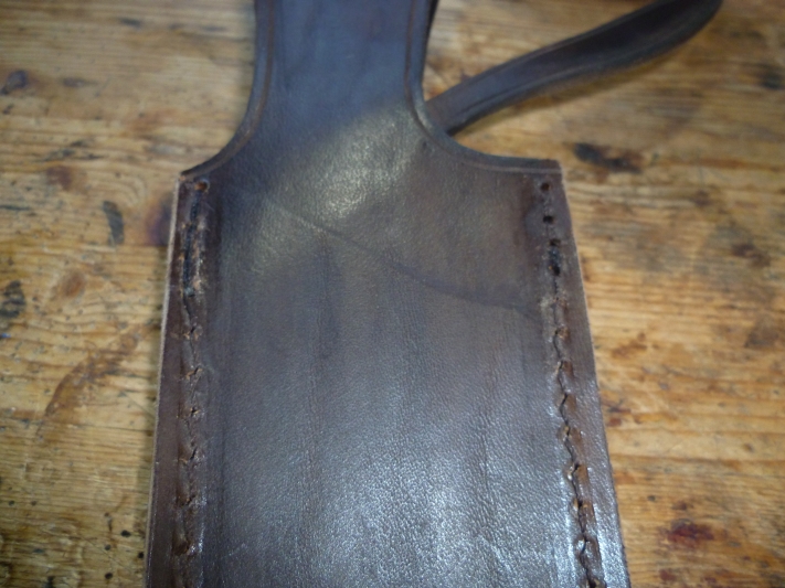

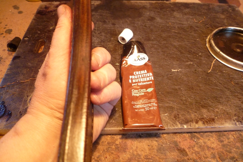

finishing external side of the sheath ( smoothing and polishing)
The sheath is done
