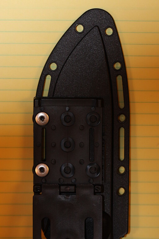

so, tonite, i was fiddling with the second gen BK02's sheath system
did you all know that the new BK02 Campanion sheath is MODULAR? no?
KaBar isn't really pushing this angle for some reason, but wow... this sheath SYSTEM is amazing. really is.

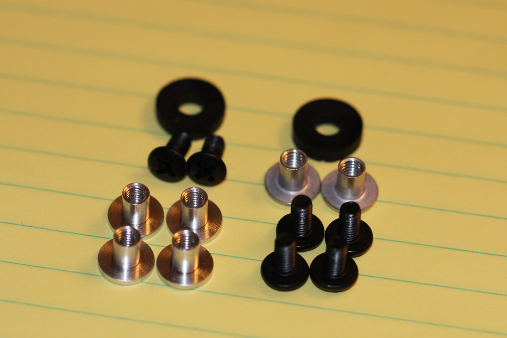

so. i took the sheath apart. four screws and four inserts. sweet!
observations:

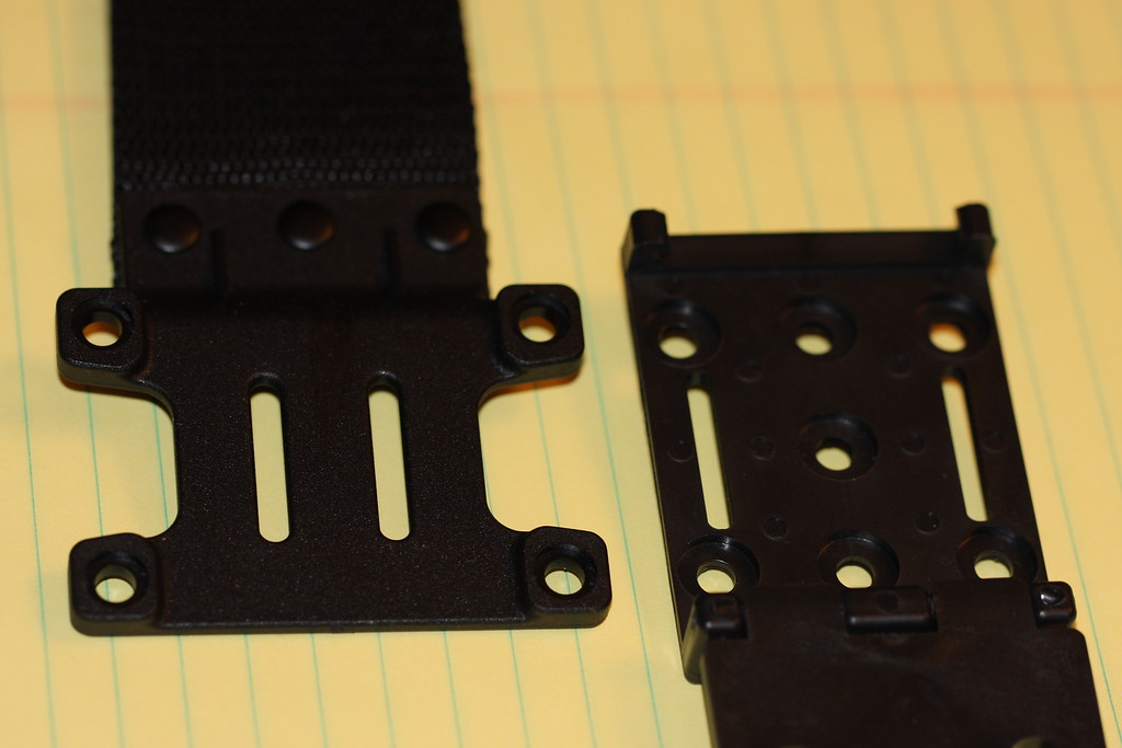

o the strap retention system is attached to an offset piece of plastic with 4 whole in the corners, and there are two slots (for webbing?) as well. the hole are countersunk on BOTH sides. mmm. INTEResting as they say.
o there's a thumb ramp on the sheath itself for pushing against and massive leverage. sweet.
o there are 10 HOLES with rivet points, and 4 slots capable of accepting webbing. there's a ton of places to lash or bolt things on. pouches. other sheaths.

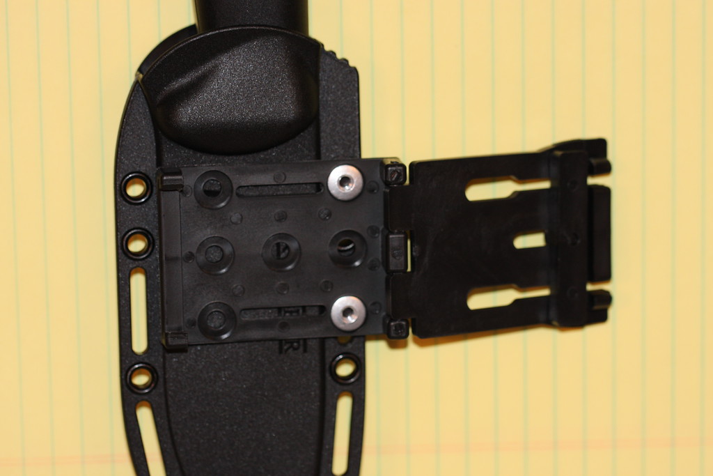

o one can reverse the strap system for lefties. one could even INVERT it. might be possible to do a sidedraw/ranger mode, but it could be a bit dangly/balanced challened. you'd want spacers ideally.
o or just leave it off entirely. looks possible to now enclose the sheath in leather, and then bolt on the straps, or something else.
o KaBar screws are universal slot/phillips style.
o comparing to a Camillus BK11 sheath, there are two many combinations of sheath holes lining up in pleasing ways to be coincidences. ideally, you'll want spacers to keep things flat, but really, wow. i am surprised? no ;P delighted? yes! you have to beg for this in custom sheaths sometimes. so, yes, you can be packing your BK11 mechanically fitted to your BK02. i imagine the sheaths will get upgrades as KaBar runs out of the older Camillus styles. count on it.
o the aluminum threaded inserts are almost EXACTLY like TekLok types, except the thread patterns are different. same size, and physical characteristics, such that one could swap the threaded insert/screw sets around as desired.
o some of the holes in the sheath line up perfectly with the large TekLok i had to compare with. the BK02 sheath is much wider, so one would have to pick a side, *or* an orientation (sideways/ranger draw anyone?) through two holes only. if they make an X-large TekLok, you're probably all set. i had to use the rubber spacers for best fit, but that's typical with many TekLok applications.
pictures are iffy i'm sure - new lens - improvements as i have time and skill to practice ;)

Thanks for the pictures! I was looking to see if it would work with a tec lok like that!
The new sheath really is awesome tho. It makes a great knife even better.
In fact I was happy my old sheath broke when it did :)
The first thing I did when I got it in from Kabar, was take the belt loop attachment off and ran some para cord through the lashing holes for belt carry.
It works good like, that but I'm sure a large Tec Lok is the cat's a$$ for this sheath.(for me anyways)
