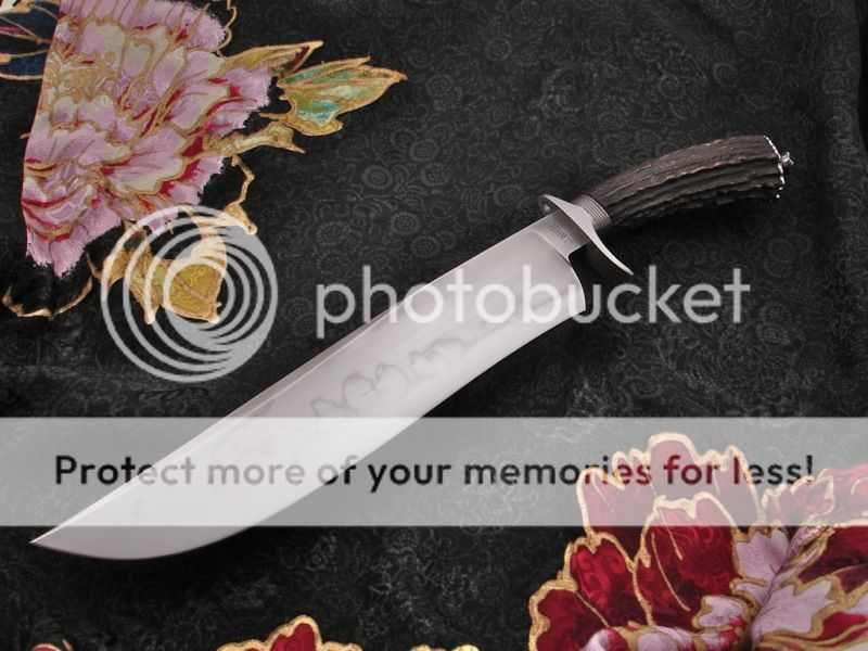

Next to the last blade of 2012; this 11 6/8ths inch clay-hardened W-2 chopper comes with 416 stainless guard and filed-to-stag domed butt-cap.
Collar and finial are Damascus, accent spacers are file-worked stainless, handle is a Sambar Stag taper, and the guard has a forward lanyard hole.
It's light and fast; .232 at the ricasso, with full distal taper.
This thing ate most of a 2x4, several chunks of rope, and is still hungry.
I'd better send it to Paul L. for discipline.

That big boy brings to mind a skit with Chris Farley............ "Lay off me I'm STARVING!!!"
Gorgeous John, and quit the Beast!
Love it, John! Reminds me of one from the past. :)
Appetite that is hard to please, I would think. Wants to keep on choppin'.
- Joe
Can't wait to see what Paul comes up with.
Great work, John !
Feed it red meat ! :)
