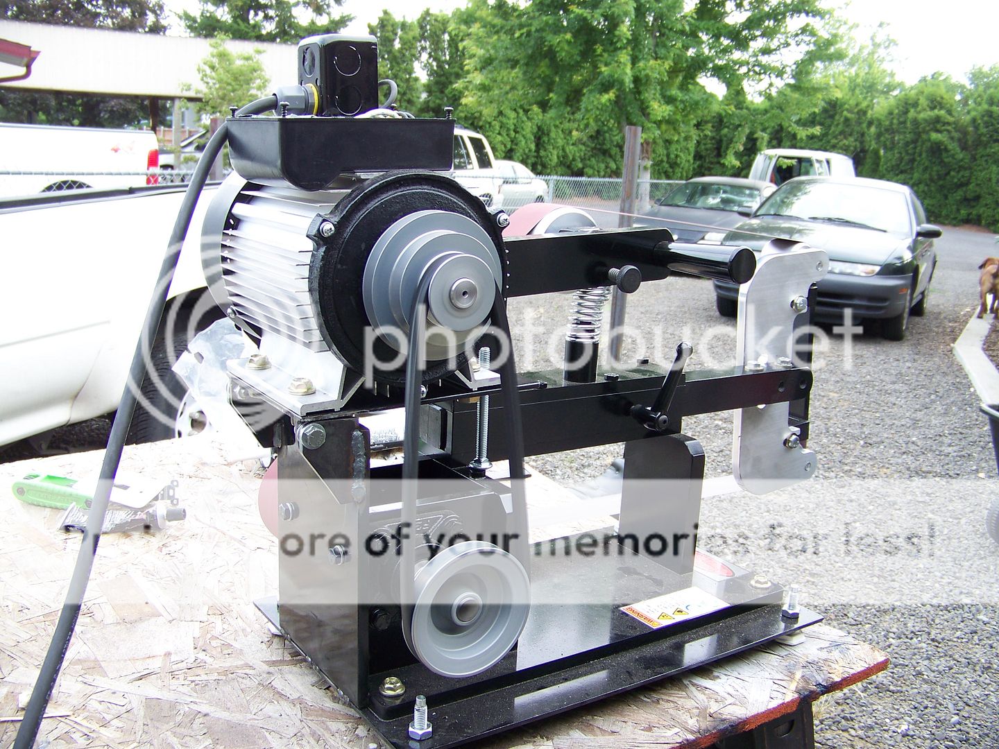

My friend Ben just put his new KMG together over here at my shop. I like this smaller base plate (cheaper too) with the motor mounted on top. Really compact. The KMG is a great grinder. It runs so good and quiet and rock solid.
Bruce, that is exactly what I'm looking for. Do you have any clue what he is all in for? Did you two make that mounting plate and what size motor did he use on that pulley setup?
Thank you,
He did make the plate that bolts to the back and the 1/4" plate hinges. The 1 1/2 hp motor sits on its own plate. He was originally going to mount the motor on the side as usual but the motor couldnt be wired in reverse rotation. Some dont I guess.

I think this will make me change how mine is set up...Thanks for the pics Bruce...great idea!
