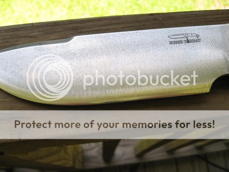

My new ganza Sarsquatch CE came in. Wow, this is the sharpest new Busse I have ever seen. For those of us that value performance over paint jobs, the CE option is great.

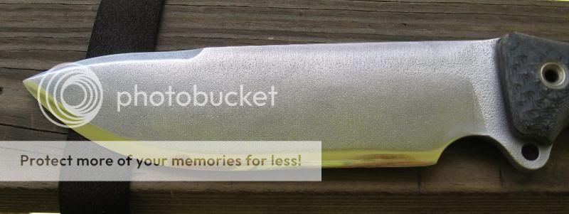

As you can see, the factory convex edge was ground even thinner than mine that I did on a stripped CG model.

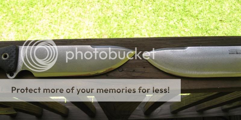

I figured if Busse can go that thin, so can I. Jerry knows a lot more about grinding than I do. So back to the belt my CG went to try and make the edge as thin as the CE edge. I think I got pretty close, but the CE edge is straighter than mine.

If you look closely, you'll see that the CG is actually a convex primary grind rather than a flat one. Feel it between your thumb and forefinger and go from the spine down. It is not too hard to grind off that obtuse factory V grind at the final edge and blend it with the convex primary grind. My CG is now almost identical to the CE in cross-sectional profile. And yes, you can put a nice convex edge on it without stripping it. But it will leave a fairly wide strip of bare steel at the final edge.
