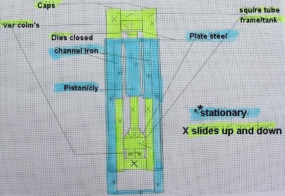

the new press , one of two I'm working on.
Jun 25, 2001
8,474
this is one of two I'm working on
the other one will have a rolling mill in it...
OK here's a rough of the first
I have a lot to do yet, but it's a peek at it anyway..
the piston is inverted for stabilization along with the removable butt plate that will be welded to the channel guides
I did use Mike K's idea of vert tube colms to put the weld pressure where I want them..
where channel iron on the inside is tapered it will give me room to add adjustable guides.
the tube frame will also serve as the tank for the hyd oil if it will hold enough
at the least it will let me use a smaller tank and will aid in cooling..
you'll see the way it's set up
the inside frame is what moves with the dies at the top and high, another idea
I think from Ron (bowie) or was it plain ole Bill? sorry
the top die is the only one that moves..
I do have to make some changes,
I tried to use E-machine for this and it's not working well . My fire wall is stopping updates
from them??
what to you think so far..??
this will be portable with a 8 HP Honda engine bumped up to 10 HP..
tubing, channel iron, and a small amount of steel plate is the bulk of it..
the lower part will be tinned in..
edited to add if someone has one like this I don't know about it and would like to see it, I don't want anyone think I'm copying anyones press. Thanks
for looking:)

Seriously, I like the design, and a have a drawing that's very similar in my notebook of possible shop improvements. I got the idea after seeing Grant Sarvers "kick ass 75" power hammer 5 or 6 years ago.
I think I'd prefer to have the fluid housed seperately, as a leak would be a #$%^ to fix then, as apposed to being able to simply replace a tank.
Tony

thanks Tony
I want to try the tank deal because of the extra cooling mainly and then portablity.
I can always dump it afterwards. it may even help dampen the sounds of the hollow steel some..

Mike K you asked me to post what I had in line art..
I'd enjoy your comments..good or bad...
If you're capping off the upright tubes, how about loading them up with sand?
It would dampen vibration and make the structure more massive.

they will be capped because the inner frame will be the oil tank this in turn will dampen most of the vibration..I hope..
it's going to be portable so if I can keep the weight with-in itself it would be a 2 fold plus thanks

I found it.. looks similar but way bigger than need be IMHO
very interesting though. looks like the same basic idea. as knives

Vibration?? Where is the talk about vibration coming from? I have been around quite a few presse's, made a couple, and helped make more, work my own quite frequently and I haven't seen one vibrate yet. These operate off hydraulic energy - there aren't any spinning wheels, jackshafts, flywheels or other parts to impart vibration into a press. Basically the frame just needs enough strength to stand up to the tonnage required w/o flexing.
Just curious guys, or am I missing something?

this one will have an 8 HP gas Honda engine built to it,, wanting it portable.
though I'm leaning to quick connects, the engine could vibrate some but that one won't much mounted right...
the big thing is, I still want the frame tubing as the tank..
I'm not sure if just the act of this working would make noise or not
but it's not a big concern of mine.
it will add a little weight to the upper die pressure ,, a little,,
little things will help some..:)
I think too if the frame tank does spring a leak, it would be a tell tale sign of a problem where as
other wise I would not know until to late.. what to you think??
OK Dan I understand a little better now. If the motor is mounted seperate from the frame and the lines hooked up w/ quik/connects that should be a cool setup and no vibration either. Using the frame for the tank will work fine and you will not have any extra noise from doing that either. Plus it is a good way to find out if you have any porosity in your welding too (grin). One question for you -- how did you size the motor and what RPM are you going to have to turn?

With the oil tank as the inner frame mine will be a lot more compact outer frame at about 18" out side..
