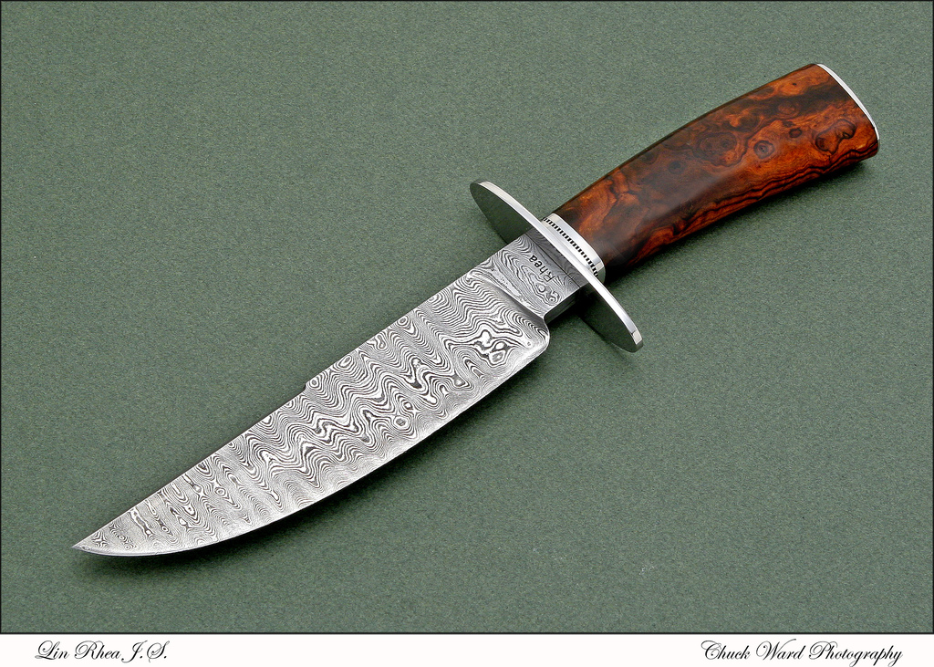

Here is one I recently finished for a customer and thought I'd share. I wanted folks to know I havent been sittin around doin nuthin.
The blade is 7 inches and made of 1080 and 15N20. The fittings are Stainless and the handle is Ironwood Burl. The handle is thru tang construction with the pommel fastened to the tang. Its named after a well loved and respected gentleman. I expect to make this knife again and will probably forge some from carbon steel. Thanks, Lin
