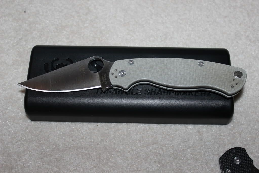

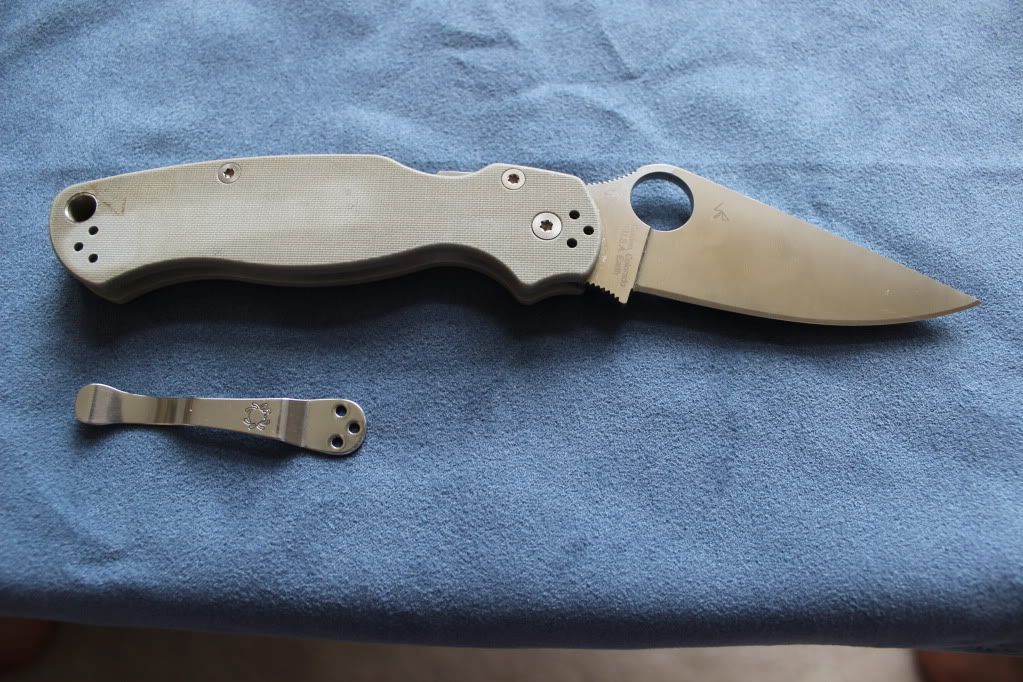

This knife has had endless reviews so I may not provide any information that hasn't been said already. But all else fails, I'll provide a bunch of pictures to make the review more entertaining :D

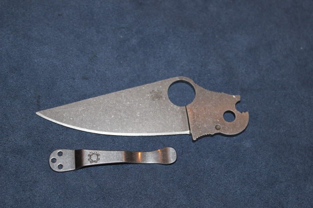

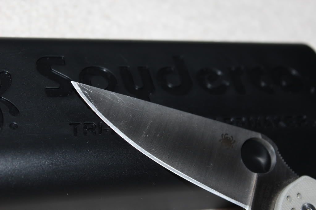

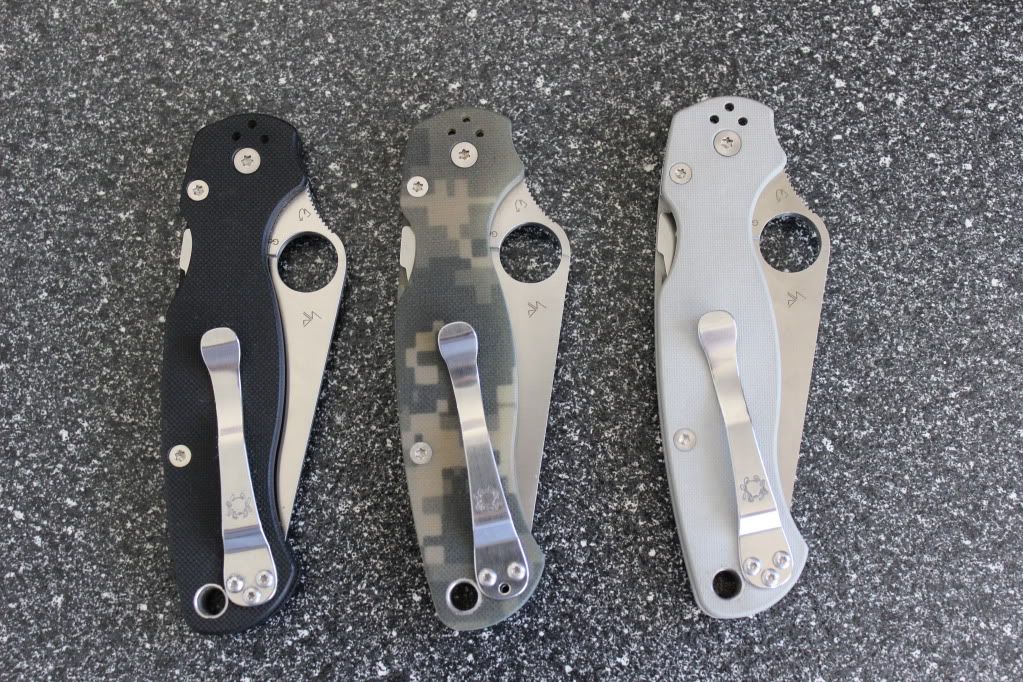

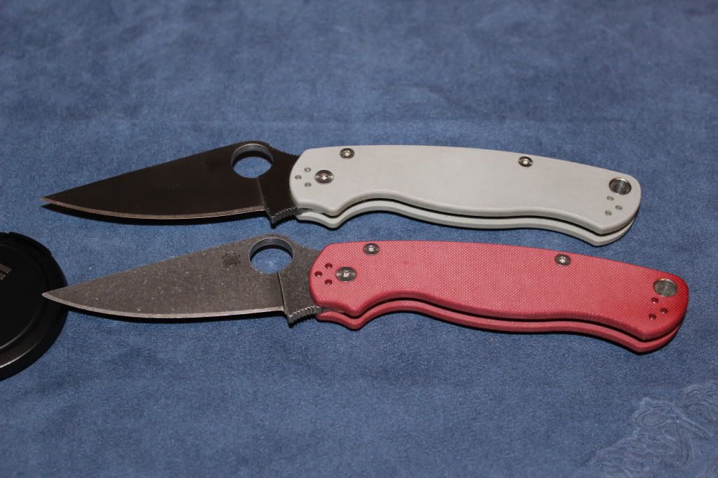

The paramilitary 2 is the reason I got into knives and it led to my discovery of Spydercos and high end knives in general. I ended up collecting this model and purchased multiples of most of them. I found the Para2 to provide the perfect balance of weight, strength, size, and blade length for my needs at the time. But, like most, the aspect that set this knife above others for me was the compression lock. This lock in my opinion is by far the most entertaining to use and provides the most control out of all the locks I have tried. I find the Ergos to be perfect for my hand when using the knife with or without the choil. And I find the blade provides a good balance of strength and thickness with slicing ability.
All the hype around different steels led my to buying the CTS-20cp sprint which started my collecting stage and I ended up with 10 at one point before selling almost all of them :eek:
Now I'll talk about my experience with the Para2 while using it extensively during my time working construction.
The Para2 I found was a perfect knife for construction due to its lightweight and ability to take a beating. I dropped the knife on concrete and rocks tons of times, pried with it, scrapped material, and even did some very light batoning at times and the knife help up great! The g10 on most of my users had chips and dents, and the blades had scratches, but that will happen with any knife.
The most damage I did was to my 20cp model and it was just a tiny chip from cutting through material and hitting rocks underneath
And that model I decided to stonewash and dye after that little incident :D
