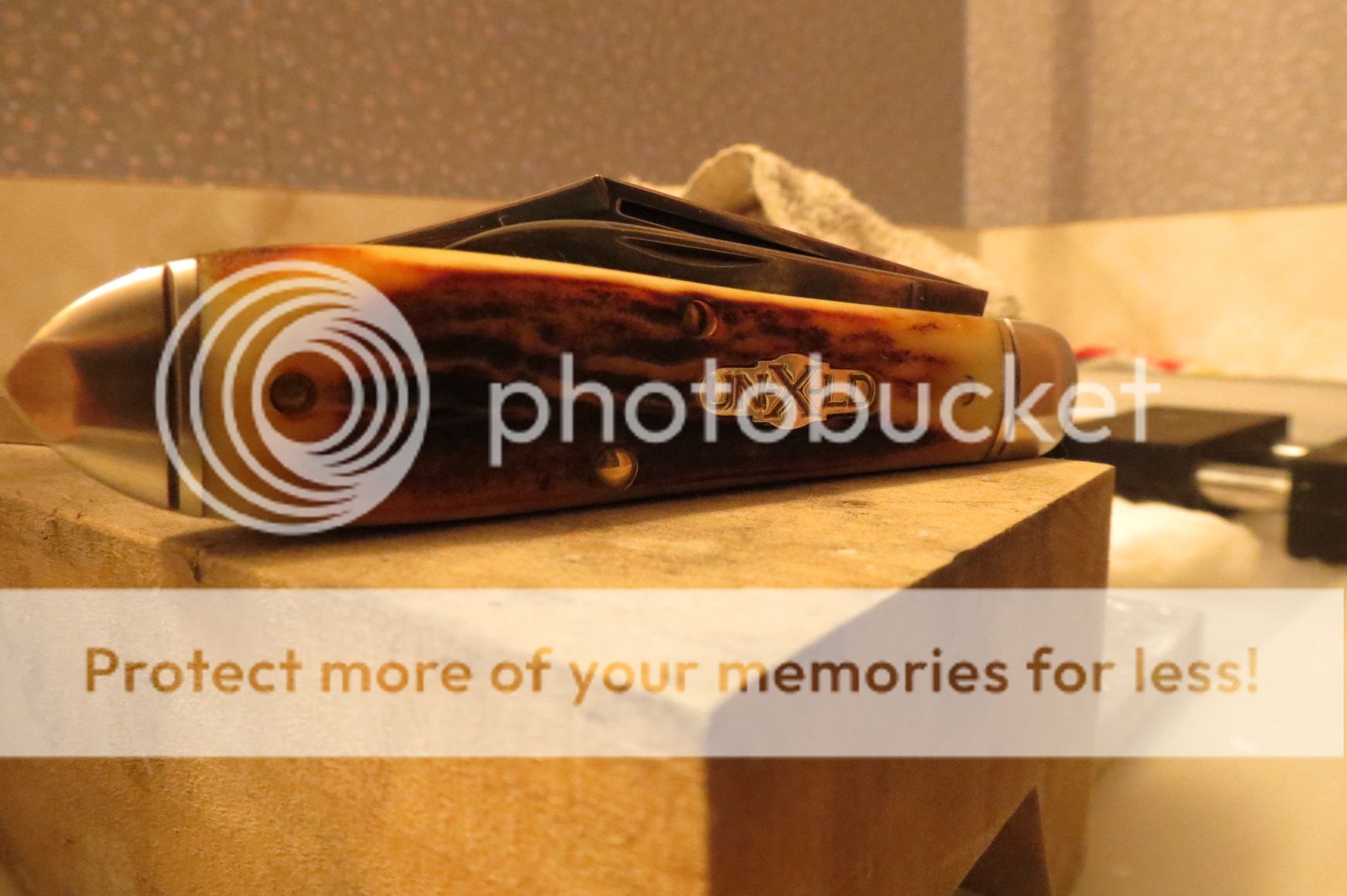

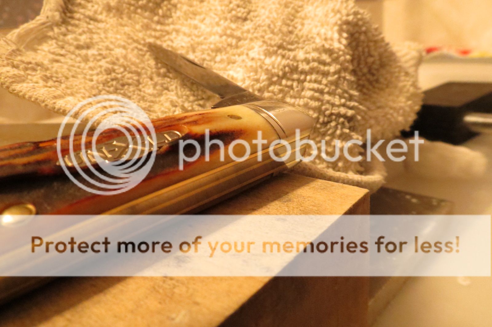

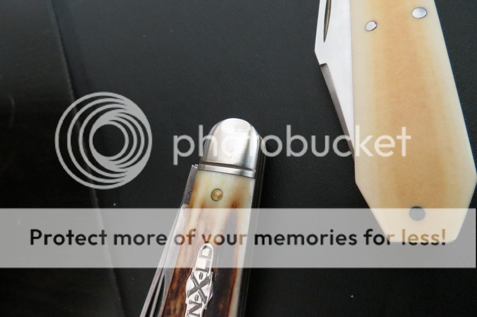

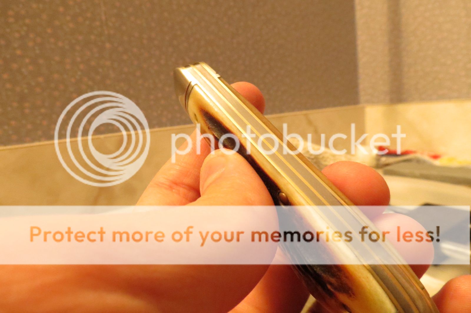

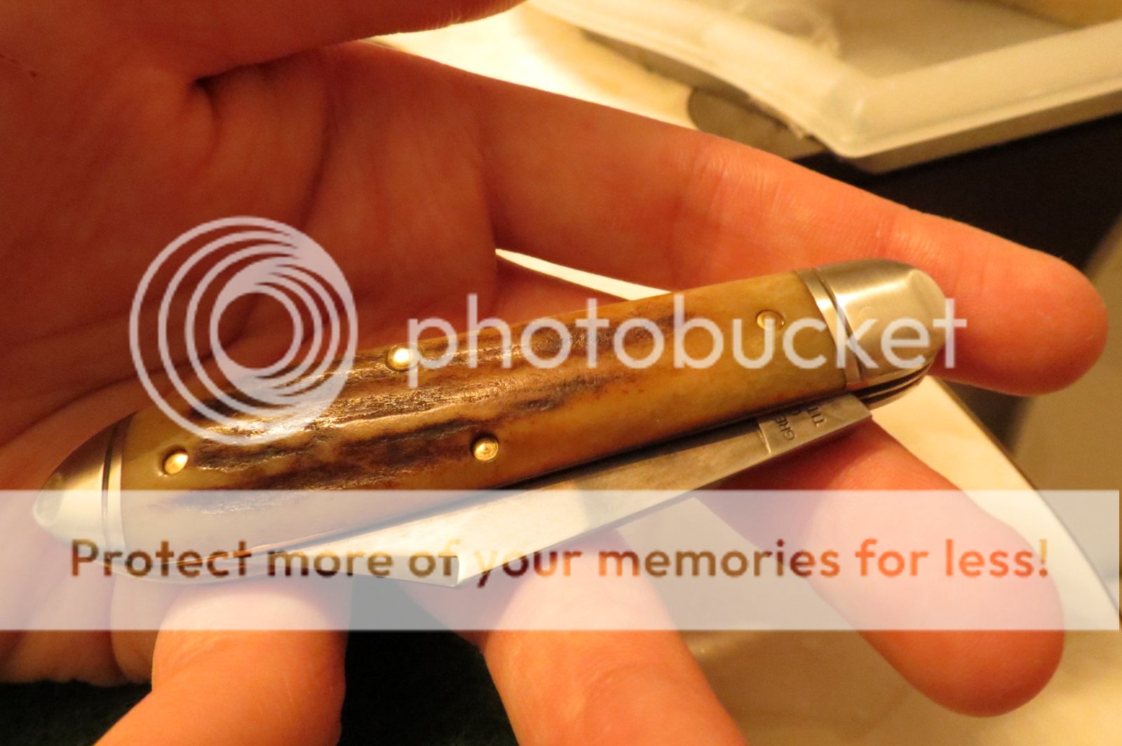

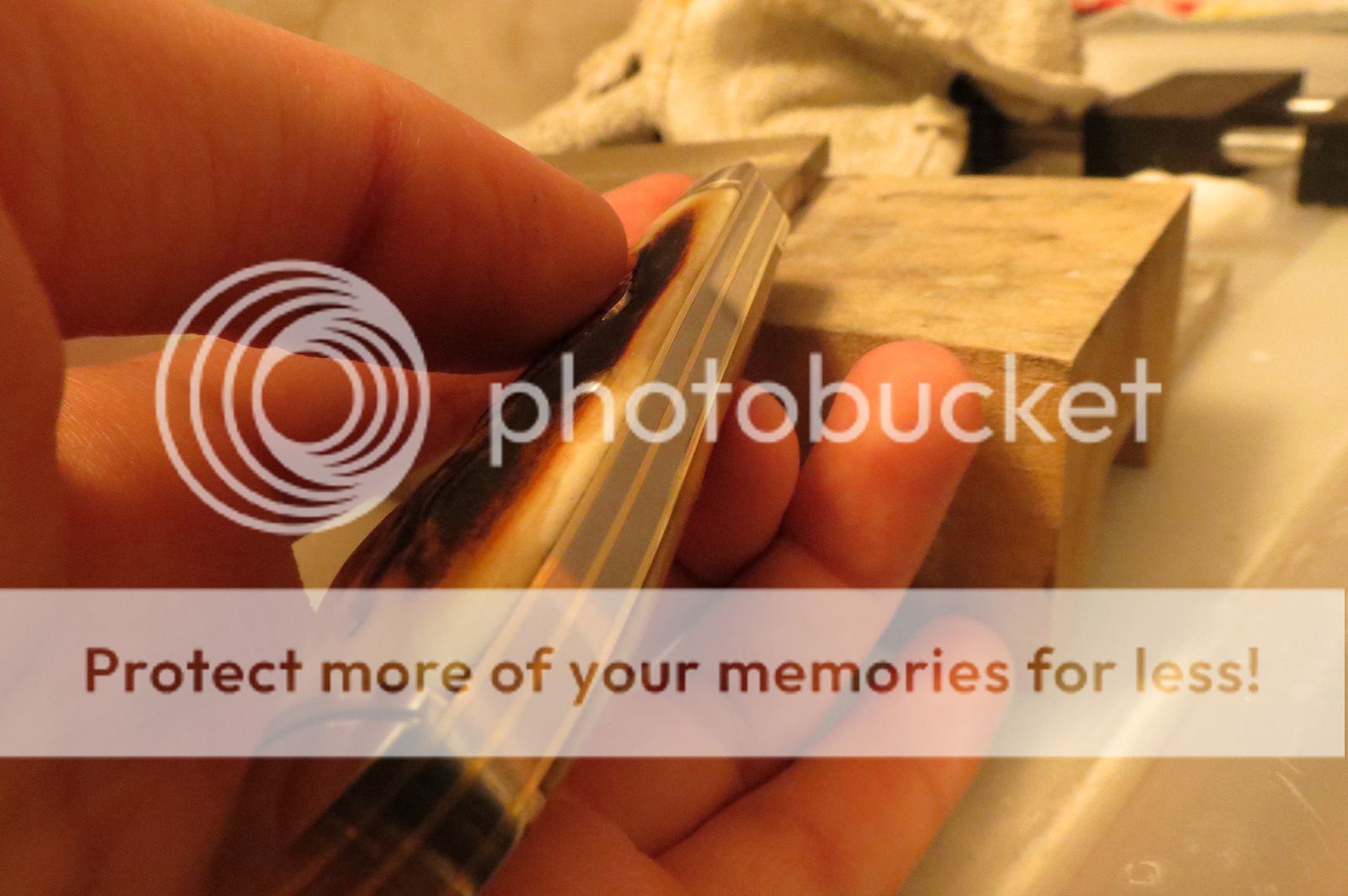

So what do you do when you are restless and can't sleep at night? You turn regular ole' production GECs into custom quality pieces. Roughly a week ago I acquired a GEC #85 from KSF. At first I was like, "wow it's much smaller than I anticipated." Though as I held and used the knife I fell in love with the extremely thin clip point and the ergonomic grip. With that I put a hair whittling edge on the clip point blade that laughed at thick cuts of cardboard. Even so, I still wasn't at all too excited with the knife and considered selling it. I told myself, what could I do to make me like this knife? Then I thought, why not put a patina? So off I went to microwave some distilled vinegar and I plunged the sterile mirror blade to attain that rich dark finish. I looked at my #85 again and I thought, "not bad, I may keep this knife after all." Even so, it was far from my favorite knife in my collection and the mirror polished bolsters scratched so easily. Frustrated, I went to the traditional for sale section and thought, "maybe its my lucky day and I'll finally snag a charlow from the forums." To my dismay, I saw 3 different sales threads all with a charlow for sale. In each thread, every one was snatched before I could post, "I'll take it." In my self sulking, I repeatedly looked at the sold charlows and noticed one of them had a different looking bolster. I then noticed that the seller had stated that he brushed the bolsters. I thought it looked amazing, but I was unsure if I could replicate the result on my #85, as the bolsters on the #85 are heavily contoured as opposed to the more gradually curved bolsters on the charlow. Disappointed yet again, I sat by my computer and watched the latest episode of The Strain from FX and 2 episodes from season 2 of The Vikings. After that I went to clean up some of my tool and organize my self. I was moving some of my sandpaper and my mistake I brushed it against the bolsters of my #85. My gec #85 now had a very noticeable scratch making the bolster essentially look like shit. At that point, I said screw it and prepared to completely redo the bolsters on my #85 having never prior given any material a brushed satin finish before.

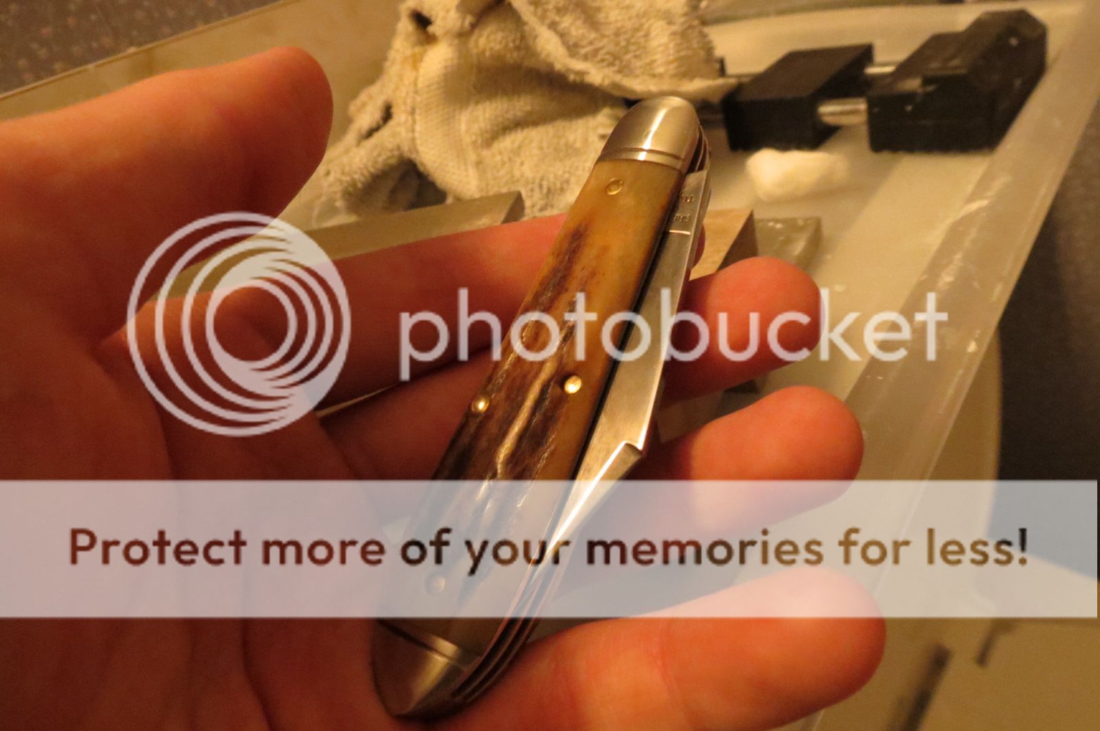

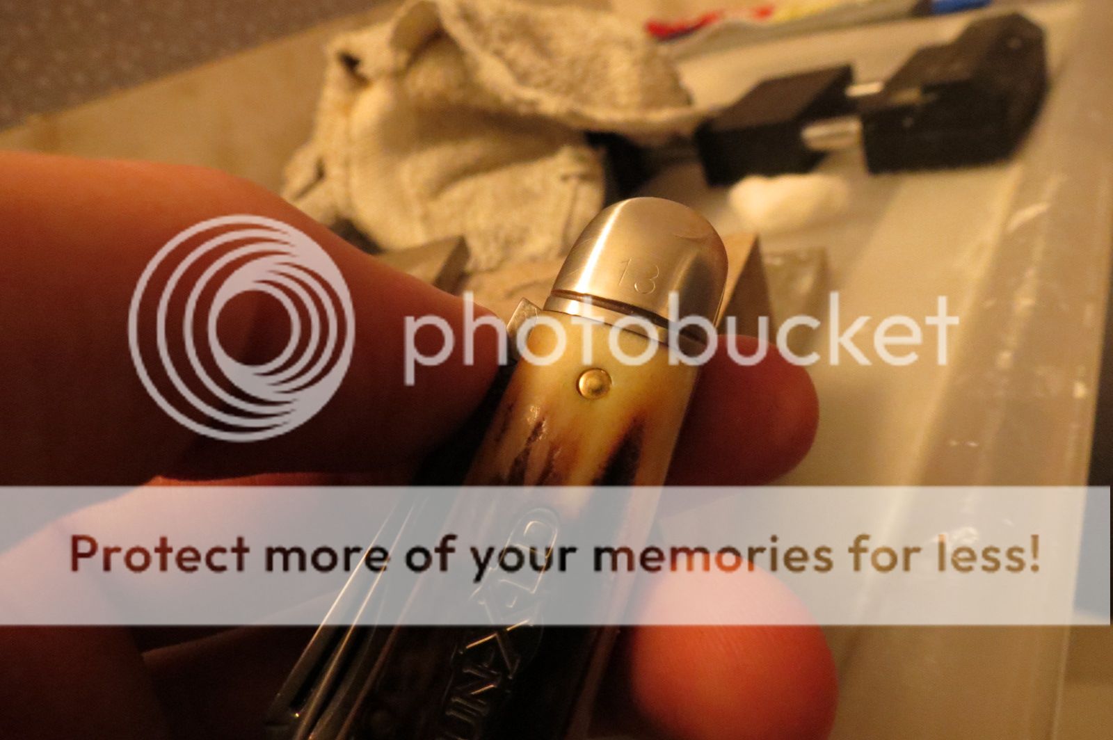

I grabbed some 600 grit silicon carbide sandpaper, an eraser, a neopreme phone case, some note cards, and a silicon carbide abrasive stick. 2 hours transpired and I had completely refinished all 4 bolsters and the spring/liners of my #85. As I looked at the end product, I felt a deep sense of gratification and thought, "I'm keeping this #85 after all." Please excuse the poor quality of the pictures as it is currently 4:35 AM with zero natural lighting. I also showed a half stop photo revealing a perfectly flush half stop on a production knife. Also the liners and springs are completely tight and flush. In some photos there appears to be small gaps, but there are none.

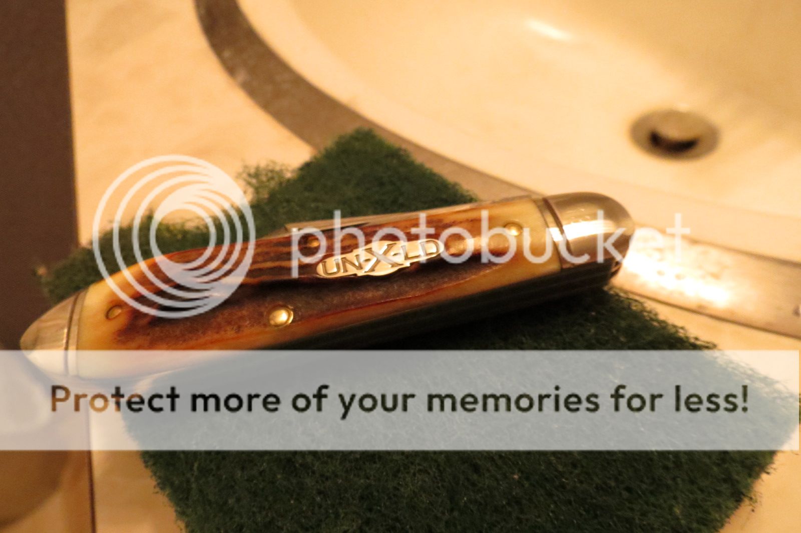

Just put a scotchbrite finish as opposed to a 600 grit finish on the liners/springs. Looks a lot cleaner now.

As to your question, yes I did use tape to protect the scales. As for the process I'll explain it below:
I used the eraser as the support behind the sandpaper to begin the brushed finish. The eraser is rigid, yet has some give allowing you to work around contours and get even lines without getting flat spots. Unfortunately, these bolsters were very contoured, especially the ones towards the butt. The eraser was great at getting the edge where the bolster meets the scales but it was unable to evenly brush the entire bolster. That's why I used a neoprene phone slip with my phone inside as another backing for the sandpaper. The neoprene has more give and the phone inside it still gives it some rigidity. I was able to hit the spots I wasn't effectively covering with the eraser. Its extremely important to move extremely steadily and to rotate the knife as you push to follow the curvature of the bolsters. The bolsters are cut, so I use the cuts in reference with another straight object to make sure that I am moving in the correct orientation as I rotate the knife. In this case that reference was a stack of note cards I was doing the knife over. After the bolsters have a nice even finish, I grab a old shirt/rag and coat it with the sic carbide abrasive. I wrap the rag tightly around the neoprene case with my phone inside and I steadily apply pressure with the knife and move across the fabric. This cleans up the lines and give the bolsters a cleaner look as well as correcting slight (only slight) errors with the sandpaper. As for the liners and springs I wrapped the eraser with the 600 grit sic carbide sandpaper and did consistent liner strokes to give a satin finish and to rid it of scratches. I then grab a notecard and rub sic carbide abrasive and wrap it around the eraser. I repeat the earlier step on the liners/springs until it has a very nice sheen. After all of that I wet a towel with rubbing alcohol, remove tape residue and clean up the knife.
EDIT:
On another note to individuals whom want to do this I would recommend 400 grit as opposed to 600 grit sandpaper. The brushed finish still hold up much nicer than the mirror polished, but is still prone to scratching given the soft material the bolsters are made out of. Small scratches can easily be removed with the black crayon abrasive though. I just feel that a 400 grit brushed finish would probably still look just as nice while hiding scratches better.

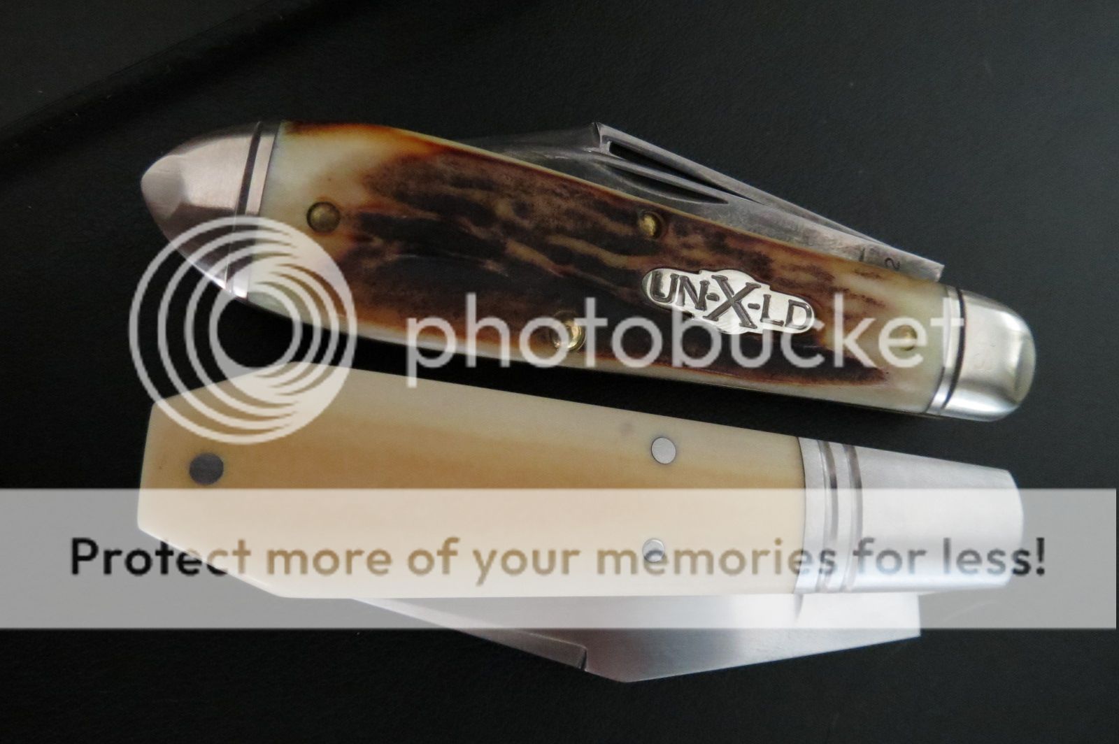

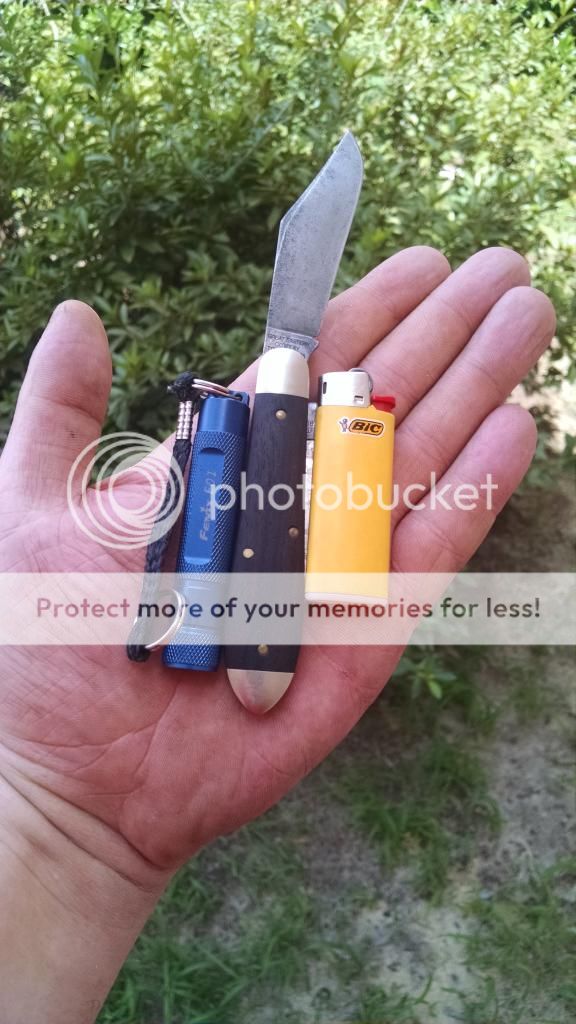

i do like mine
never seen anyone else post a pic of a similar model
clip point in ebony ;)
Sorry buddy, I have one on the way to me that had gone unnoticed on the exchange. It should begin crossing the Atlantic at the end of the week. I'm looking forward to it, I've admired this picture of yours before :)
Dangnabbit!!
And I was a unique special butterfly for nearly 2 years :D
Thanks guys, that clip point in ebony is really nice. Personally I think a satin blade is much nicer than a mirror polished one. Too bad almost all northfields are mirror polished. I'll try to get some day time pictures soon.

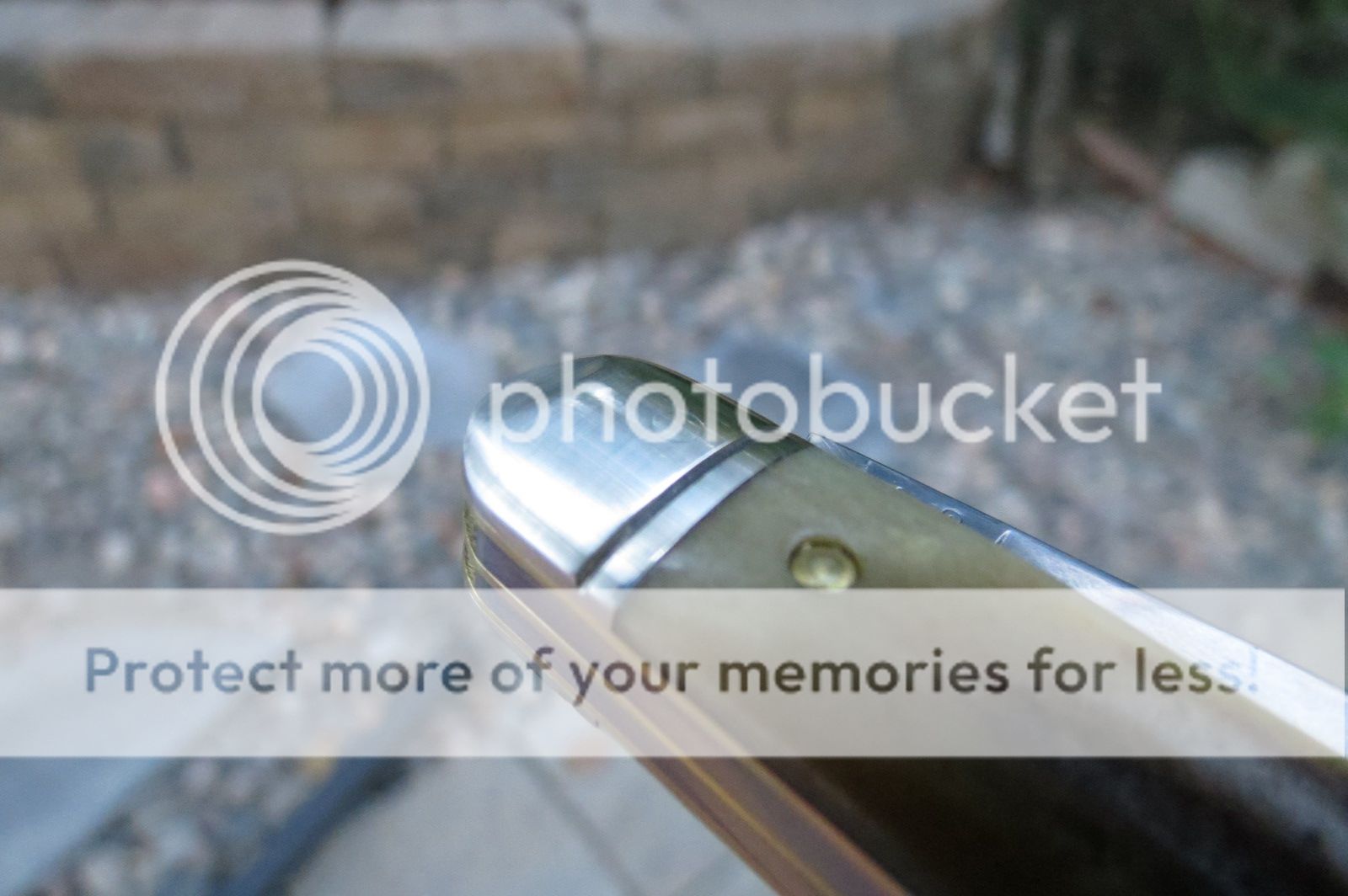

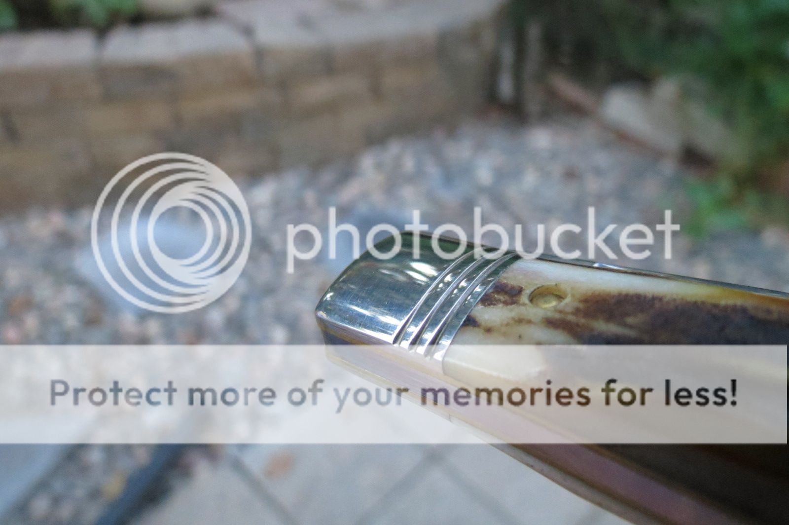

New pictures and also showing difference between a mirror polished bolster and satin. The satin hold scratches a lot better, another reason why I choose to do this.

(No, I don't remember exactly how I achieved the finish, only that ScotchBrite was key, and that 'errors' were easy to buff away.)
