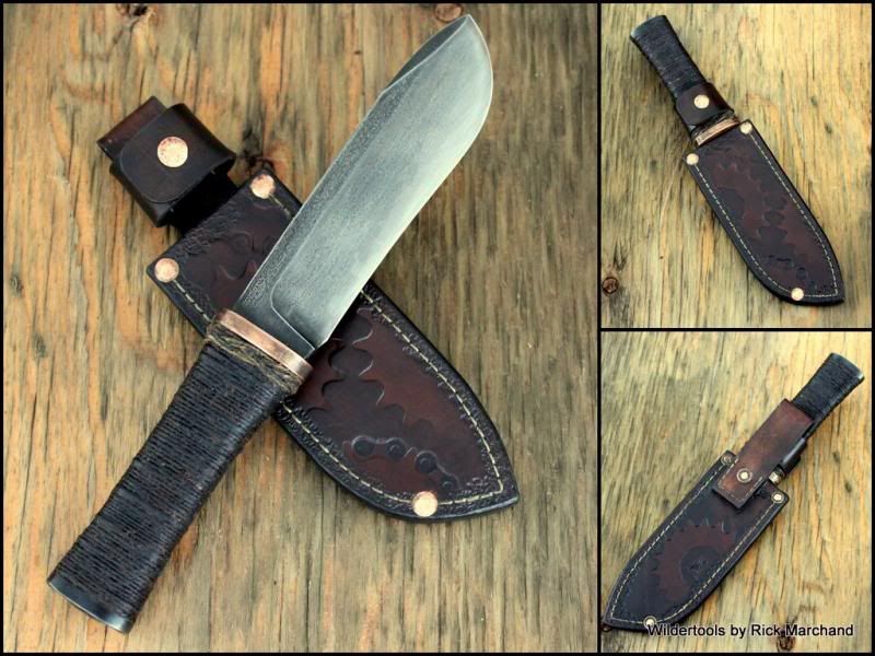

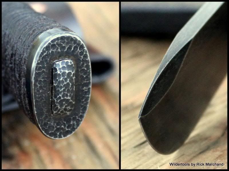

This "knife" may be better suited as a link pin for rail cars. It is called the PIG(Purposefully Inflated Geometry). Short, overweight, ugly, aggressive, dirty and nearly indestructible... it reminds me of a few bladesmiths I know.;) This is the latest version of an ever-evolving pet project of mine. Its early ancestor was called the Bush Pig and was a blade geared specifically toward my particular needs in a stand alone bush knife. Admittedly, I'm not so much into the "bushcrafting" side of wilderness survival. I tend to approach survival much like a Pitbull does a steak. There is no need for delicate carving, dressing game or shaving my armpits. It is hard to see it in the pics but there is some serious meat behind the cutting edge... cold chisels be hatin'. That said, I'm sure it wouldn't do too badly at any of that fine stuff either... you gotta gimme a bit of credit at least.:cool::thumbup:
PIG
1084FG
1/4" thick
11" OA length
6" blade, 1 5/8" at widest
5" handle
Tapered tang
Handle is leather backed, hemp wrapped and epoxy soaked
Copper guard
Mild steel pommel plate, peened
Sheath is hand stitched, tooled, riveted and wax dipped.
Can anyone guess which BF member this blade is for?

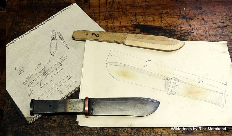

I kinda dropped the ball on WIP pics but better than nothin'...
Thanks for looking.

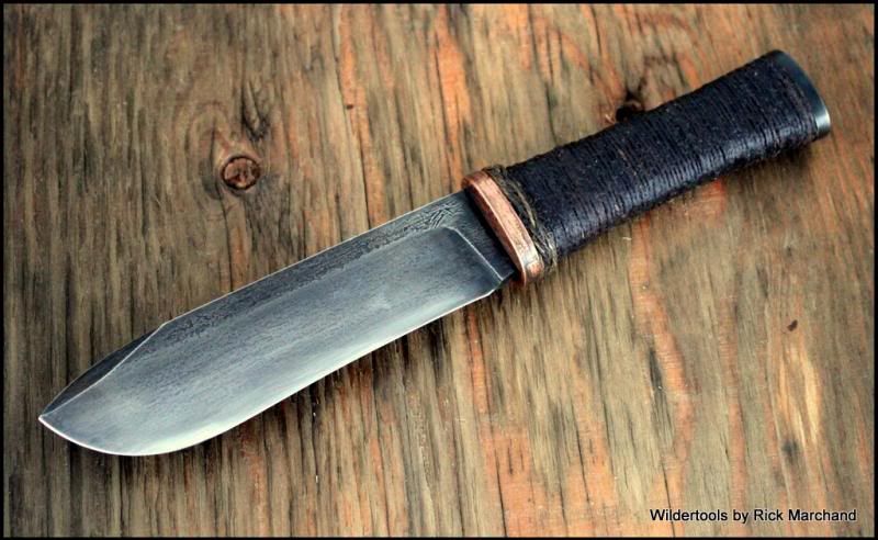

Thanks, Brony... It does have a convex edge. Like I said, the pics don't capture the geometry. If I mic 1/4" in from the cutting edge it reads .070" along the belly and .100" at the up-sweep of the tip. That might not be much for some but it is HUGE to me.
It push-cuts newsprint for fun... but it is the poster boy for the term "sharpened prybar". We'll see what the owner has to say about its performance, next week.

It has style....your very recognizable style...the copper at the front and iron/steel at the back with the hammer texturing, the cord wrapped handle...very stylish, goog looking.
While I always appreciate the purpose and thought that goes into a good spearpoint...clip points work for me every time. If you could find it in your heart to make one with a clip point it might just take it to that next level of function meets aesthetic WOW!

This was the lovely model who posed for some of my early drawings... what graceful lines...
Fantastic as usual ,I love your work, instantly recognisable .ive dabbled in that type of handle ,not as easy as it looks you get it spot on .Personnaly i would like less belly and have it a bit pointier if you know what I mean well done
I really like your style and this does not disappoint. That could be a great hard use tool!
