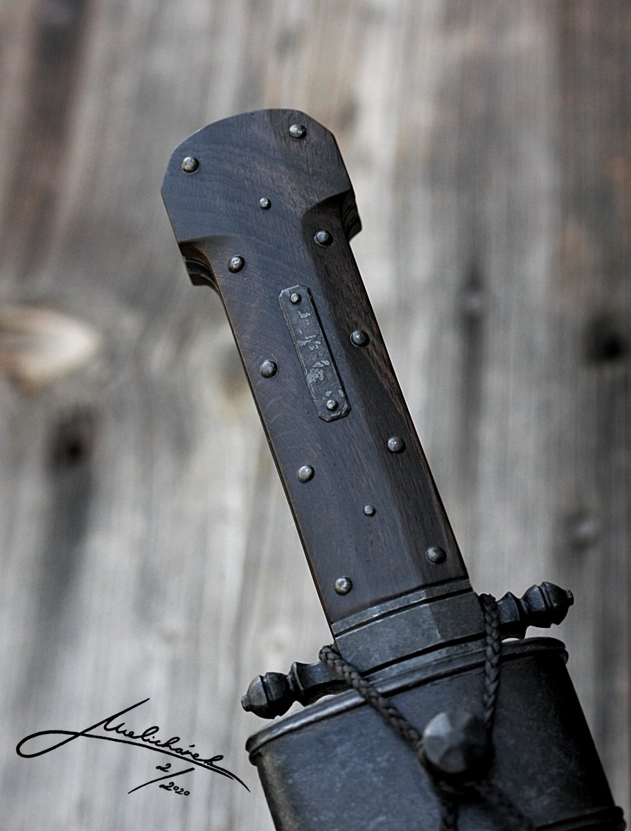

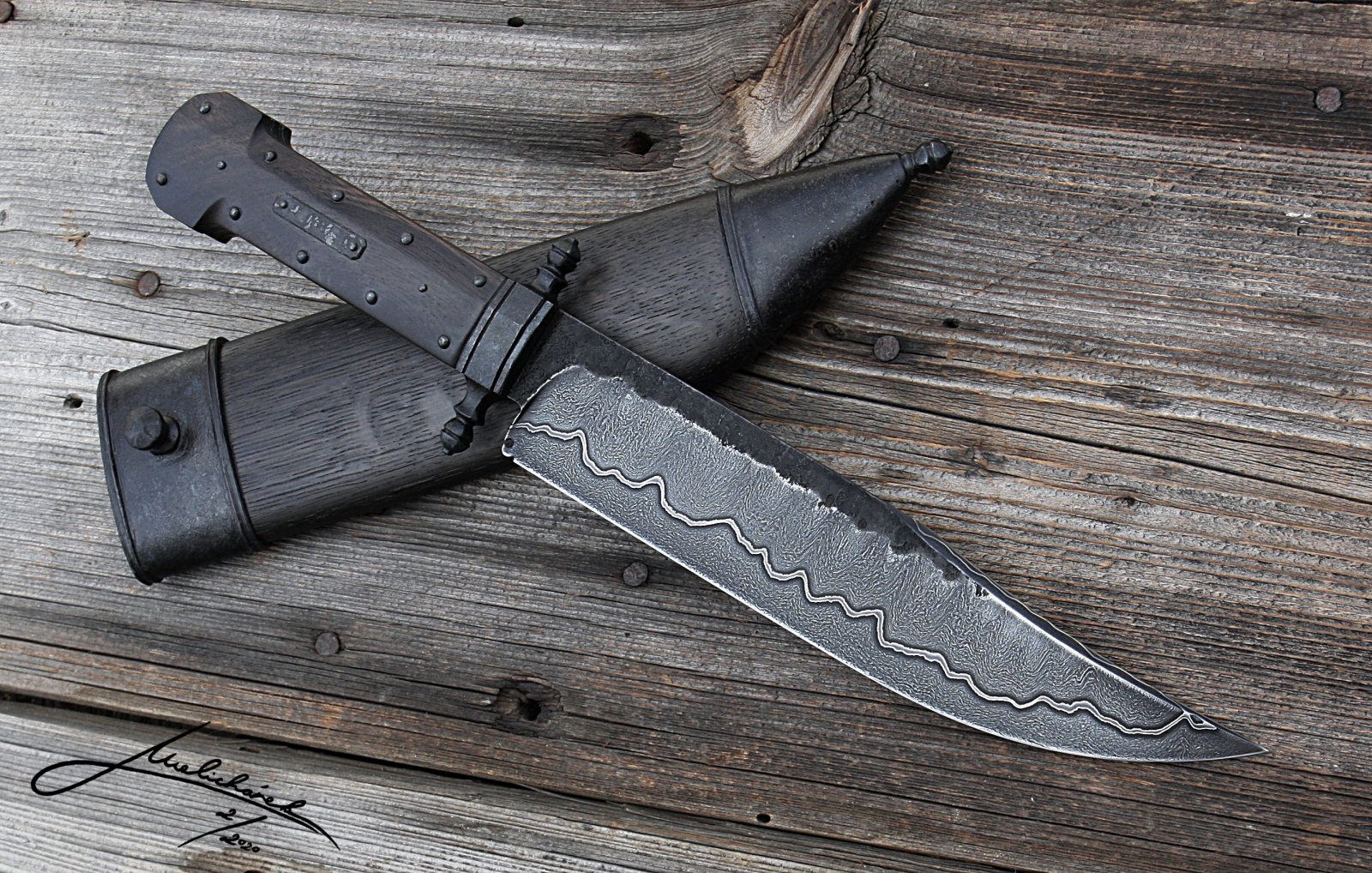

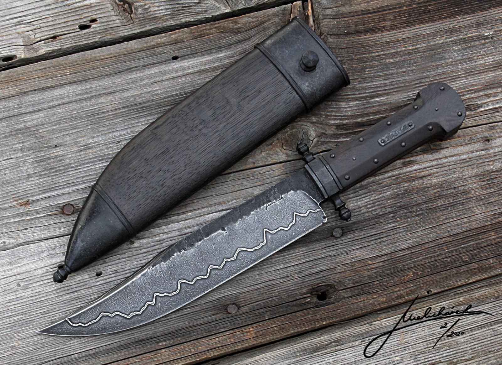

Hello everyone :)

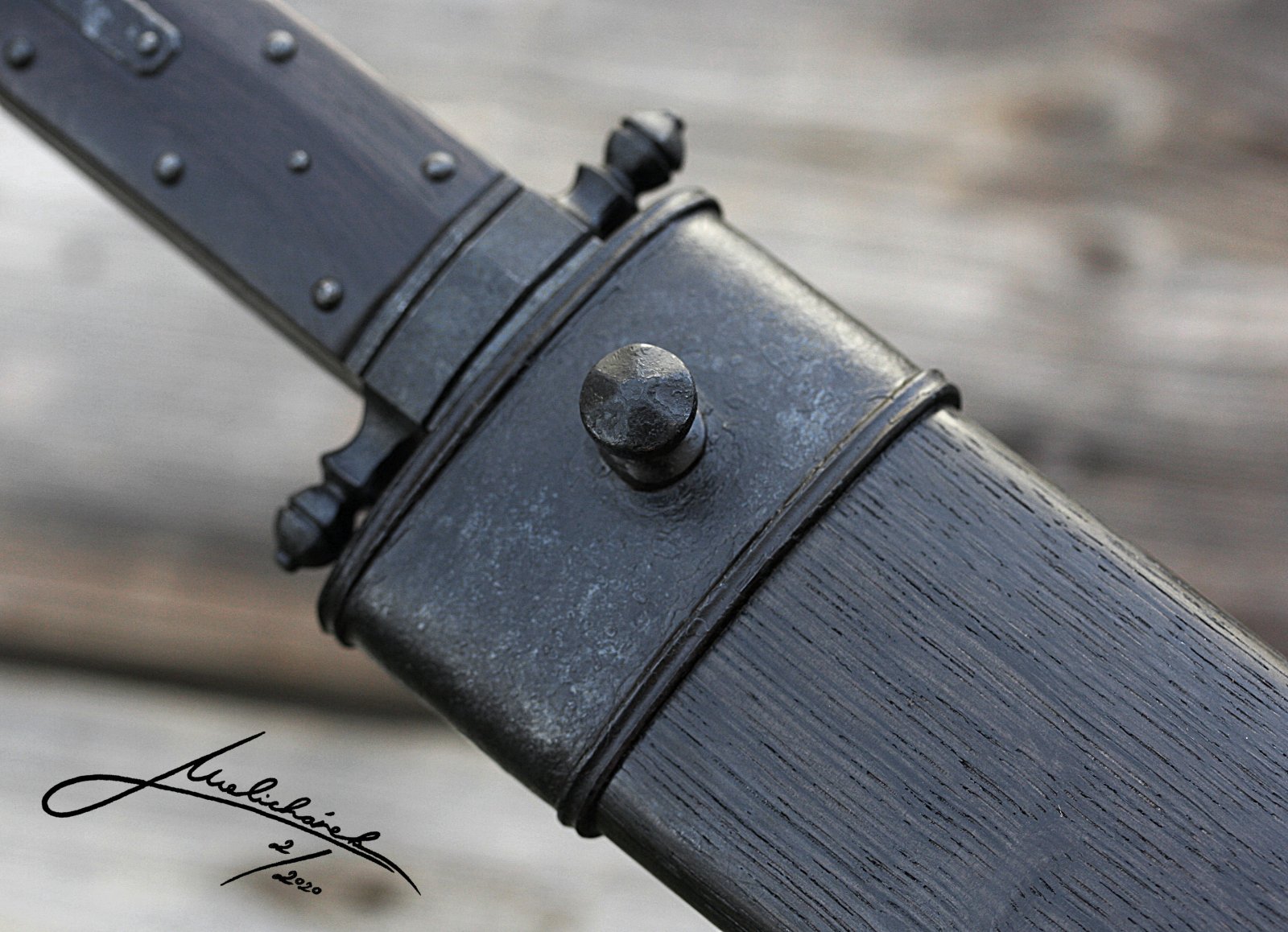

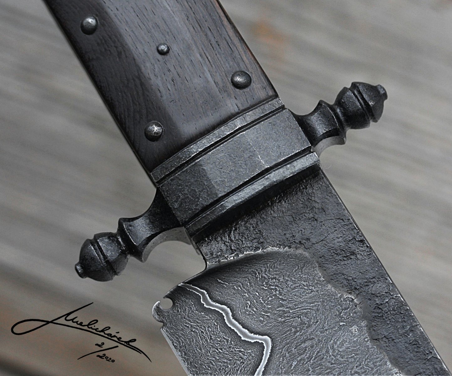

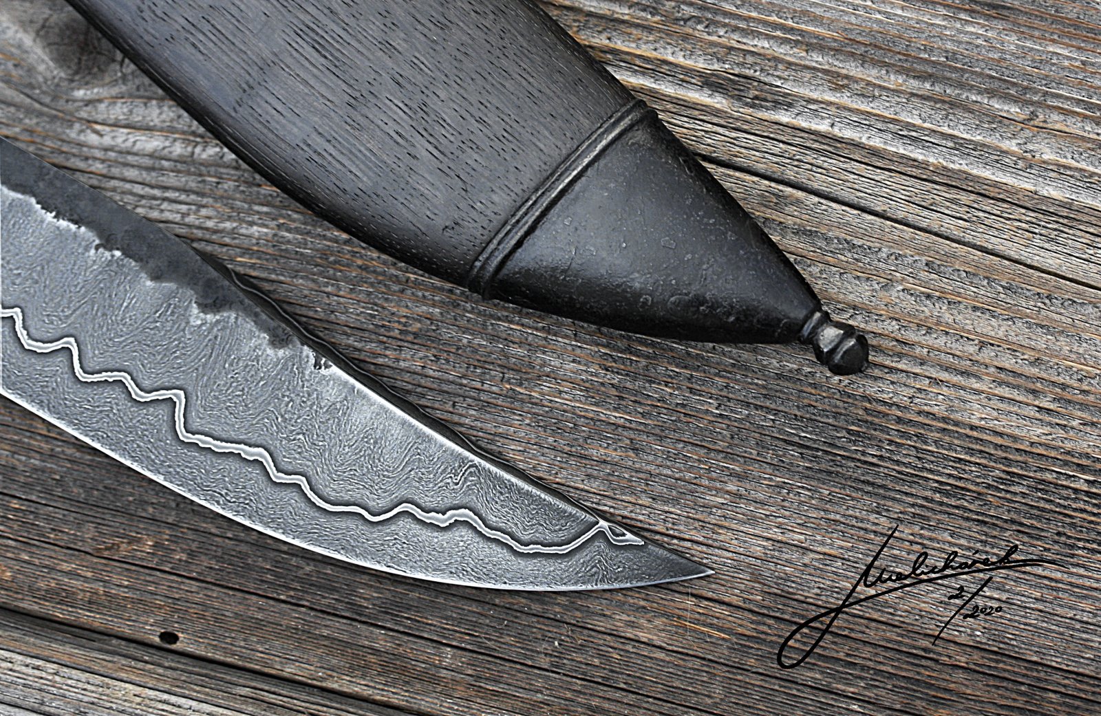

Today I finished this knife. I was working on it for about a month. It is so called dog bone bowie with the frame handle construction. The small tooth on the heel of the blade is called spanish notch and is quite typical for this type of knife. The sheat was somehow challenging, but im happy with the result :) So see you with more knives soon :) bye Petr
The Preacher
Blade - Go-mai - 1,2842 (O2) + 75ni8 Uddeholm (15n20)
Guard - patinated mild steel
Handle - ancient bog oak from the base of mediaval bridge
Average length - 38,5 cm (approx- 15,2 inches) , blade - 24cm (approx- 9,5 inches).
Blade width at widest point 46 mm (approx 1,8 inch ) mm , blade thickness 5 mm (0,197 inches).
