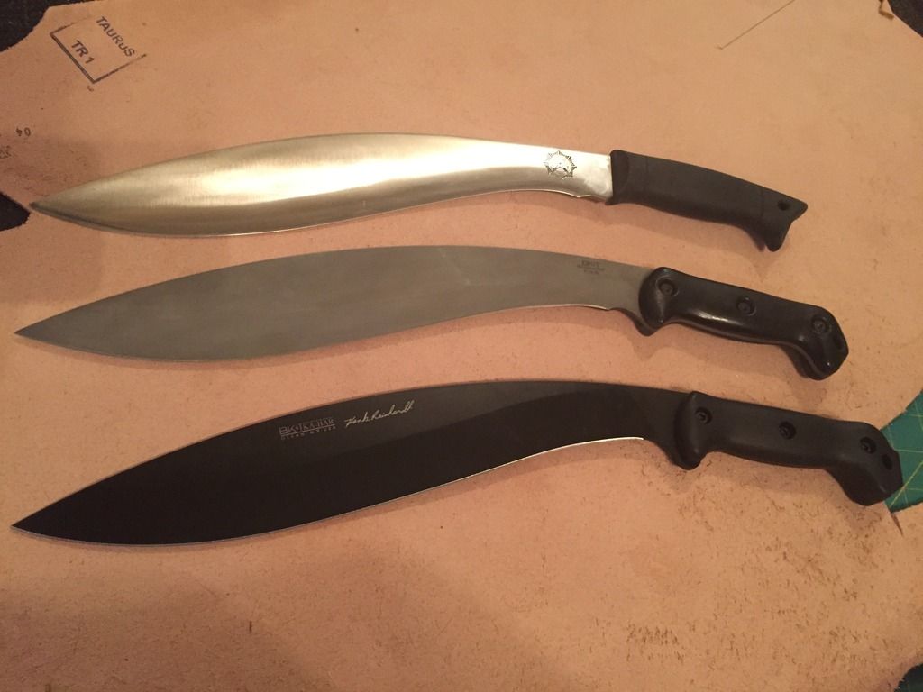

Well I guess you could say I'm a fan of Hank's kukri. I always loved my blackjack RBK and when the bk21 finally made its way to the market it became one of my favorites.
Well I recently acquired the original blackjack Reinhardt combat kukri. It's a beast! I was expecting it to be like the blackjack RBK, but it's closer to the kabar bk21.

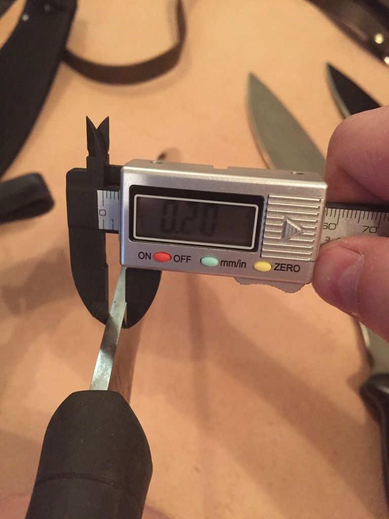

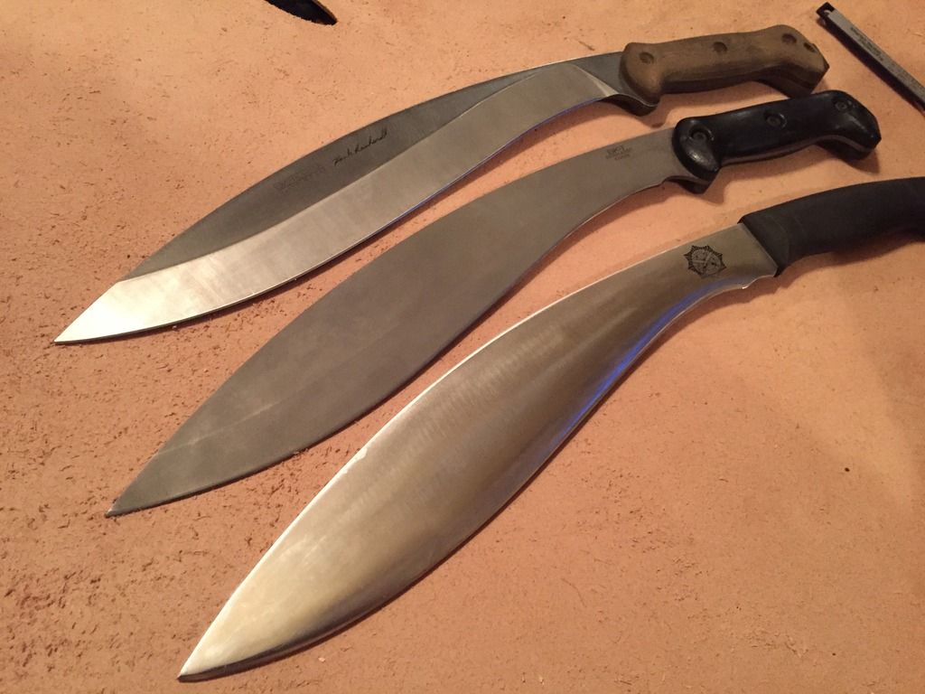

The combat kukri is slightly thicker the the kabar bk21 and is a full height convex grind. I don't have a scale, but I feel like the combat kukri is hardly any heavier than the bk21. I'm super curious as to how the combat kukri got drastically transformed into the blackjack RBK. They are completely different blades in the hand. The blackjack RBK is basically a thin, light, and nimble machete; while the combat kukri is thick and a major chopper! Neither are bad blades. I personally prefer the combat kukri to the blackjack RBK. I wonder if Ethan had any say with the design change.. or perhaps it was Mike Steward's call.
Combat Kukri
Blackjack RBK
Kabar bk21

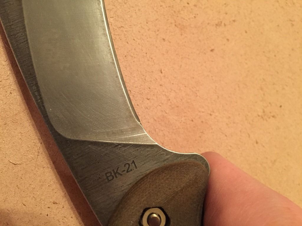

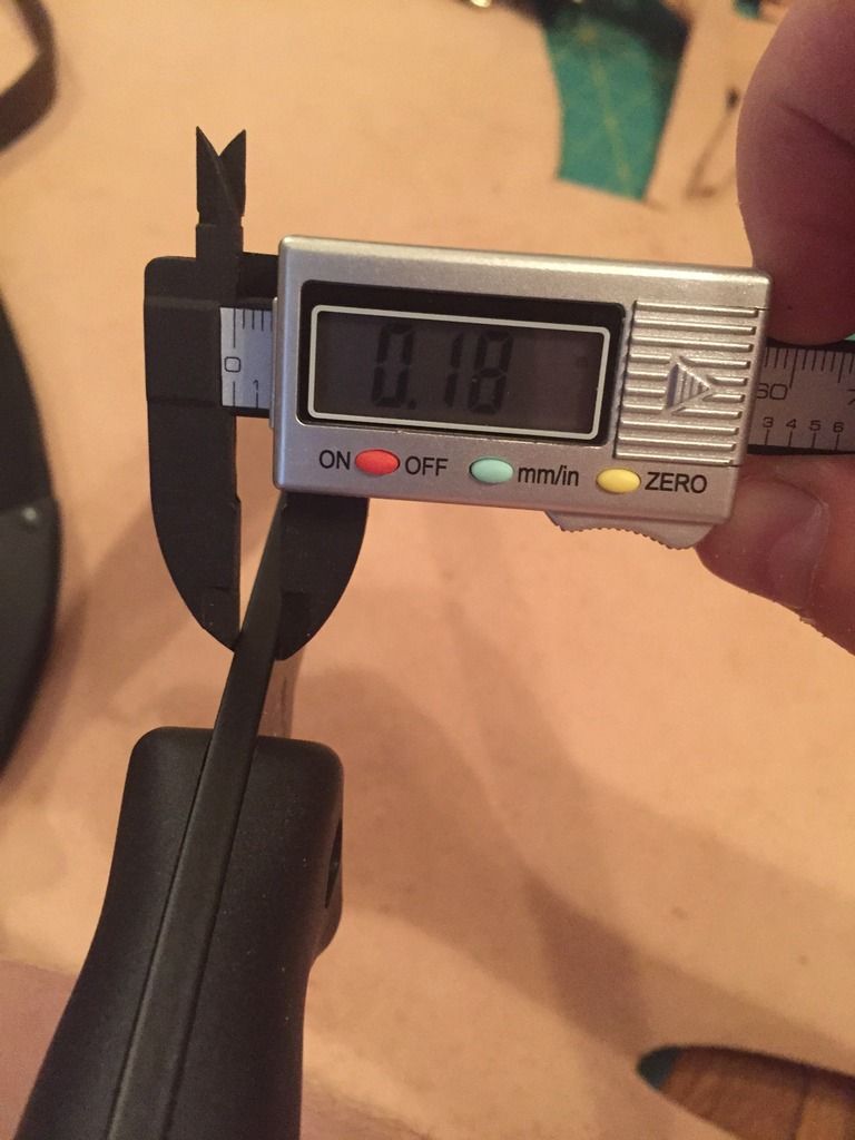

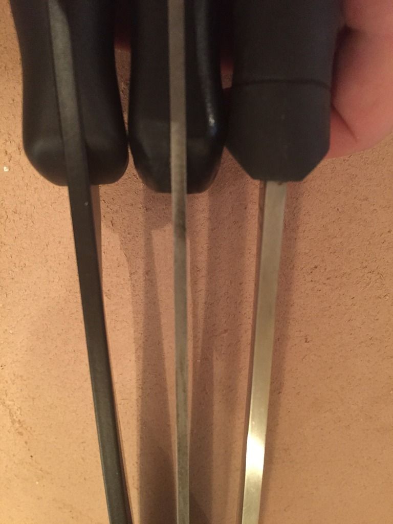

Big change in the height of the grind from the blackjack RBK to the Bk21

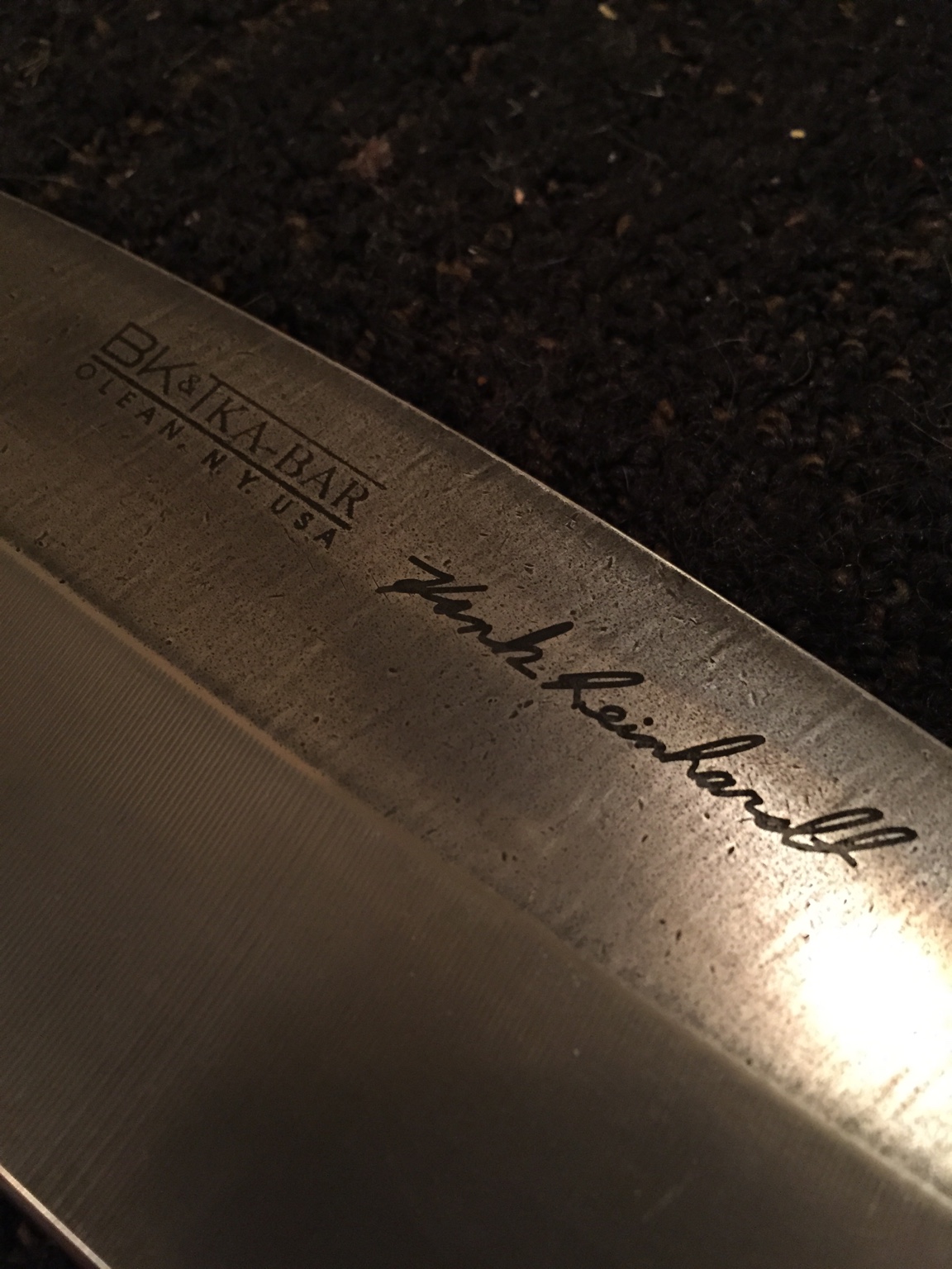

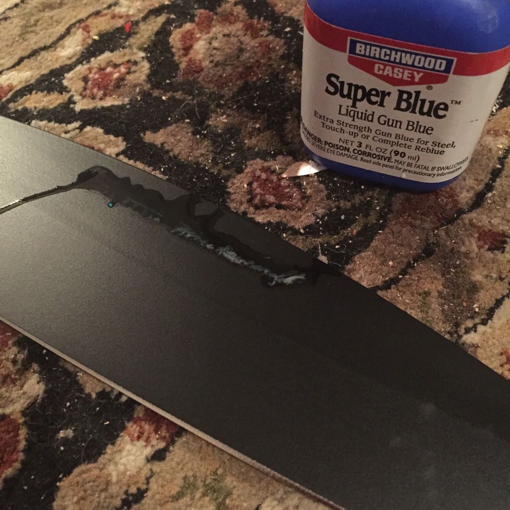

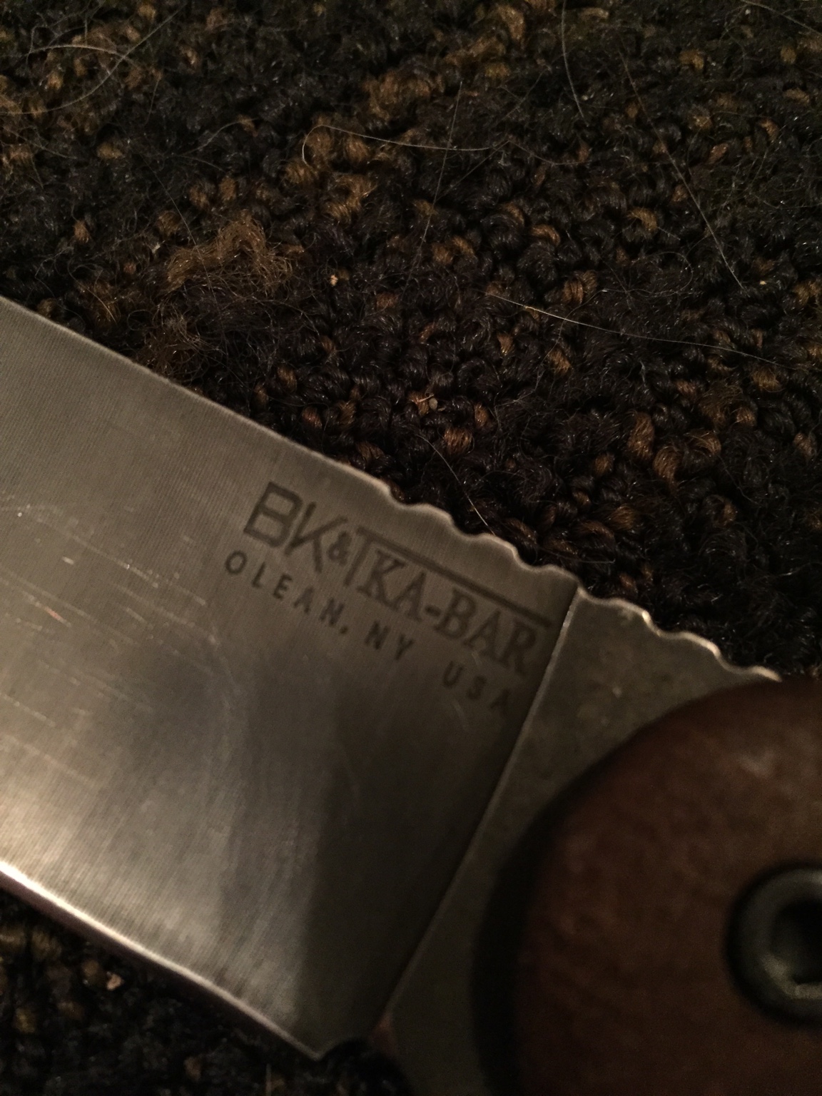

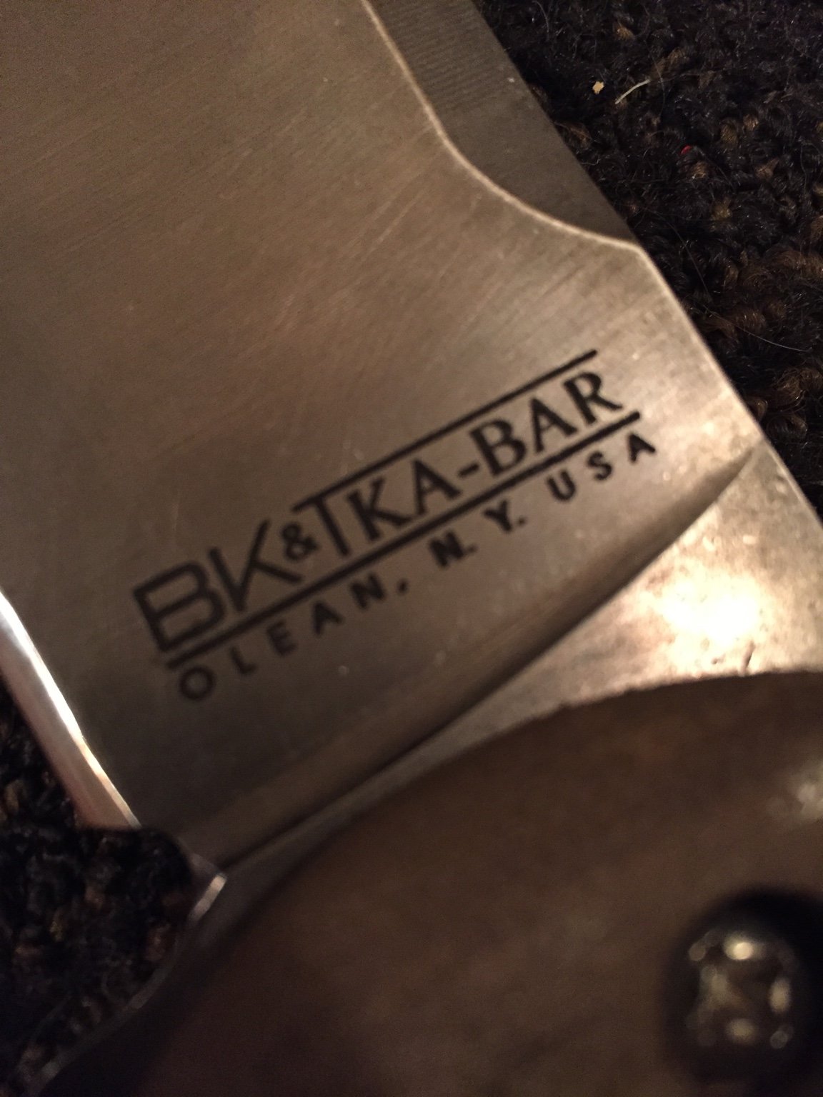

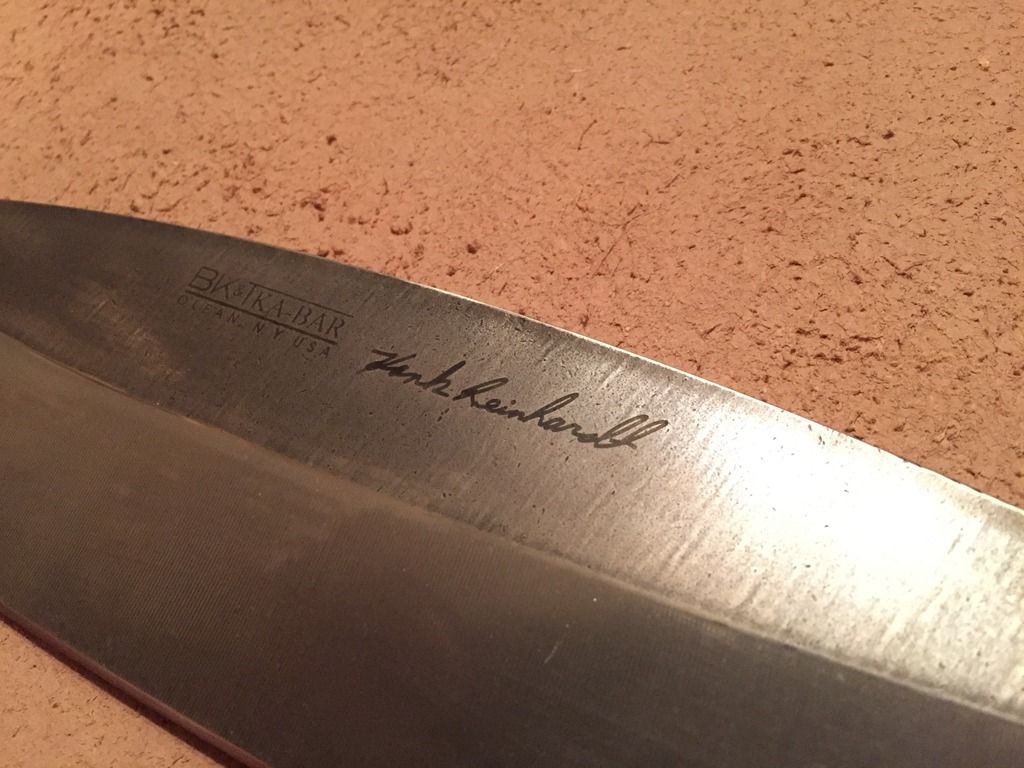

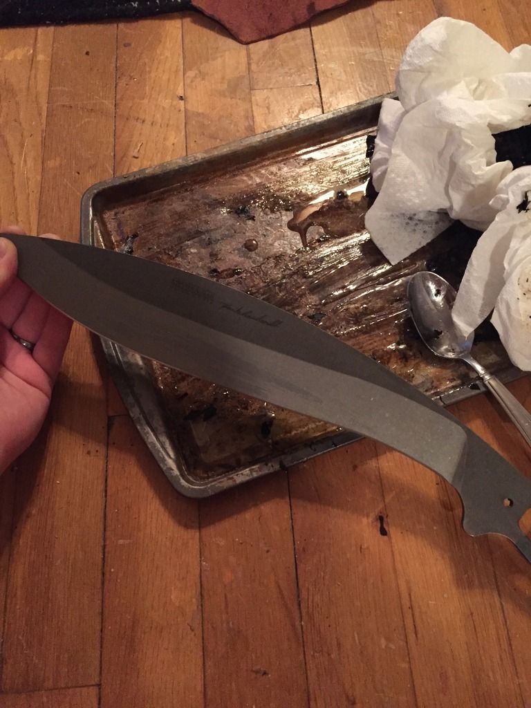

First etching the logos and Hank's signature.

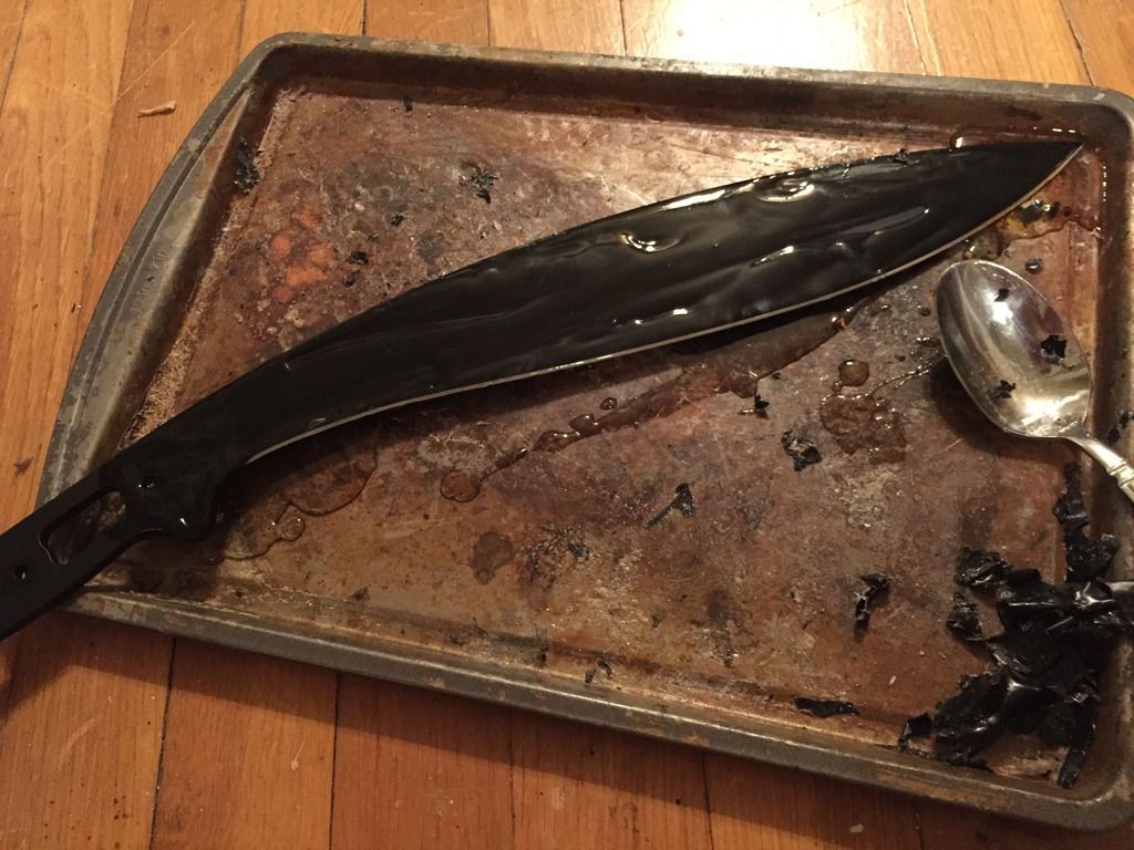

I know a lot of people here do the electro etch, but I'm not savvy enough for all that. I've been doing this gun blue and bleach etch for a while and it works great!

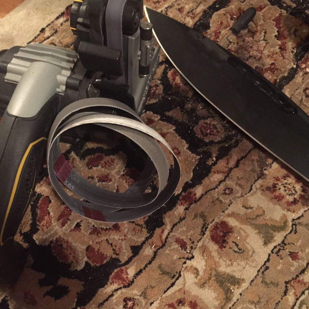

Using KO worksharp to put a nice convex edge on it.

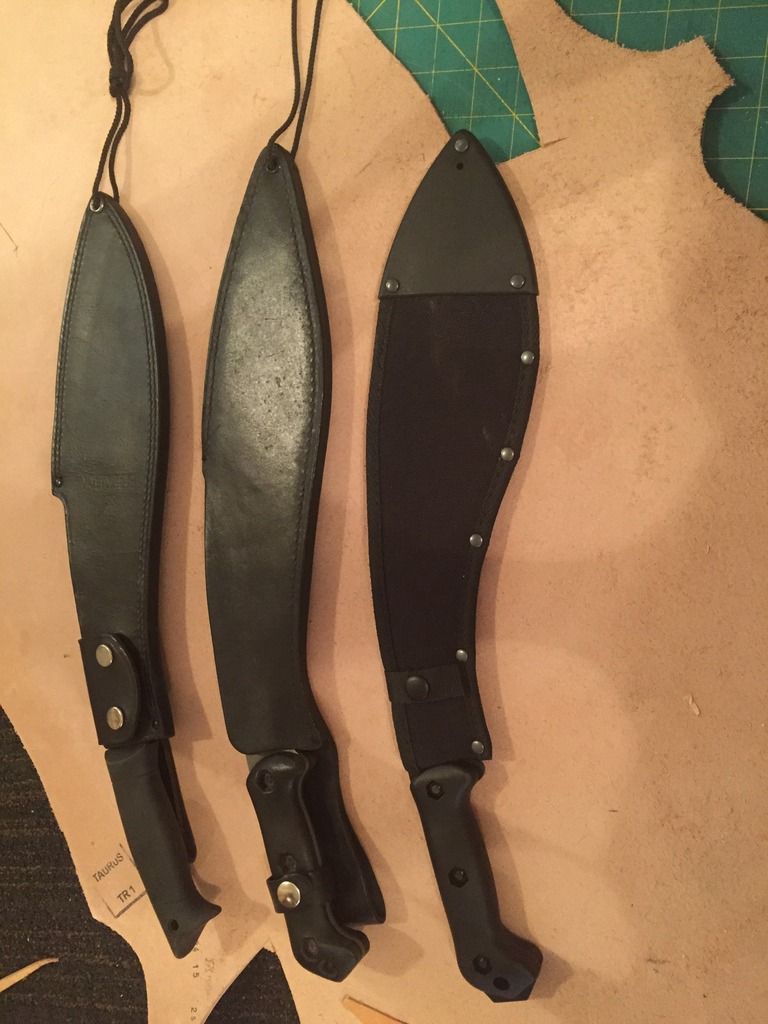

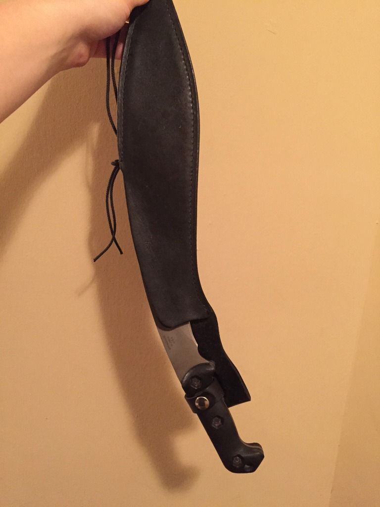

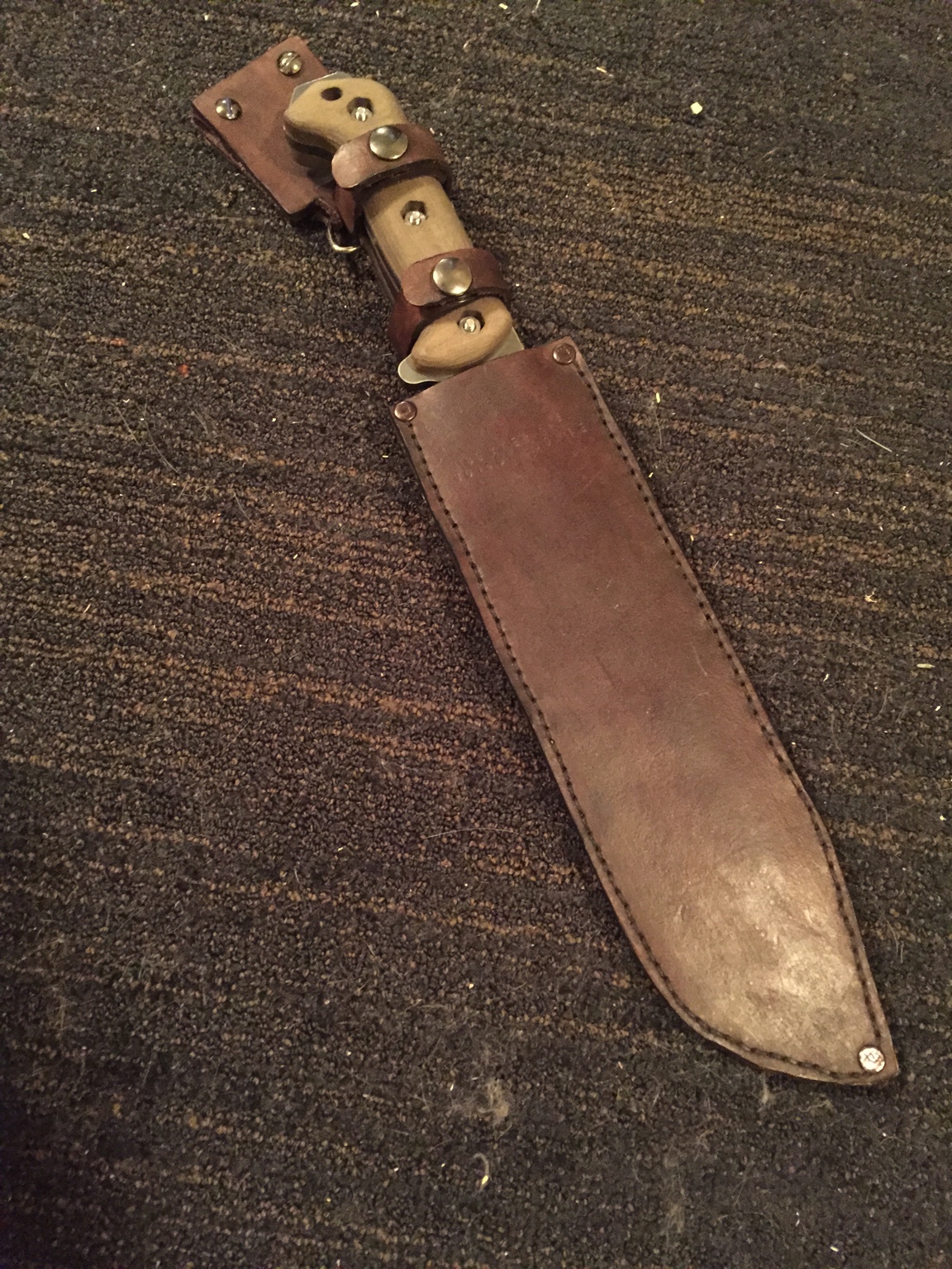

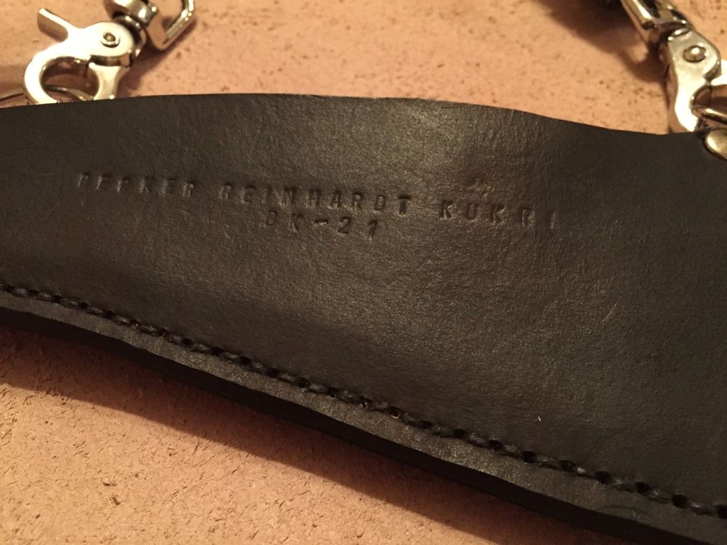

Here is the sheath I ended up with.
I worked super hard on the liner inside the sheath. So as of now there is no need for a strap over the spine, the retention is perfect. I made it slightly smaller than it needed to be so the only way to get the blade in was to completely stretch out the leather. I soaked the whole thing in water and stretched it out for about an hour. The retention is very much like an open-back kydex sheath, has to be lifted up first then it can be drawn back and out.
Here is a photo of the sheath upside down. The blade is locked in.
and here is a photo of the blackjack RBK. The button strap is so lose the blade falls out.
Now I know that with time and use the sheath its going to stretch out even more and it will one day need a spine strap. I also know it looks pretty crappy, but that's just because I am a crappy craftsmen, haha. As long as it works I'm happy.
I did mess up the measurements a bit. The top of the spine hangs out a bit.
Here you can see what it looks like when you have it on.

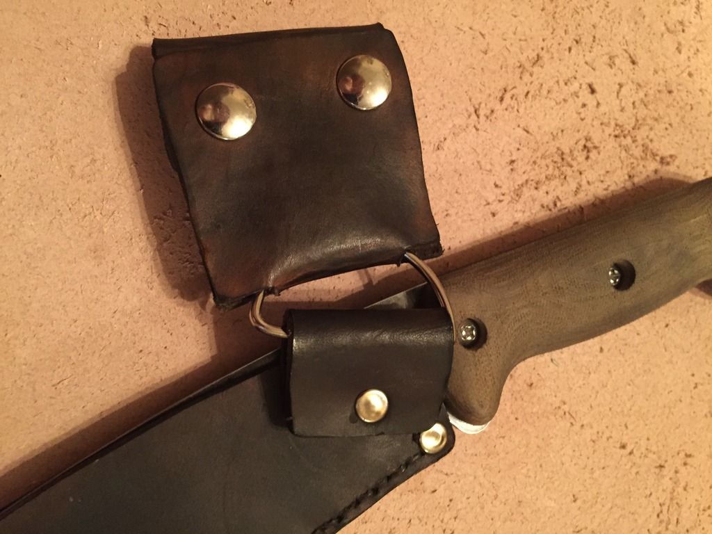

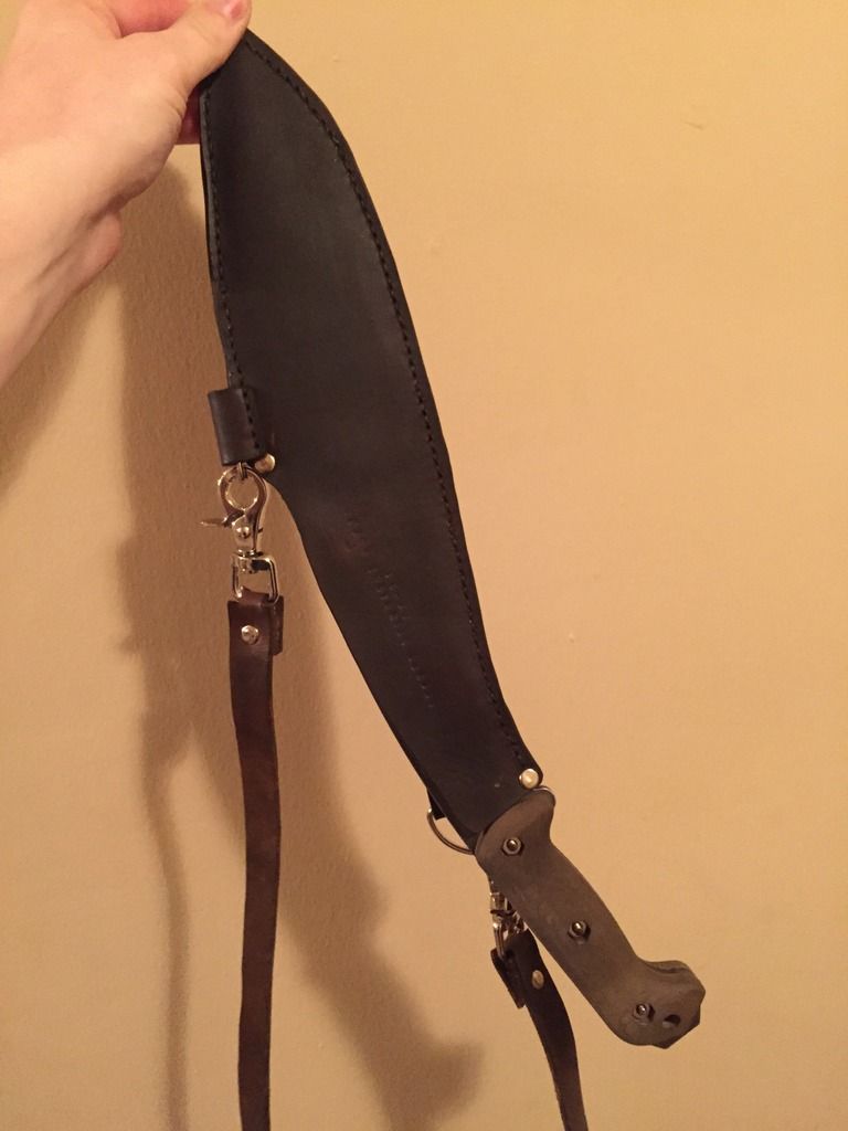

Another thing I wanted to do was to have an alternative way to carry it incase I had a pack on or what not. So the larger D-ring by the handle is on a pivot and I had some scrap leather that was already dyed to make a dangler out of. So even though I think it's too big for belt carry it's still an option with the detachable shoulder strap and dangler loop.
Stamped in the finishing touch.

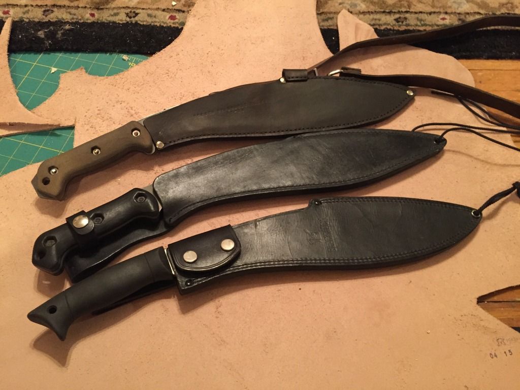

Last photo here. All of them tucked into their nice leather sheaths.

Do you mix the bluing and the bleach before you put them on the blade or put them one on top of the other on the blade?

One on top of the over. I put the blue on by its self for a little while and just make sure all the logos are super dark. Then I take a dropper and add about 4 drops of bleach per logo. Then let sit for a while. Hour or two.

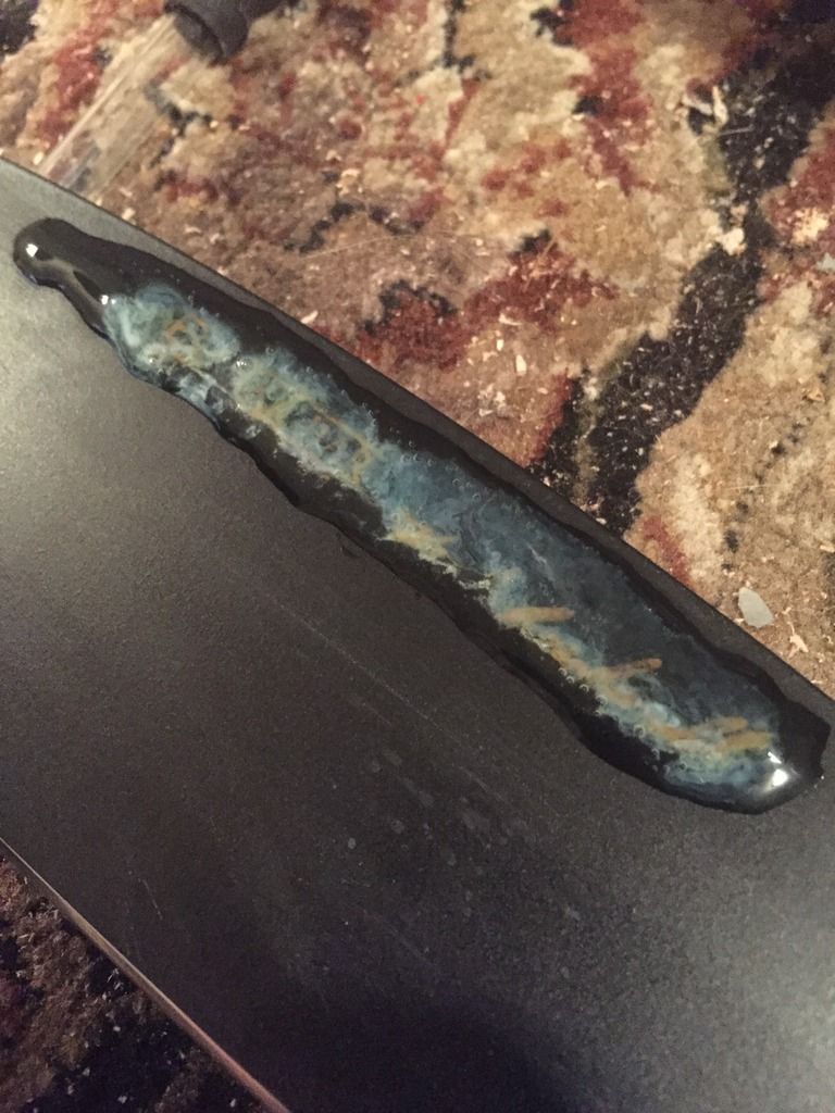

1) How deep did the etch end up? I've recently seen some other blue/bleach etches that are friggin sweet.
I'm looking at etching this and a 17 soon.

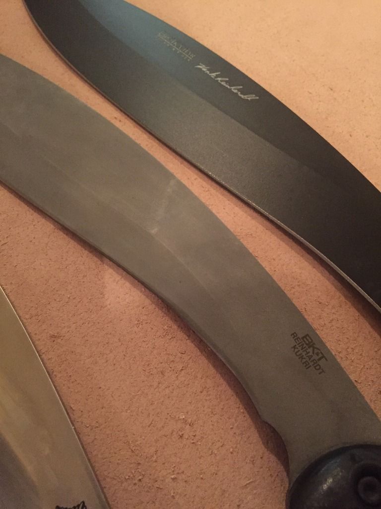

The etch is really all about how long you leave the chemicals on.
This one was left on for a about an hour each side
This one on the bk20 was left on for about 3 hours. It's doesn't feel any deeper, but it's clearer and darker.
This one on the 16 was only done for about 30 minuets (if that) it's pretty crappy. It's really faded and you can't even feel it sunk in. If I sanded it it would probably come right off as if it was never etched.
It's really hard to say how deep it really goes. To me it feels the as same running my finger over this bk15 that has the laser etch. Although the bk15 is probably a little deeper.
