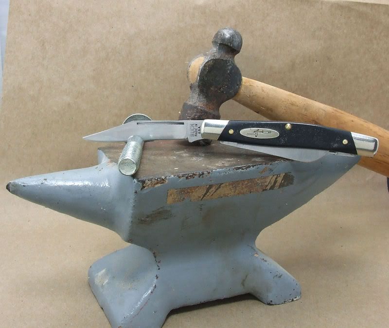

It would be interesting to see someone do a purposely underaustenitized HT to compare with a steel bolt chop.
Like this?
