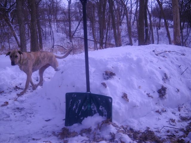

Pile your snow about hip high and flatten the top. You need to mix and agitate the snow so it bonds together.

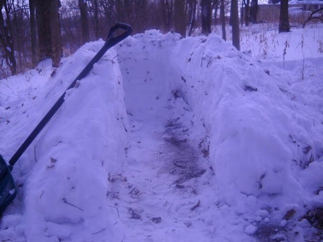

After about an hour or two of sitting, dig a trench down the middle.

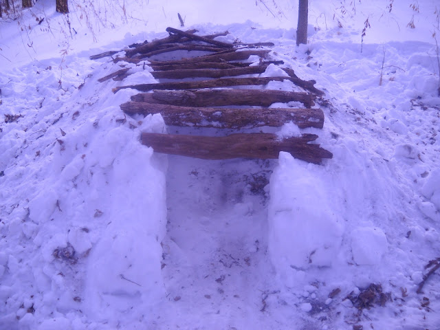

Place sticks across the top.

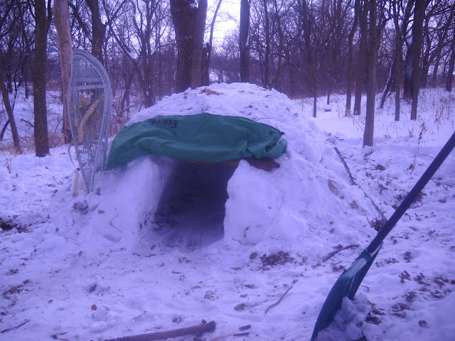

Put a tarp or plastic over the sticks. Cover it with about 12" of snow that you dug from the middle.

How does the dog handle sleeping in the snow? Is she a four-legged hot water bottle or is she really annoying to share a shelter with?

She is a wuss when it come to snow. I let her hang with me during the day, but she goes in at night.
