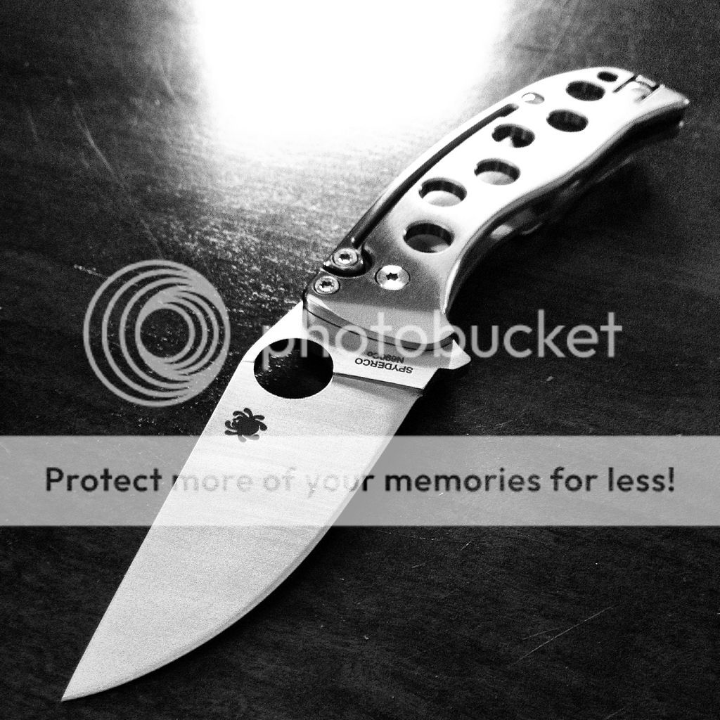

I own and LOVE the PITS. I recognized the careful design the first time I handled it. It seems so well thought out and balanced. I was not originally interested in a non locking knife, but this gets pocket time over many of my lockers now by simply exhibiting such high level of design. I applaud Spyderco for their adept execution of this collaboration. There is rarely a Spyderco that I don't respect, but there commonly are compromises that can come off as odd looking, even if in practice they are perfect (that's part of what I love about Spyderco, actually. They seem to favor function over form in the name of producing a knife that just works).
Hopefully this will spark more interest in this knife, as it has been a joy to own.
I'll add a few of my own pics to the thread.
