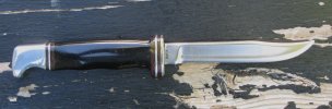

A 105 Pathfinder with micarta spacers this week circa 1969-1972. The time frame for this knife is bracketed by the change from bone hard fiber to micarta spacers in 1969 and the addition of the model number in 1972. A nice specimen with box I'm pleased to have in my collection
(last photo by seller)

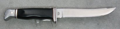

Buck 105 Pathfinder one-line (top & center) that my cousin bought from the MCX at Camp Lejeune NC on 28 June 1966. Bottom picture is my Buck 105 Pathfinder (four-spacer, three-line) that I bought from the Post Exchange at Aberdeen Proving Ground MD in the fall of 1976 (my box and packaging long, long gone).
