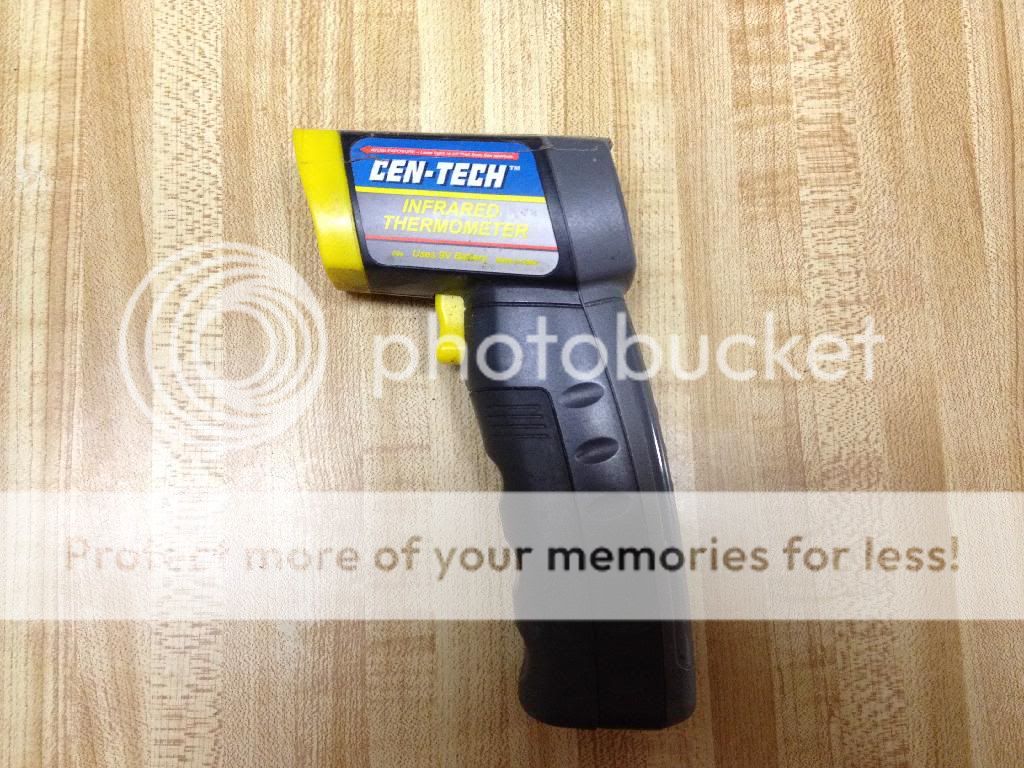

Laser thermometer - you need this, it is a lie detector!
Harbor Freight $20 - $38

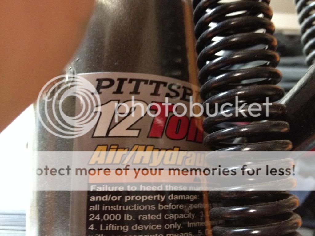

12 ton Hydraulic / Pneumatic jack - this is if you are going to be doing LOTS of sheaths, have physical limitation, or are really lazy.
Harbor Freight $80???

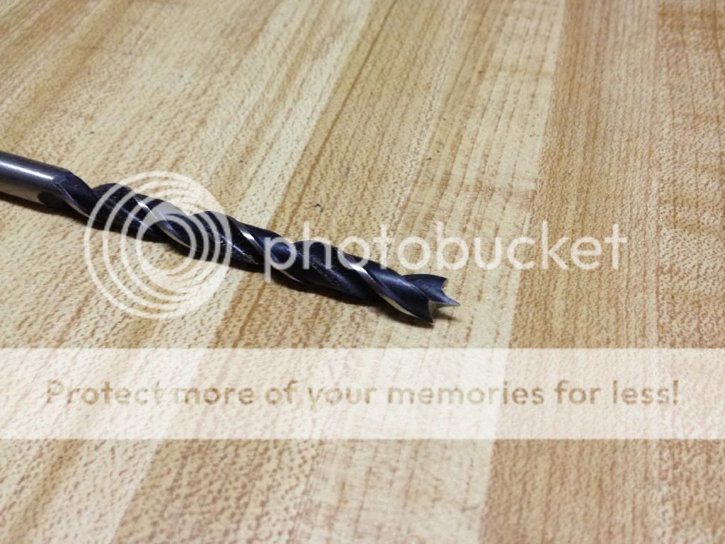

Kydex drill bits. Splurge on these
#6 & #8
Knifekits $9 each

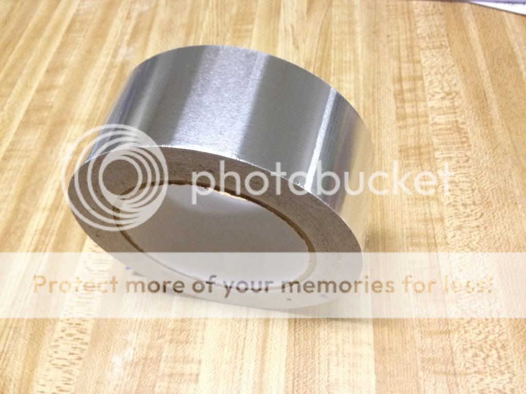

Metal/aluminum duct tape
Lowe's or Home Depot guessing $12 for the wide stuff (FBM/NMFSH) and I think I got the bottom roll at WalMart for $8 to handle most everything else.

The third layer I use is an aluminum duct tape. You can use a clear packing tape if you can't find the metal tape. You will get better results with the metal tape, so make the effort to find it. You will see both ways in the pictures below. The reason for this layer is to make a smoother impression in the thermoform. Think about a playground slide, smooth = a fun ride! Now think about a slide made out of tactical texture thermoform = OUCH!!! This is a ride your blade is going to be taking often. Be kind to your knife!
After the tape layers are all in place, I like to hit it with the heat gun for a second to soften the adhesive a little. Then I put it in the press just like I was making a sheath, and let it sit for a few minutes. This should give you a beautifully smooth surface to work from.
Not as necessary with the clear packing tape, as it's clear, but I wiggle the aluminum tape back and forth along the cutting edge so I get a very defined line. I mostly use scissors to cut the knife out, sometimes I have to use a razor knife. Cut as close to the line as you can. BE VERY CAREFUL NOT TO NICK THE EDGE!!! After you have it cutout, now is the time to use your fingers and rub it all down making sure everything is nice and smooth.
