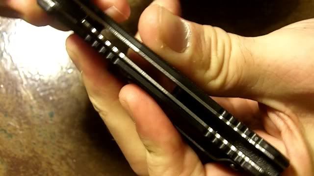

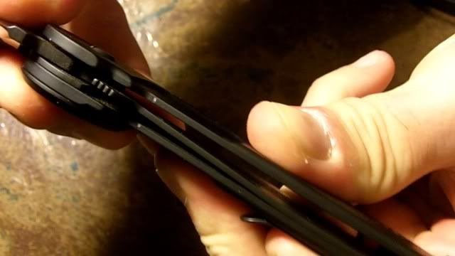

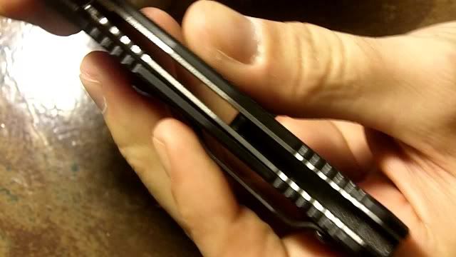

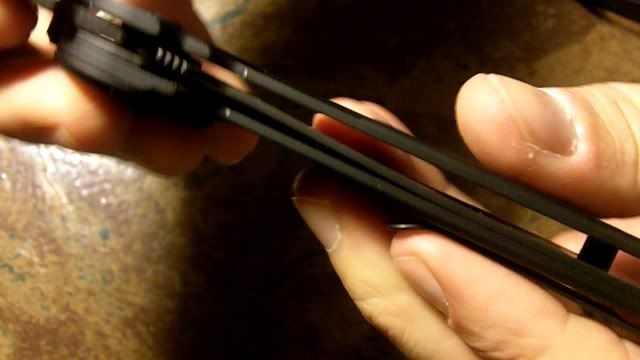

after getting my first Emerson (mini cqc15), im kind of puzzled by its construction. i understand that they were once made with Ti liners on both sides but later switched to only one (the locking) side. i can see the need to for costs sake and such but now that i have one in hand and can examine it...
wouldnt it have been better if they just used a decent steel in both sides and dropped the Ti altogether? i know some think its a wonder material but the Ti flexes if i put pressure on the backside of the blade where my other knives with steel liners dont even flinch.
im not trying to knock Emerson as i like the knife but when compared to my Extrema Ratio BF2 (and even my BF1) the Emerson just seems weak.
here is a couple pics of each- 1st slack and then under pressure.
hopefully you can see what im talking about as it was tough to get these shots no handed.
as i stated earlier im not trying to slam Emerson, just maybe help improve the product unless im just mistaken in my observation. would the knife be a better product with steel liners vs titanium? seems like it would last longer and be stronger to boot. i dont see the weight savings of 1 ti liner being that significant.
as a former soldier, if i were deploying i would honestly have to pass on my Emerson and take something else from my collection into a combat environment, it just doesnt inspire confidence.
or am i just completely mistaken in my observation?
